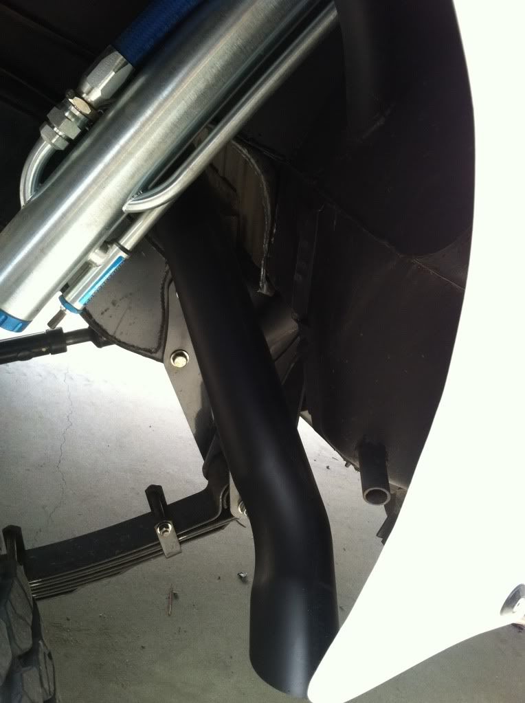

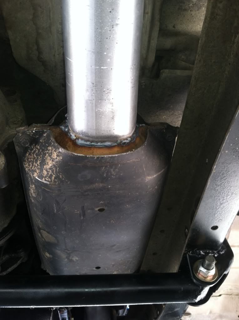

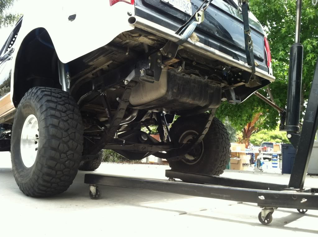

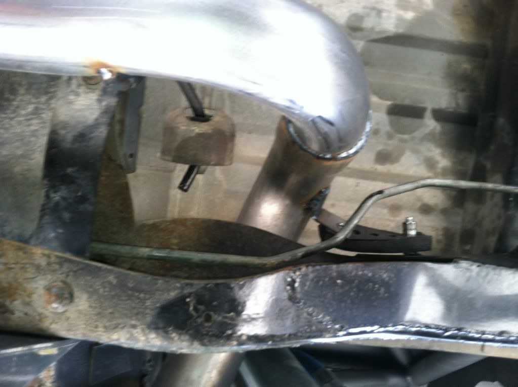

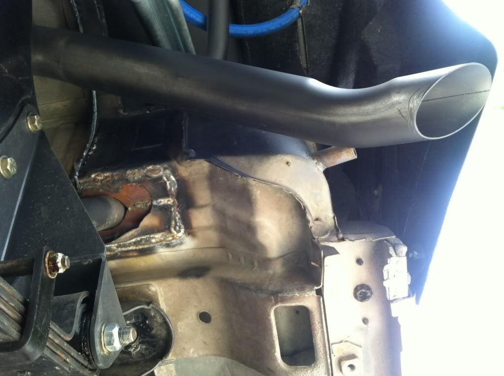

So after ruining a set of limit straps I knew I wanted to change the exhaust so kick out the side. I was debating either buying some bends and cutting them up to do it myself or taking it to a shop. RPM to the rescue. They did it for me for less than the bends i was gonna buy! not only did the bend up the pipe but the opened my cat up, from 2.25" to 3", and did all new hangers. All in a couple hours. Stellar service. CHeck it out...
I am gonna wrap from where it comes over the frame to the tip cause it gets a few inches away from the shock at full droop. Tooks some droop picks when I was checking clearances.

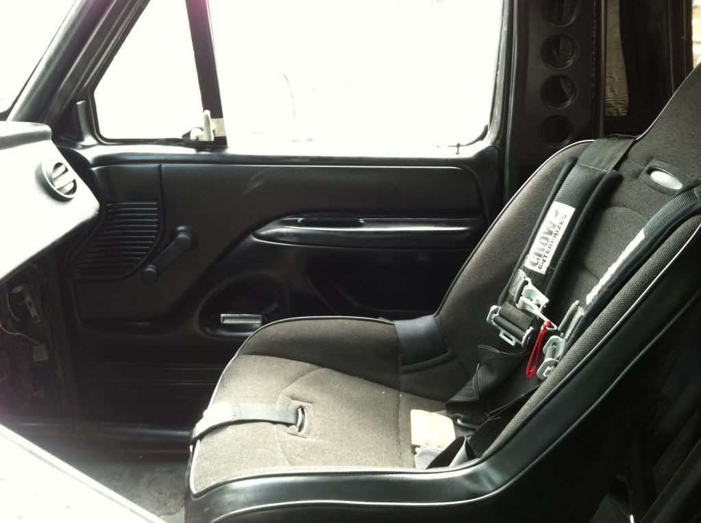

I also got the manual window regulator in and door panels done.
