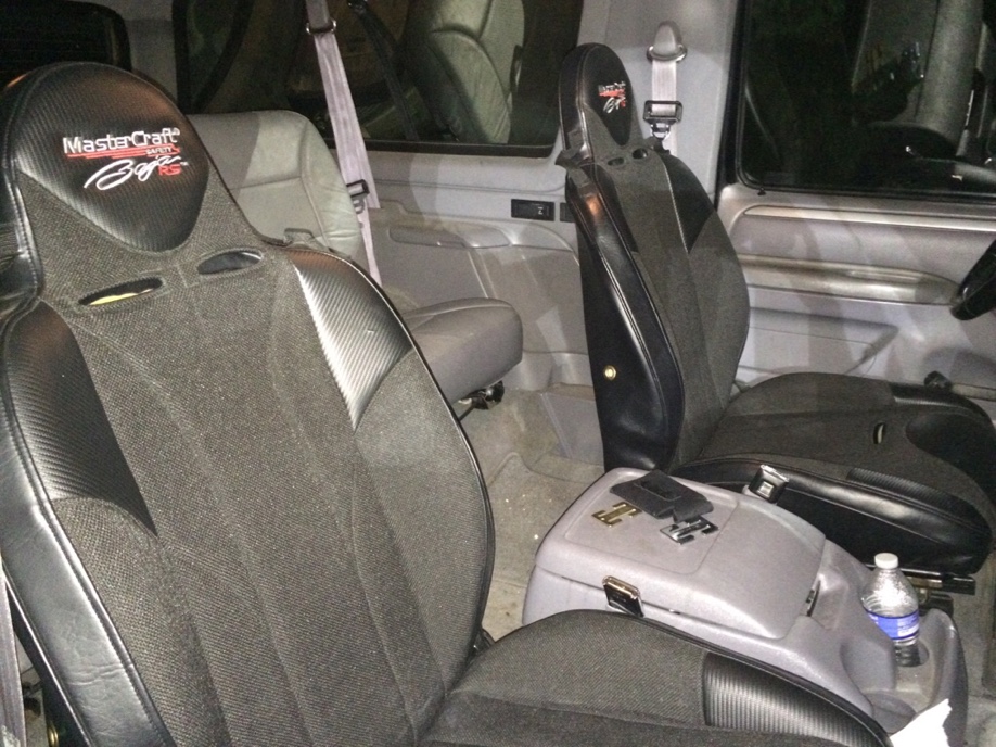

Well got the seats Jon, awesome and super comfortable! Gonna call Mastercraft tomorrow to see how much it would be to freshen the driver side and add lumbar.

Well Mastercraft moved to Indiana. Now a $100/seat tune up is now $300 Ish with shipping. I'm really ticked about that.
I need the seat cords tightened for the driver seat. Anyone know how to do that?

Seats lookin' good in there! Bummer about the cost of a tune up! I bet its not tough to just tighten them up a bit, but really they seemed comfy and good to me so i'm surprised you want to mess with them.

They are comfy. Only things are I usually need lumbar and the foam for the driver seat bottom outside bolster could be replaced. Sitting in both you can tell the passenger is definitely tighter for obvious reasons. Just wanted it freshened up.
