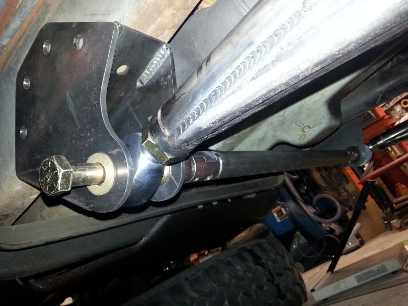

I built these to go through mine

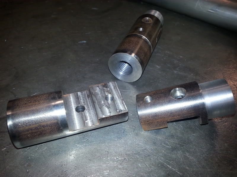

Who can guess where these are gonna go?Image
Steering links. Haha!
Kel Fab Creations wrote:Who can guess where these are gonna go?
TELL ME NOW! I can't figure out why a bolt together joint appears to be threaded internally to be bolted in... It's like some sort of crazy double removable redundancy for when one bolt strips out?
Are you going to thread the body mount bolts in to those in the cab and use them to make a removable cage? Wild guess!
But seriously what are they for?!
Have you done a rear shock mount yet? If not - that's my guess for the double removable tube mount things. I was going to say they were part of the engine cage, and you didn't like your original setup, but I couldn't see the benefit or change they would add so I dropped that.
Either way - I'm interested to see how you use them.

Keep guessing! This is fun. :lol:
Detachable snow cone maker

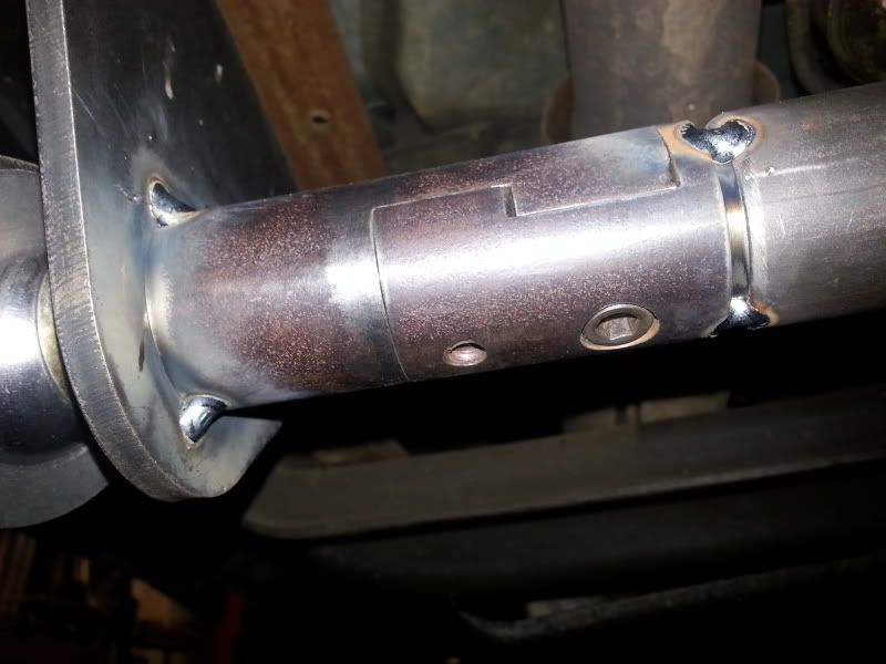

Alright. I'm done messing with you guys. Here it is in all it's glory. lol.
Posts: 6142
I like it. I recommend some sort of lock for the bolt? I'd consider drilling the threaded portion of the bung/coupler and bolt to use a cotter pin.

For sure. Gonna put a dab of locktite on the threads as well as a lock washer.

SteveG wrote:I like it. I recommend some sort of lock for the bolt? I'd consider drilling the threaded portion of the bung/coupler and bolt to use a cotter pin.
That was weird. It didn't show your second sentence till after I responded. Cotter pin is a good idea but I think lock washer and locktite should be fine. After all, thats all that holds the rad arms to the beams right?

Cool design, buff. Only down side I see is the inability to shank out the bolt. Maybe if its an option on design version 2.0 you can get the threads recessed a bit so bolt shank can pass through both sides.
