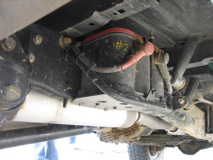

Forgot about 4 link, and I guess you can just drop them down below the body at that point. Pretty willing to bet the guys asking to see the pics don't have links and may not be going there though...
That being said - here's how they were done on the Baja F-250. This is under the cab
1 081.jpg (78.31 KiB) Viewed 28522 times
Re: Stretched GFB by Rugged-Wilson is back!
*Edit* - Baja F250 ones are under the BED, not cab. They are up close to the cab though. There is more room up there (in front of the front spring hanger that is) since that truck is a long bed.

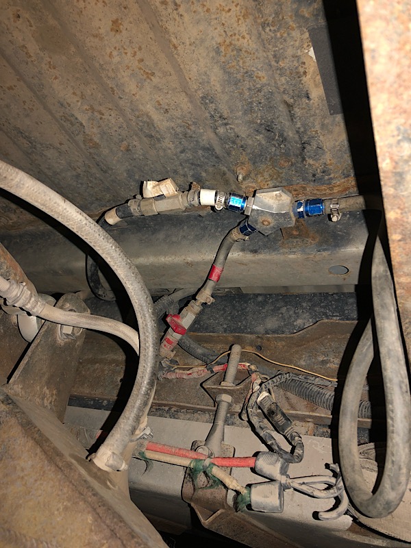

So one of the items on my list was to add a secondary fuel pump that could be [relatively] easily switched to in the event of a fuel pump failure. The plan was simple. Mount it in-line along the fuel hose where it could easily be spliced in if needed. Well, Bondobob and/or Paul probably told me the following a while ago but I probably forgot.
Wilson has two fuel pumps in the tank (that sound you hear is angels singing). The setup is fantastic. Both are fully functioning, plumbed and and ready to roll. Fuel hoses from each pump meet up in a Y-block. In each hose, before the Y-block is a ball valve. One valve must remain open, the other closed. Power connectors for each are also present near the Y-block. One connected, one waiting for it’s turn.
When one fuel pump fails, you close one valve, open the other, swap the connector from one fuel pump to the other and done. It took me about 30 seconds. Freakin’ glorious!
I get to cross one time-consuming project off the list... couldn’t be happier! Instead, I’ll spend a few minutes checking all the fuel lines, adding zip-ties and abrasion protection as needed and swap the connectors to Deutsch simply because I like and have a good stock of them.

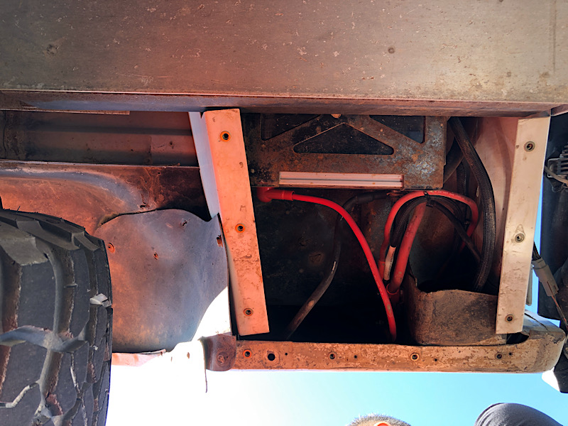

Here’s a long overdue photo of the battery relocation. Wilson has two batteries. One in each rear corner.
There are heavy duty, positive battery cables connecting both rear batteries, up the left side and across the engine bay... probably 20 feet of it. If any part of the cable is damaged and shorted to the chassis or body... no bueno! So, we installed 100 Amp Mega fuses at each battery so there’s only short jumpers to the fuses that are not protected... I’ll sleep better now. Ha!
Good call! My uncle learned the mega fuse deal the hard way unfortunately! Had a just finished project car (Renault r5 turbo with a nissan transplant in it) catch fire on a test drive. He made sure to show me and have me learn from his mistake. I was doing the battery move in the alfa at that time and it got a short jumper to megafuse too.
ChaseTruck754 wrote:Good call! My uncle learned the mega fuse deal the hard way unfortunately! Had a just finished project car (Renault r5 turbo with a nissan transplant in it) catch fire on a test drive. He made sure to show me and have me learn from his mistake. I was doing the battery move in the alfa at that time and it got a short jumper to megafuse too.
Yeah, all that live power cable make me uneasy even just parking it in the yard. There's a 1/0 positive cable running across the back of the car, connecting both batteries... right behind 32 gallons of fuel. If it ever got tagged from the back, it could make for a good show and sad day.
