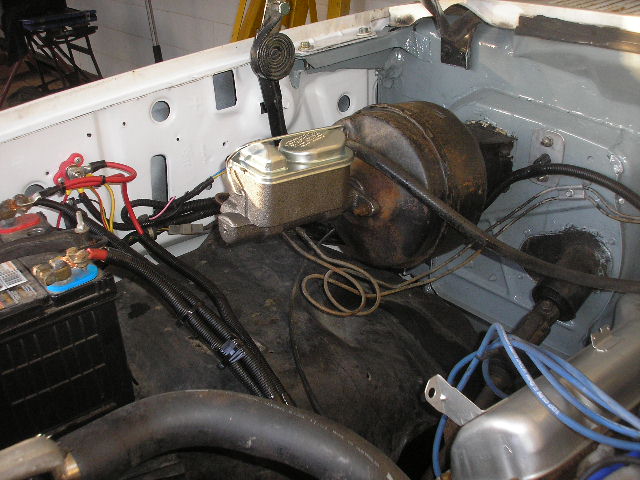

Built a harness to run the propane AND gasoline (if Mick decides to go back to dual fuel) with new relays, wiring and corrugated jacket. Made a mount similar to the one on my truck to hold the propane convertor and re-plumbed slightly to make it work. Added P clips to brake lines and propane hoses to make everything secure (and legal) and did some serious re-wiring of the engine and body harness to tidy up the shit nest I started with. Most of the fittings, hoses, etc. came straight off my truck (I'll make replacements later as required) to save time and keep things tidy. The power steer pump had new O rings fitted to the pressure fitting and now it's bone dry.

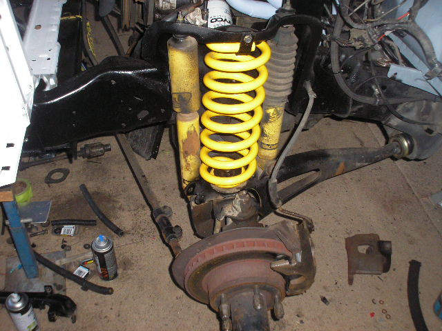

New King +1" springs in place:

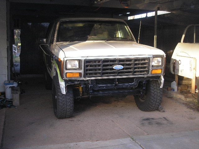

Front re-assembled, ready for the filler panel and bumper:

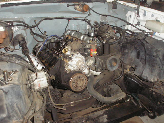

A few engine bay shots:
I'm currently in the process of repairing the Y pipe, it will get welded up at work tomorrow, and I've ordered a muffler and some straight pipe, so I can build the connector and tailpipe to complete the exhaust. Once that is doen, I will attack the auto and rear diff. The auto needs some O rings in the shift levers and kick-down spindle to stop leaks, the dipstick tube will be replaced with a TCI replacement and it will have a filter change while I have the pan off. The T-case lever(s) need a slight bend to clear both the exhaust and the shifter cable. The 9" will get a new pumpkin gasket and axle bearings, and the brakes checked, bled and cleaned up. Oh yeah, the master cylinder took a major dump when we tried to bleed the "new" calipers, so a new one was ordered and fitted. Once the Y pipe is back on tomorrow, along with the old muffler (temporary), I'll start putting the dash back together and finish tidying up all the loose wiring, etc.

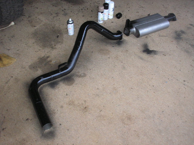

New 3" Flowmaster and 3" mandrel tailpipe, ready to install.
Made it exit out the side right behind the mudflap, to keep fumes out.
