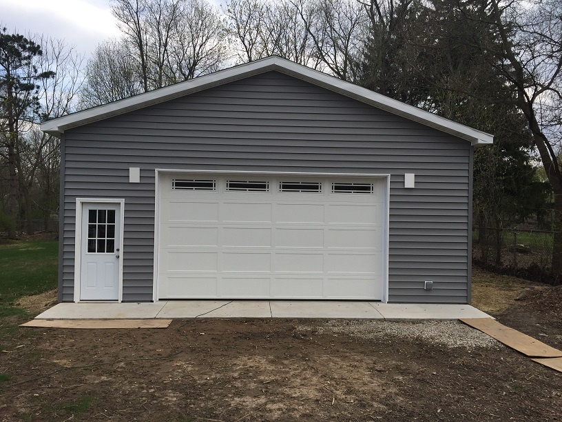

Not much progress on the Bronco. I did get some matching 4.56 gears for the 9" and I got a sweet deal on a PowerMaster XS starter. I've also been working on the garage quite a bit. I just finished up installing siding on 2 sides. I should have the rest done in a week or two and then it's back on the conduit. Hopefully in a month i'll have the final inspection done and then it's go time on the Bronco. I'm also looking into getting a Polaris Ranger 800XP from a buddy of mine. We have a dunes trip the end of June and there's no way the bronco will be ready.

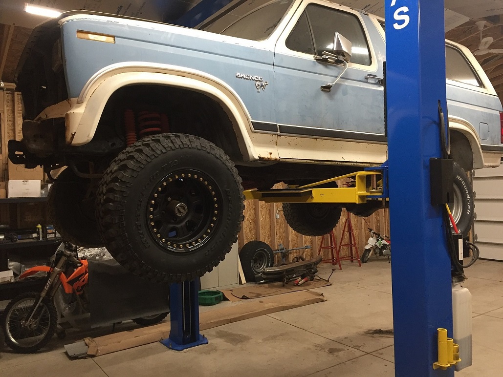

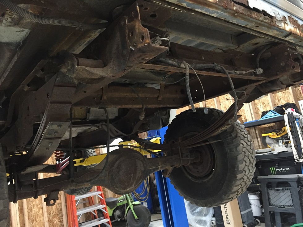

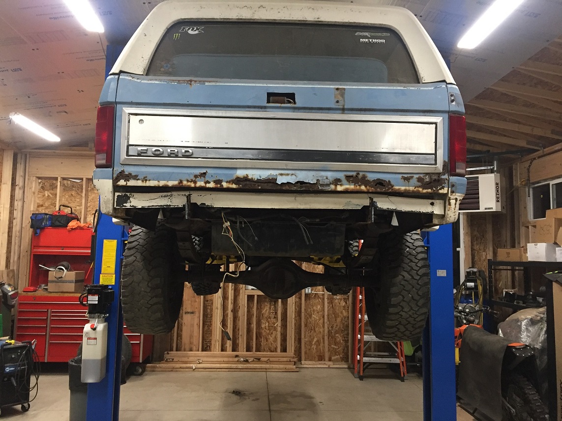

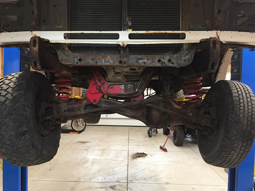

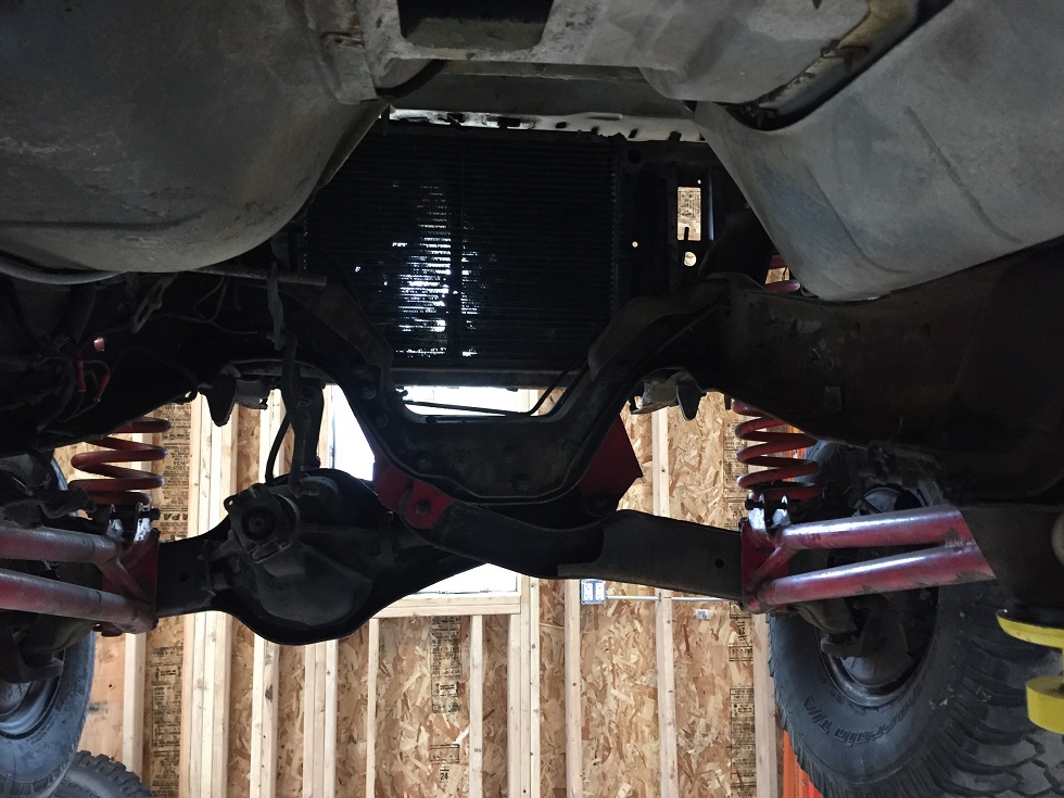

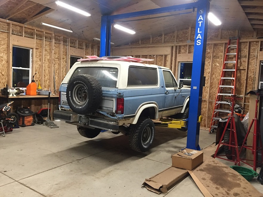

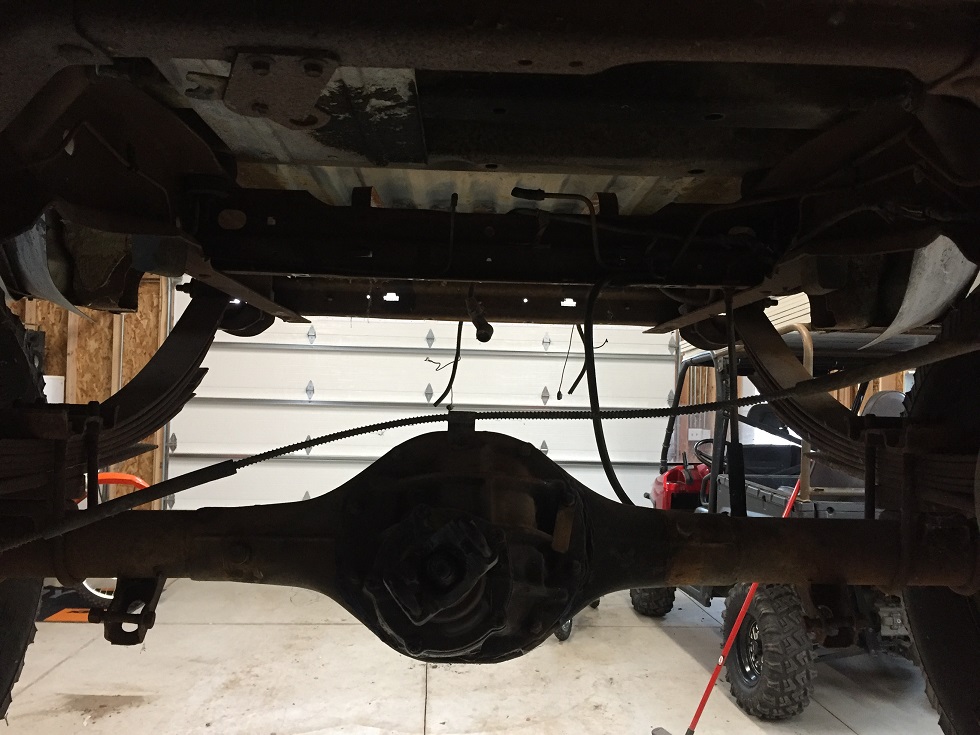

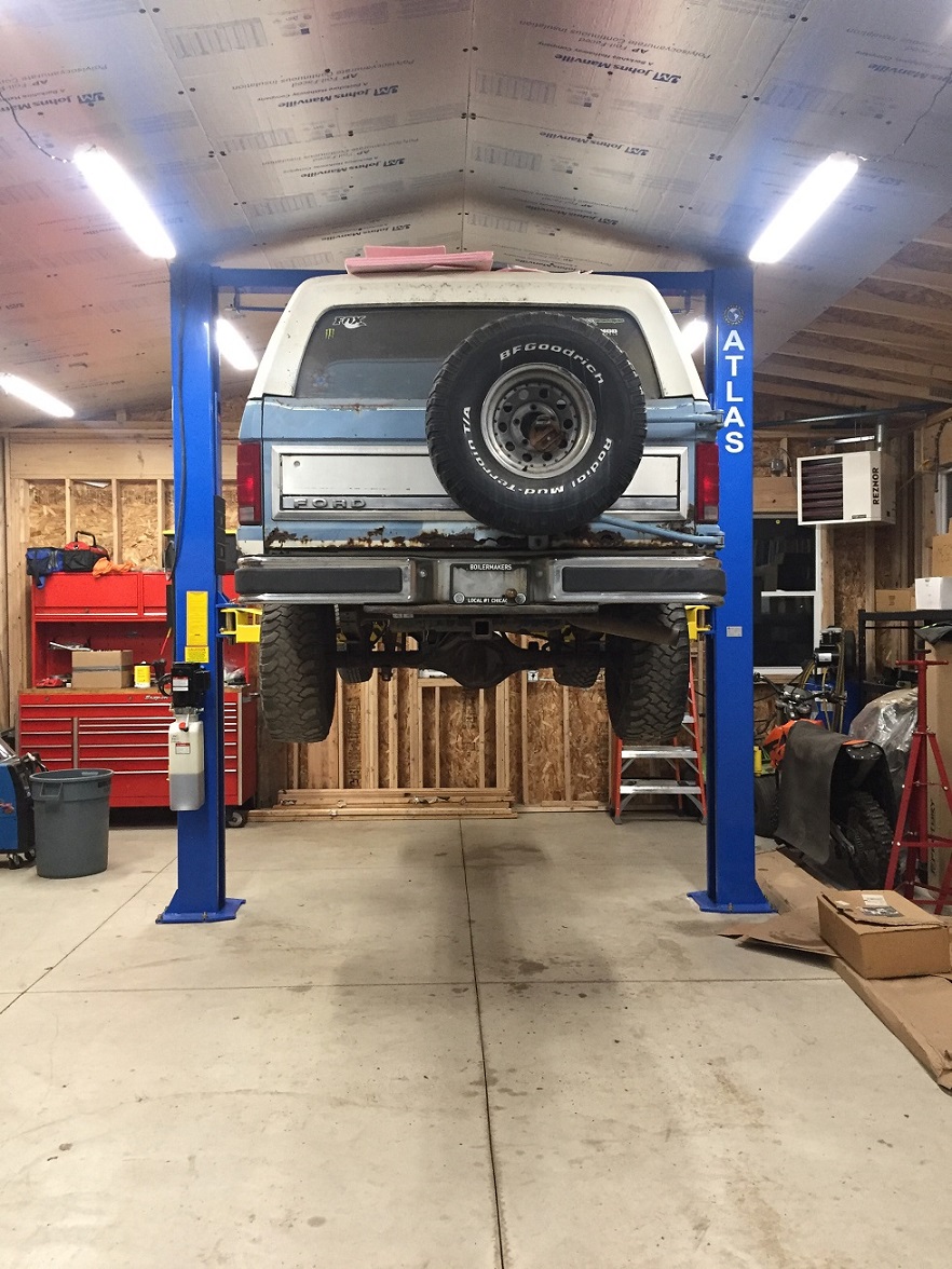

Well....... FINALLY back on the Bronco. It's been a long time coming with moving, building a garage, saving for a lift and installing it, etc. BUT I was able to get working on it this weekend. I removed a TON of weight mostly getting it ready to box the frame rails. So far I removed all 6 shocks, front inner wheel wells, both swaybars, both bumpers, rear tire carrier, and the gas tank which is full of 10-15 year old gas. It still smells good and is clear which surprises me a lot. I ordered a Thermal Dynamics plasma cutter to make cutting out the frame plates much easier. It should be here this week. I also removed one of the front core support body mounts to test fit the aluhttp://www.gofastbroncos.com/forum/download/fi ... 21786minum solid mounts I bought. I have to buy some new hardware so I can get them all installed.
