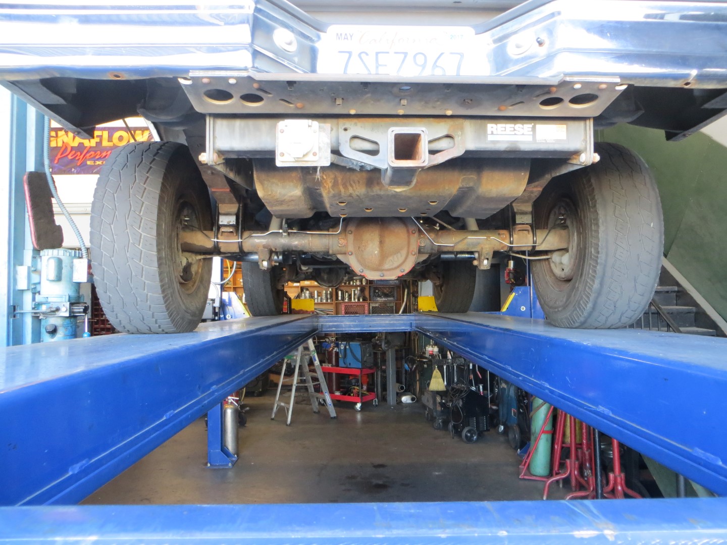

Still working on the shocks and bumpers while getting ready to put Mom & Dad's Thanksgiving Bronco on the road. We cleaned up the thingy with new brake lines and vent fittings/hoses, flushed the brake system, new front rotors & pads, misc other tidbits to clean up the unserviceable stuff. I see the 'ol 8.8 is going to need some love.....it's pretty loose and a little weepy. No 9" here but I may extract it for Giant truss, check it for straight, rebuild it with 4.11 and see if there's a bolt-on F150 style disc setup to use OE Ford parts and a parking brake.

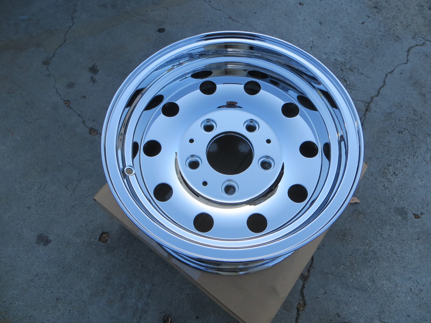

......and just now I got a call that we're done at the alignment shop with new shoes.

Re: Mom & Dad's Thanksgiving Bronco
Thanks for the comments and help guys. Think I'm going to consider a budget for a pretty stiff rehab on the 8.8, and would appreciate feedback as applicable. Please remember this is Mom & Dad's Thanksgiving Bronco aka Jim's DD until then. Good road manners are a must. GoFast in the dirt is as much as Mom & Dad will go.....nothing like any of us would do, so we're trying to keep it basic but strong in rebuild or OE-style upgraded parts. Prime resale is key, so most things OE will remain that way except necessary GFB things like minor (and bolt-on) suspension, tires and other necessities. I already hate the OE rear springs and crappy Rough Country pogo stick "Nitro" shocks, but these pieces have to live for a bit. How I may consider dropping the 8.8 out for rehab:1Hondalover wrote:I see the 'ol 8.8 is going to need some love.....it's pretty loose and a little weepy.
* Disconnect it, drop it and strip it. Make sure all housing components outer and inner are good and to spec.
* Have Giant install their backside truss, then straighten.
* Paint or powder coat it.
* All new seals, bearings and etc.
* New 4.11 gears with stronger carrier/LS.
* Reuse 31 spline axles as long as they're not worn down at the outer bearing. Slightly upgraded axles if need new.....1/2" studs to remain.
* Economical OE Ford disc conversion using only OE Ford parts but no re-drilled rotors. Rear disc only for cool, resale and a bit more safety since C-clip exists.
I get the truss is a little out of character here, but it will insure no future issues for the "normal" off roader. Seems like such investment for an old 8.8 is a bit much, like I should maybe find a newer used 8.8 with OE discs, regear it and bolt it up? Is there such a thing out of an F150 or are they all wider? 9" and any other swap is out of the question. In whatever form, I'd like to have a single shop or at least as few possible stops at multiple locations to complete this. What really sucks is that we're up here and everyone else is somewhere well south of here.
Does anyone know if Geoff/Giant is capable of straightening a housing and setting up a R&P? What about Bobby/Solo? This industry is too full of "we can do it no problem/we do it all the time" skidmarks. The time & money it cost us in Baja when the 9 loosened up will never happen again. I'd like to do it right and once, but this is not a trophy truck budget. Another fine line.....
Thoughts?

The only problem I've had with a stock 8.8 is the inner pinion bearing going out and puking fluid out. Still drove home 100 miles and no damage. I think it was messed up when I bought it and lasted another 4 years. I've seen the axle tube bend out of the center but I think they were jumping their bronco. I've done 40-50 through good size woops, light jumping, and other floggings. The 8.8 that's under it now has held up with no issues. Ruffstuff makes a nice heavy duty truss you can easily and cheaply put on.
- Posts: 969
I have had 8.8 issues on broncos and explorers in the past. They separate where the tube presses into casting. We have welded and got a little more life out of them. As Bobby told me he has seen some live for years of abuse and others break soon as they hit dirt. If you can find a decent junk yard 9" it will cost the same to rebuild either the 8.8 or 9" maybe a little cheaper on the 9". Solo can re gear. For straightening I use Bob Myers down in El cajon I know it would be a drive but he is good. I know of a guy that has a stock bronco 9" from mid 80s if you want I can see if he wants to sell. He lives u please by you as well I believe.
