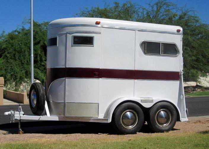

I just painted my wife's horse trailer with a rattle can. 20 cans of Rust O leum Gloss white and two cans of torredor red for the stripe. I felt it came out pretty well,
it is a solid 10 foot paint job.

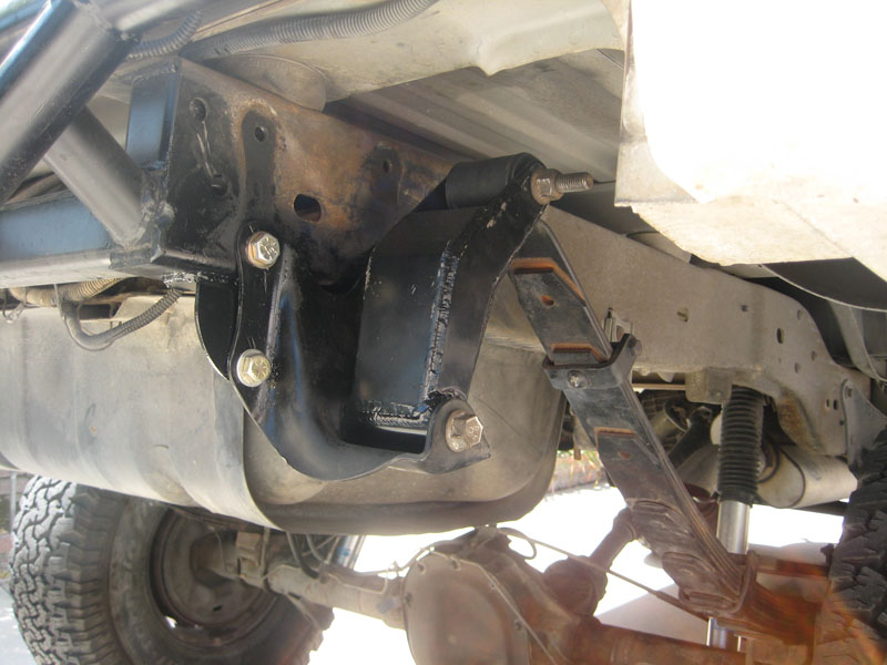

Im picking up a set of f53's this weekend from Tony tcm_glx. I also got a set of solo's extended shackles which also adapt to the narrower 2.5 spring. Just need to make the .25 adapters and im good to go!

When I picked up my shackles the guys over there gave me some nice machined spacers. May want to check with them on this.

Post by Rwies »
Tony, it was nice meeting you as well...your bronco is sweet! The install went good however I got the wrong shackles so solo is making me a new set as we speak. I was able to finish it though using the factory shackles and some spacers and wow what a difference! Seams to be stink bugging a bit though, the rear is about 2" higher then the front...Im hooping a full tank of gas might help. Ill post some pictures once i get the shackles on

The shackles may bring it down a little also.

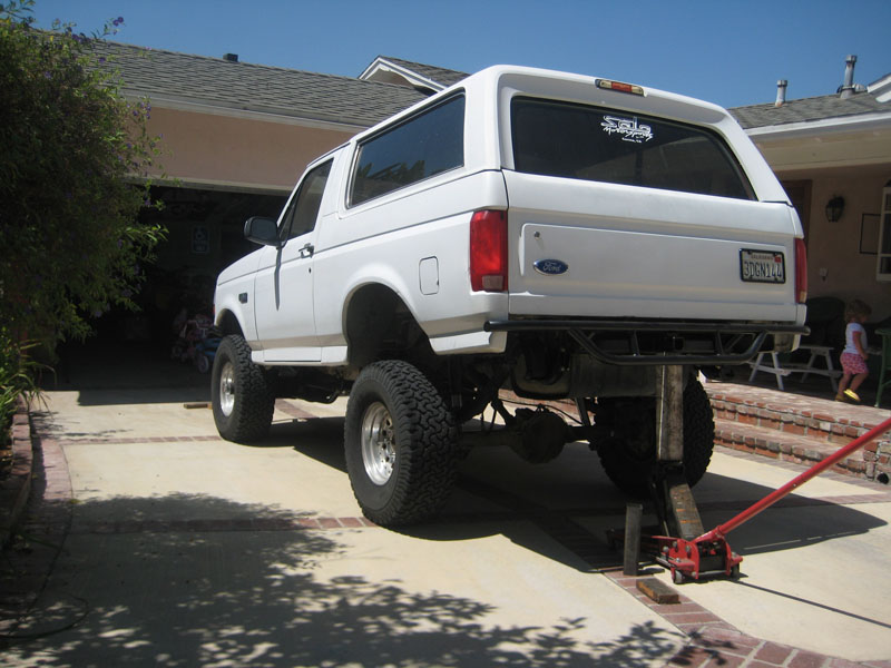

Heres a few update pics

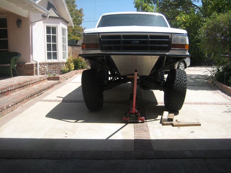

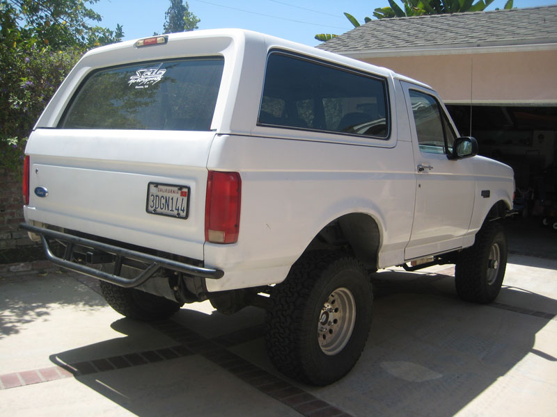

And a few more pictures!
Big thanks to the guys at Solo Motorsports, great service and extremley knowledgable. This was my first bronco/TTB build and these guys really took the time to explain everything to me!
Tony thanks again for the springs. I gotta go meet up with you guys one of these days!

Lookin really good Randy!! Glad she is coming together.
Re: Randy's 93
Wow, that's a lot of droop. Does the driveshaft bind at droop?

philofab wrote:Wow, that's a lot of droop. Does the driveshaft bind at droop?
I havent checked to see if it binds yet but I will! Heres the thing, Im temporarily running these 5100's until I can save some $$ for the 12" king tripples I want. Im pretty much just driving around the streets until then so i figured whats the point in mono leafing the rear, cycling it, and strapping it if im just going to do it again in a month or two.
Re: Randy's 93
Should be ok.
This was taken today at full droop, no bind at all. Keifer did set my pinion angle for me.
