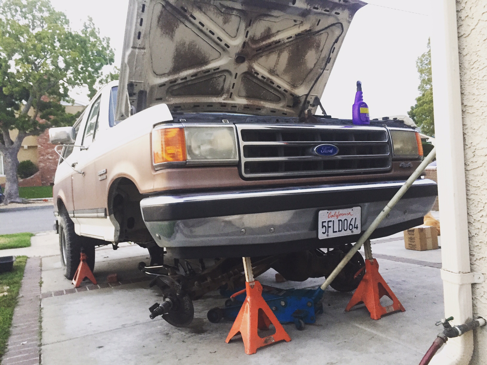

I've been home from Chicago for about a month, but in between then and now I had a graduation to attend, I got engaged, and tons of other stuff that got left on the backburner while I was gone got done and this weekend I FINALLY got some time to start tearing this thing apart.
IMG_6658 (1).JPG (701.16 KiB) Viewed 3405 times
Initially I was planning on going straight to coilovers and a full kit from Solo on everything, but now with a wedding to pay for and it being hard enough to carve out time to even work on this thing, I decided to just get a cheapo superlifts 4" kit with the radius arms and run that so I can get back out on dirt. Plan is to run that in the front with the deavers I scored from Chris (thanks again for the smoking deal) and then throw some 5100s underneath when I blow out the superlift shocks that came with it, which im assuming will be sooner than later, but time will tell.
the brakes pulsated horribly and I figured I just had a warped rotor, I had no idea these trucks came with phenolic pistons, until this I always thought they used them on small passenger cars.
So new calipers were in order, and since I was doing that and the brake lines didn't look too sweet, I went ahead and ordered some extended braided lines. 1 rotor was beyond saving, so I went ahead and ordered a new one and in the mean time decided I might as well take the time to order some Warn Premiums since I was doing new seals and bearings too.

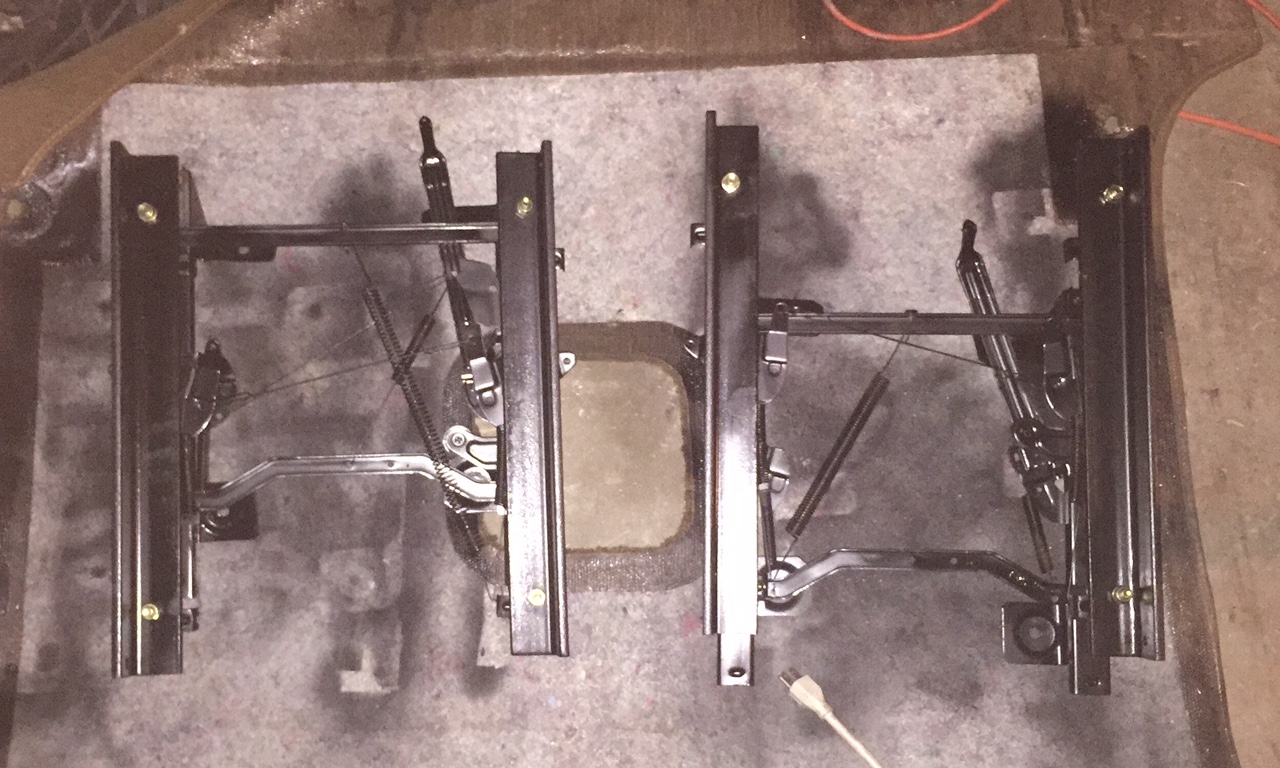

finally got the seat brackets all done up and mounted. gonna try mounting them in the truck tonight when I get home from work.
big thanks to everyone that helped me with the whole angle iron idea, it was super simple and easy to do. 3/8" was massive overkill, but I had some laying around so the price was right.

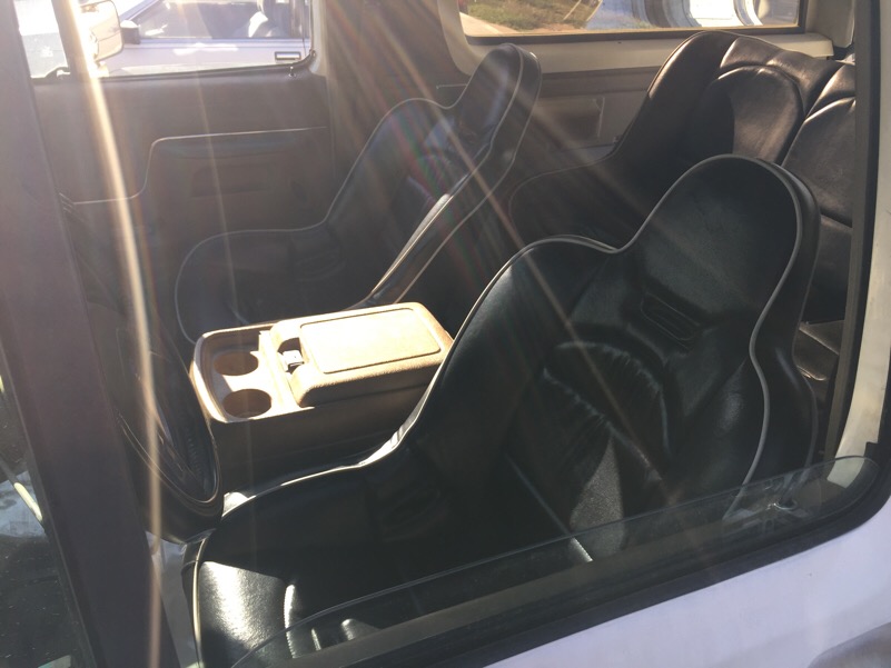

Front seats are in!
