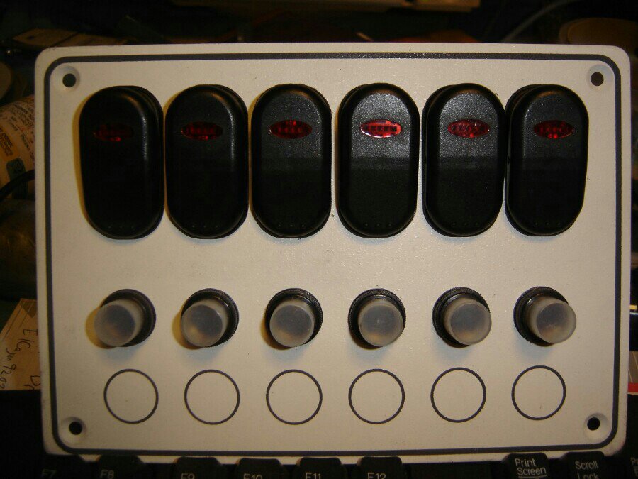

For my light switches I am going with waterproof boat rocker switches. I might paint or cover the panel with carbon fiber wrap.

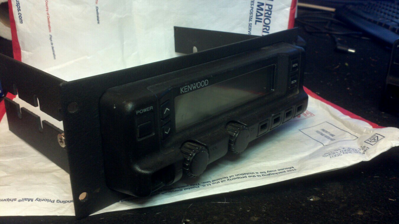

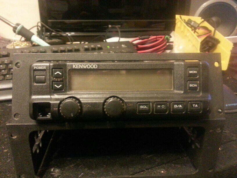

I already have two Lowrance 5" GPS units, one for the passenger and driver. I have a Kenwood 110 watt race radio with a remote head and flush mount bracket.

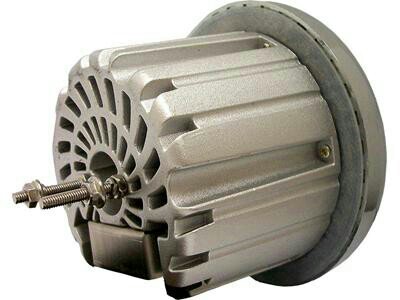

I have been thinking about a stereo for the Bronco, but I do not want to take up so much space on the dash with a standard 1 din unit.

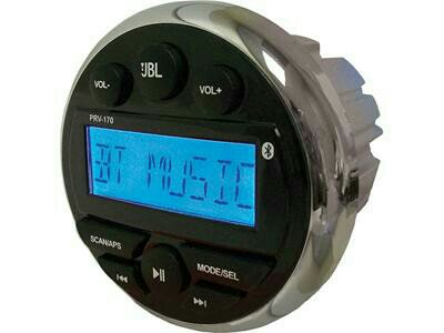

I found a small JBL 170 Marine stereo with Blue Tooth. It is around the size of a 4" round dash gauge. Also it is waterproof.

Switch's. The switch panels are white right now but I plan on painting them or maybe wrap in Carbon fiber film? The panels also have breakers on every swith.
I am going to get one of those JBA boat Stereo ' s with Blue tooth that is the size of a guage pod. I will put in some hidden speaker but also have a line into the intercom for the headset or my Forced air race helmets. I also already have a Sigtronics intercom.

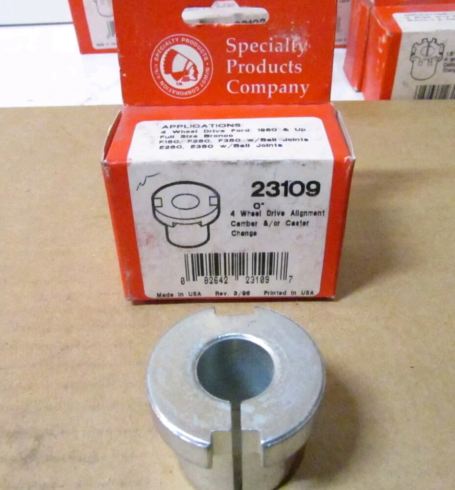

Well it has been a while since I have done some work on the Bronco.
Today I picked up a 0° camber bushing. I am not going to run it on the Bronco, but use it on the beam and knuckle when they are in my new jig for the
Beams. I am going to make a jig, so if I bend or break a beam, I can easily rebuild and replace the beams. Also, it will help keep the ttb housing from warping the housing while welding the truss in place. I originally used a 0° camber bushing at Glen's shop, Complete Fabrication, when he taught me how to do the cut and turn. I will be doing a jig/fixture like Glen does. If you can get your project in to his shop for anything you will not be disappointed.

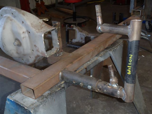

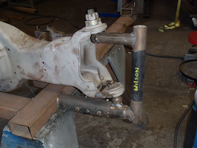

Re: David's little mule
Here's a few pics of the fixture (jig) Glen did for the beams on Chris Wilson's bronco. You can make a fixture out of all sorts of stuff but general point is to kae it out of something strong enough to keep the parts in place & from being able to warp during the weld up process.
Notice the bolts in the round tube under the lower ball joint here.
Ball joints are welded to the fixture to keep the ball joint spread correct when doing your C & T.
Here the beam has been cut & the end slid out (bolts in the tube under bottom ball joint = allow fixture to move for beam widen)
