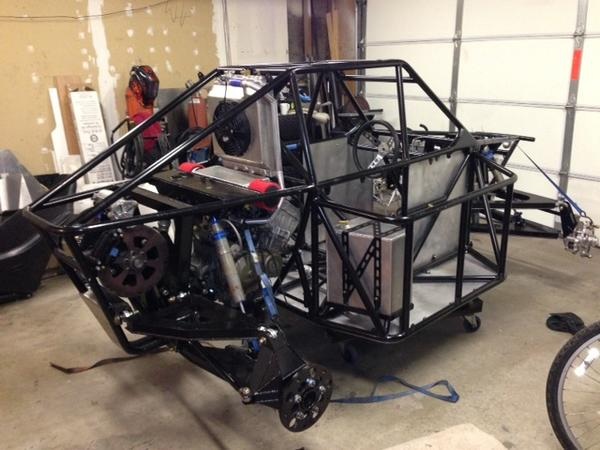

Here's some buggy dork pictures of my last project to show some of my fabrication capabilities. 96" WB, 73" TW, 20" travel front and rear, and it's a TON of fun! Every inch was designed in CAD and there's probably more laser cutting in it than most trophy trucks.
