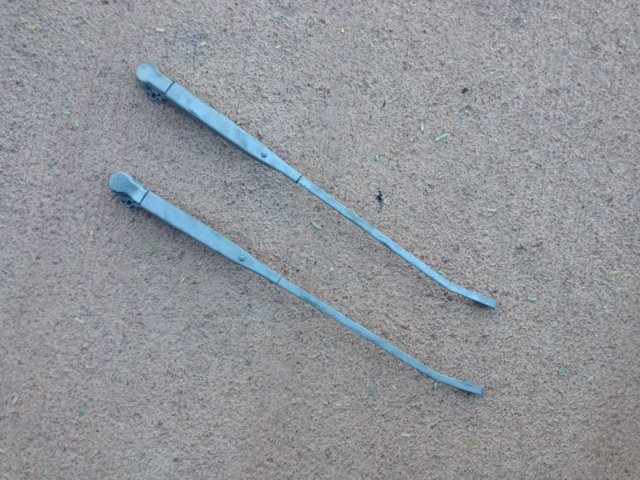

Well got some small things done today ...
**windshield in - its amazing how bad an old windshield looks compared to new
**wiper arms ran through my blast cabinet and re-painted and Bosch Evolution blades-- again really nice!
**picked up material for the radius arms -- going to fully plate them
**got my exhaust a little Yikes inspired--- the sound is about the exact same-- with the back window down from a dead stop I smell exhaust a little-- after drivign I dont smell anything-- but I got sleepy for some reason LOL :-)
photo 2 (14).JPG (111.83 KiB) Viewed 1702 times
photo 4 (11).JPG (106.43 KiB) Viewed 1702 times
photo 5.JPG (169.75 KiB) Viewed 1702 times
photo 1 (16).JPG (100.18 KiB) Viewed 1702 times

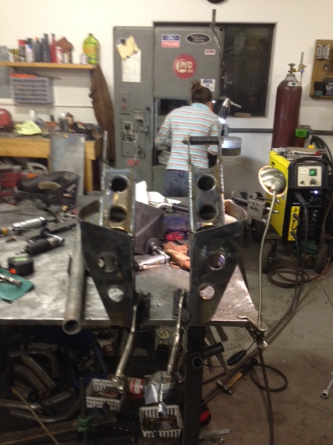

Radius Arm Work Begins...
Pics of the radius arms I got started on......
RA Ears1.JPG (118.72 KiB) Viewed 1627 times
RA Ears2.JPG (111.12 KiB) Viewed 1627 times
RA Ears3.JPG (105.34 KiB) Viewed 1627 times
RA Ears4.JPG (113.66 KiB) Viewed 1627 times
RA Mockup1.JPG (125.93 KiB) Viewed 1627 times

Re: 96 Bronco - Project "Cheryl"
Post by otter »
Looking good! I like the design :D

Radius Arm Upper Plates & Beam Pivots
I trimmed the upper radius arm plates for clearance so the shocks dont hit the radius arm-- then added 3/16" plate. Cut out the beam bushings tonight for uniballs. Going to start on the beam mods next........
photo 1 (9).JPG (93.68 KiB) Viewed 1432 times
photo 3 (11).JPG (112.68 KiB) Viewed 1432 times
photo 4 (11).JPG (119.79 KiB) Viewed 1432 times
