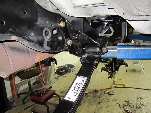

a few things done prior to mexico...Pics are from shock testing with the additional weight and reworked springs.
Rear bumper, hitch, swing rack, tire support
Front light bar
Sirius install
Race Radio Install
Grab Rails in rear cargo area install for holding pit boxes/gear
Reworked Deavers
Since mex everything has been powdercoated.

Some pictures of the latest changes. Crossover steering so I dont have to worry about bending anymore ambulance steering. Coilovers and airbumps added as well. Dialing in my own spring rate made a world of difference. Picked up quite a bit more speed and its much easier on the truck as a whole even with the faster speed.
Everything seems to work great and I love the fact its a sleeper. Preran a lap of yesterday's race course which was an incredible course laid out. I would say it was the fastest and smoothest course for barstow I have seen since ive been going out to barstow races. 35mph average around it with no hiccups, no beverages spilled and AC and Sirius crankin. A little bit of tuning on the front shocks will make it better but I have no complaints where it is at now.
Thanks to Jon @ crossroadsfabrication.com for letting me use his shop to do the work, Skyler for turning wrenches and making shit happen and Flynn for welding.

Looks great Kris!! I saw you a couple of times yesterday, but never had a chance to stop you and say hi!!
Curious, any side shots? And what spring rate are you running on the coilovers?

tcm glx wrote:Looks great Kris!! I saw you a couple of times yesterday, but never had a chance to stop you and say hi!!
350/500 ride height 23.75" hub CL to fender lip(stock fenders)
