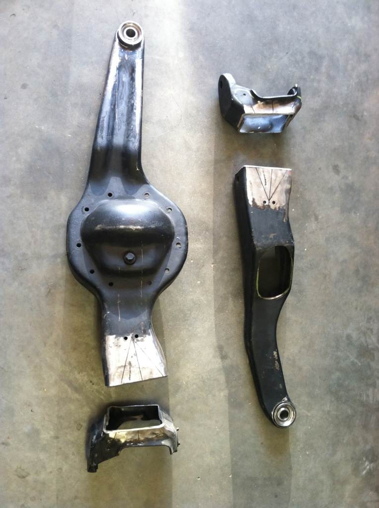

So far so good, been working on the beams getting ready to throw in some uniballs and extend them then it's off to the races.

Travis you cut them wrong!

I didnt want to push out my radius arms. These look to be extended in the same place.

How about these?

Travis, Im not talking about cutting them before or after the radius arm bosses..

So help me out then.

The angle of the cut vs the angle of the axle.

Travisfab wrote:So help me out then.
Its something you can easily correct. Ill pm you the details.

Ah gotcha, had me worried there for a bit. Thankfully I have access to a jig as well.
