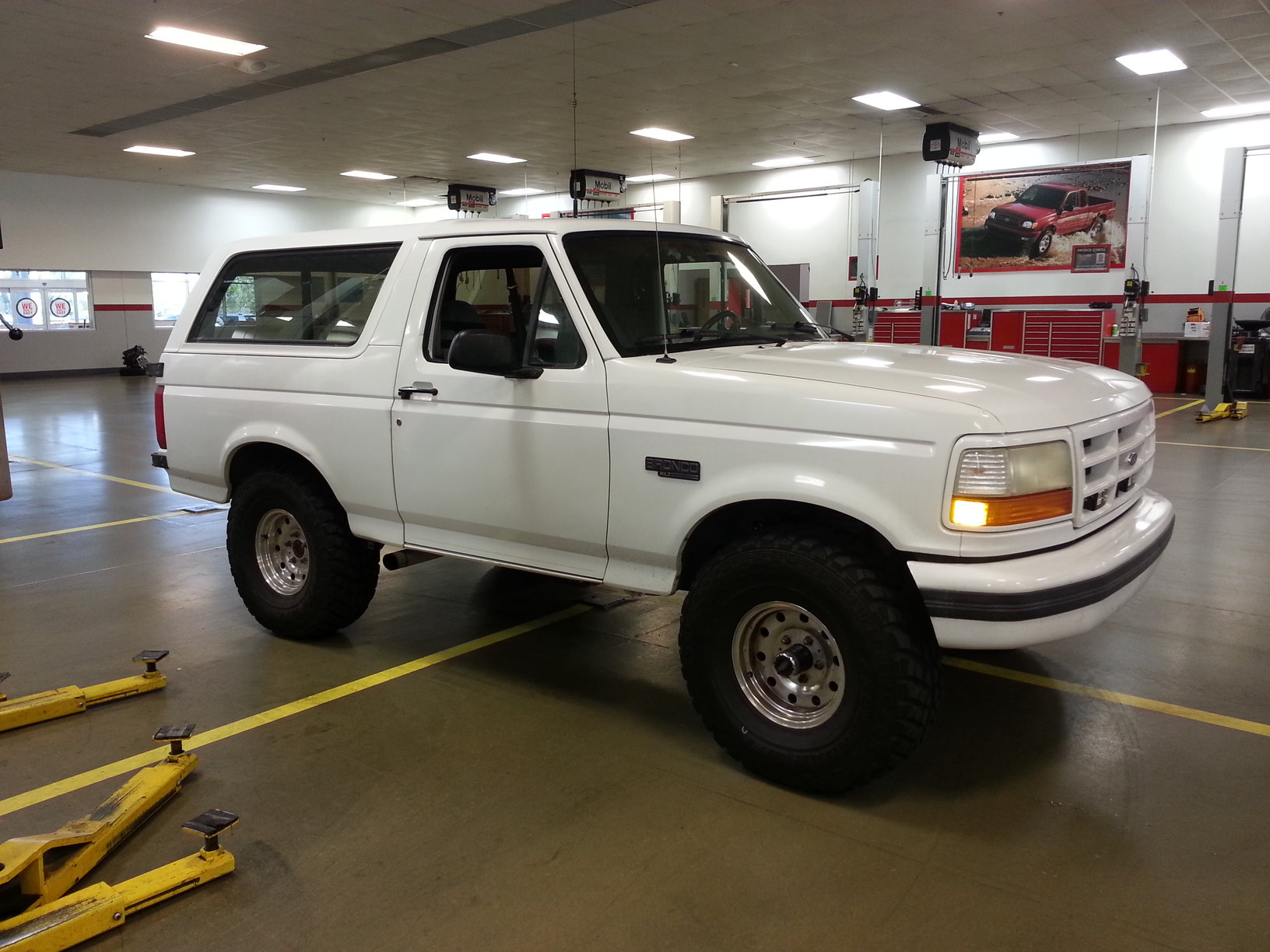

What shop is that? Place is CLEAN! I'd love to work on my stuff thee instead of in my mess!
Re: Seabass's cooler hauler
ChaseTruck754 wrote:What shop is that? Place is CLEAN! I'd love to work on my stuff thee instead of in my mess!
Santa Margarita Toyota where Seabass works... shop is awesome, when I had my 4runner, Service Manager let me watch them change the timing belt... side note, cool idea they used to get access to the front of the engine, they put my truck on a two post, removed the front wheels, and then lowered it so the front of the truck would be lowered and easier to access

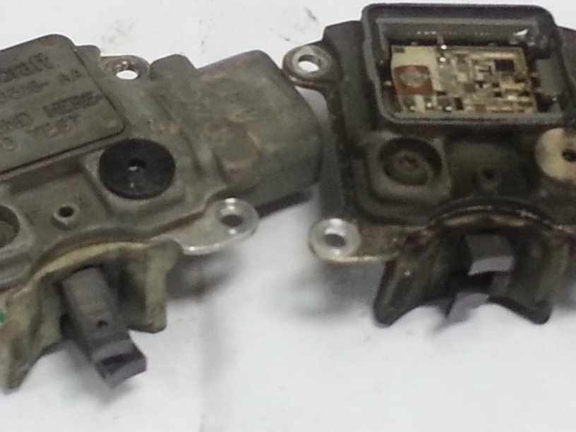

What was waiting for me in the large case altenator.  The good regulator came out of a junker alt I got from bigred. Thanks bud!

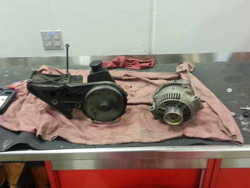

After disassembly and a run in the parts washer

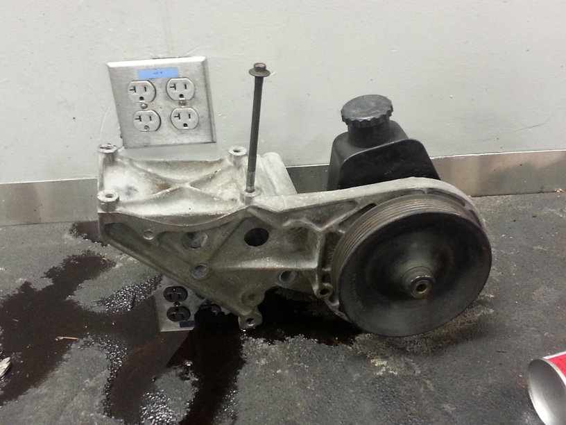

New junkyard toys
New junkyard toys

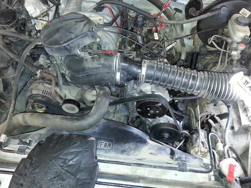

The finished product. 130amp large case 3g van altenator and saginaw pump with raised relief pressure and opened up flow restriction orifice.
