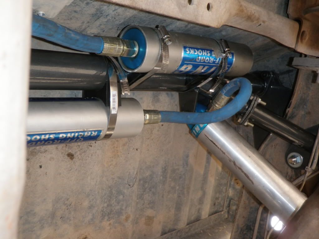

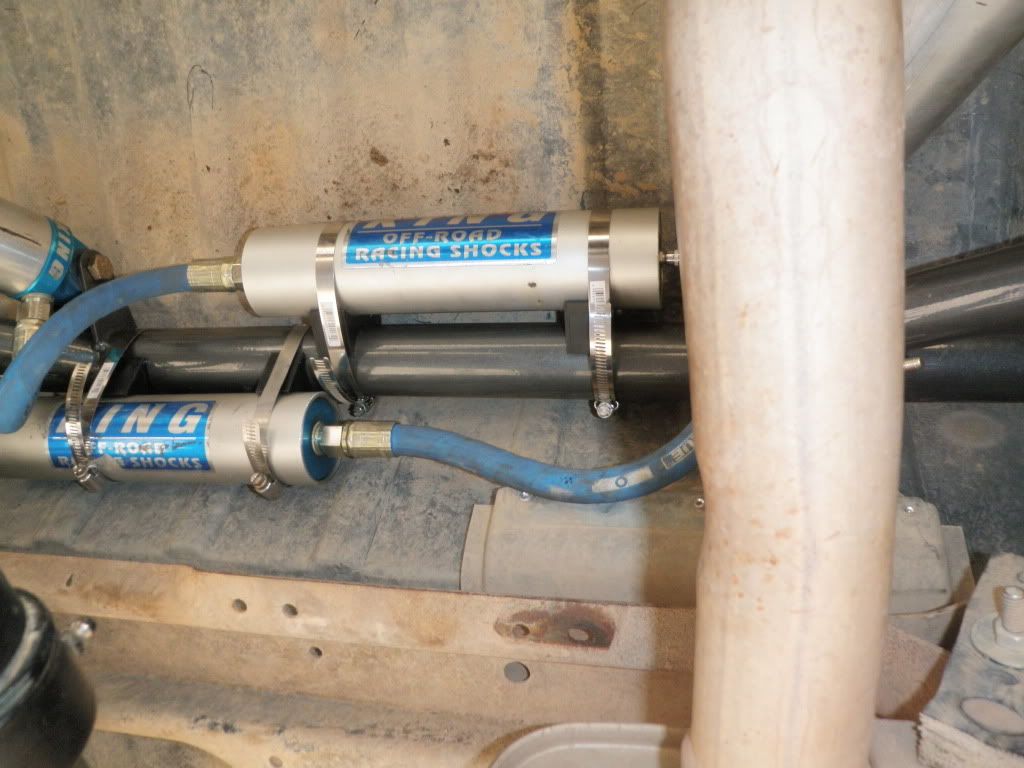

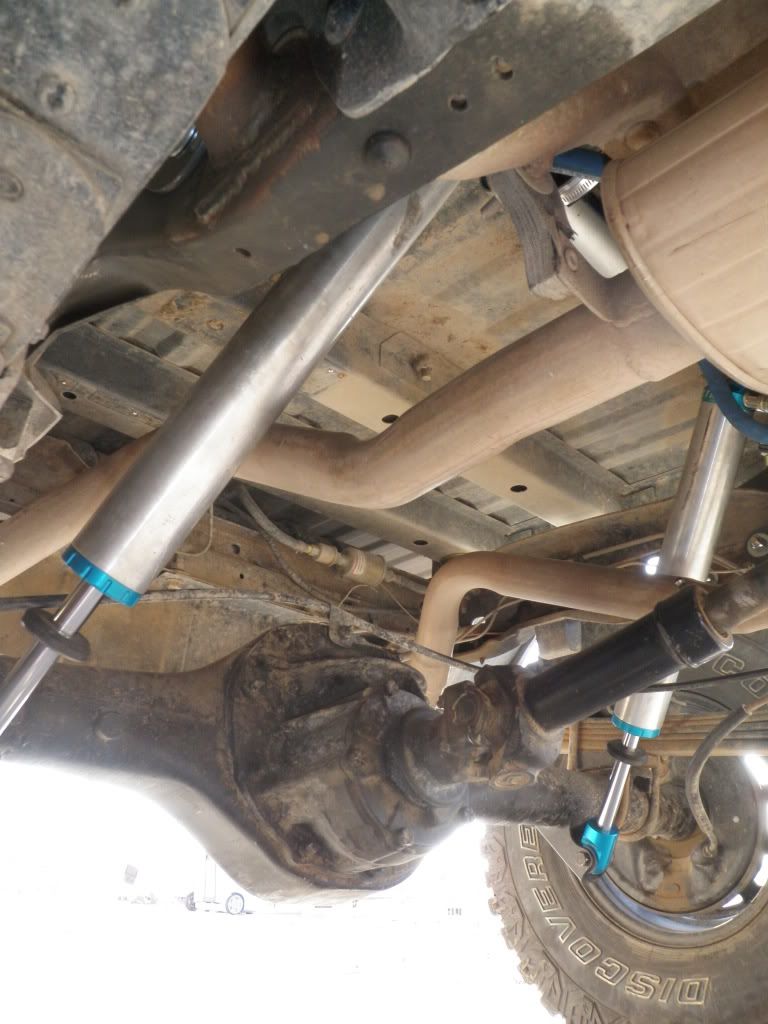

Got the King's installed on the rear today
other than being a bit concerned about how sharp a bend I have in this hose, it looks pretty good
Now to charge em up and test em out. I picked up some of the misalignment shims for the front shock over the weekend in Phoenix too.

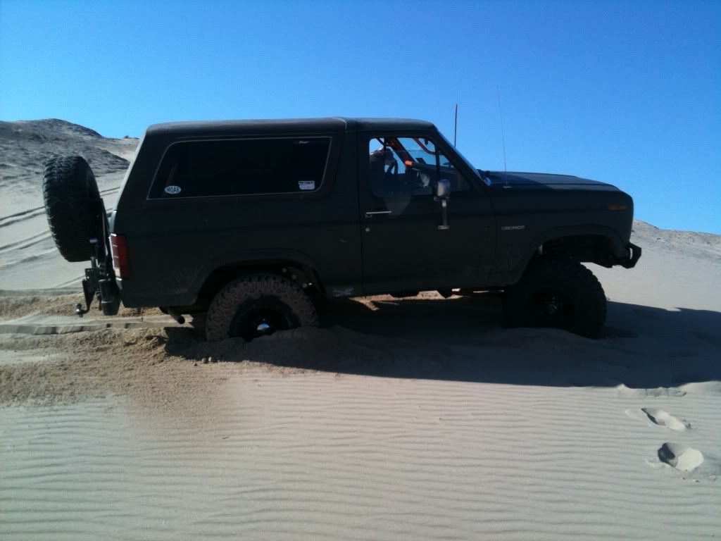

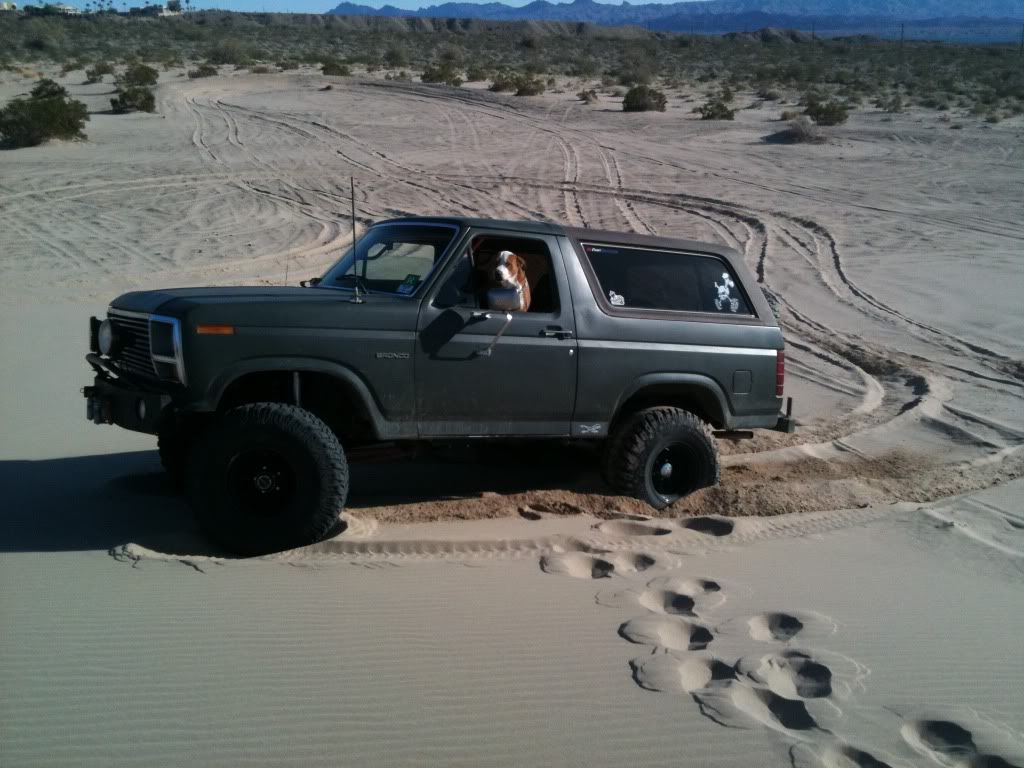

Ran great with the new shocks on the back.
Pressurized them this afternoon, then beat on it for a few minutes to see how it works.
I need to extend my bump stops though, the teltale on the shock was all the way at the bottom. Guess I'll go look for some of the S10 style bumps.
The detroit works great, but soft sand uphill with no speed in 2wd just sinks. Couldn't quite get turned around, so I had to get out and lock the hubs.

philofab wrote:Crystal beach?
nope, desert hills between paloverde north and Lake dr. I can see the other side of that hill from my office window.
crystal beach has some good spots too, but I needed a quick fix, as I am now leaving for school, didn't have much time.

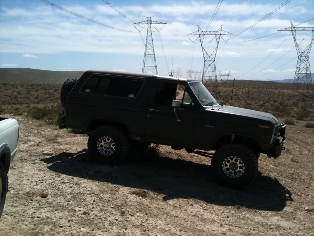

Re: NavyNukes 82 Build

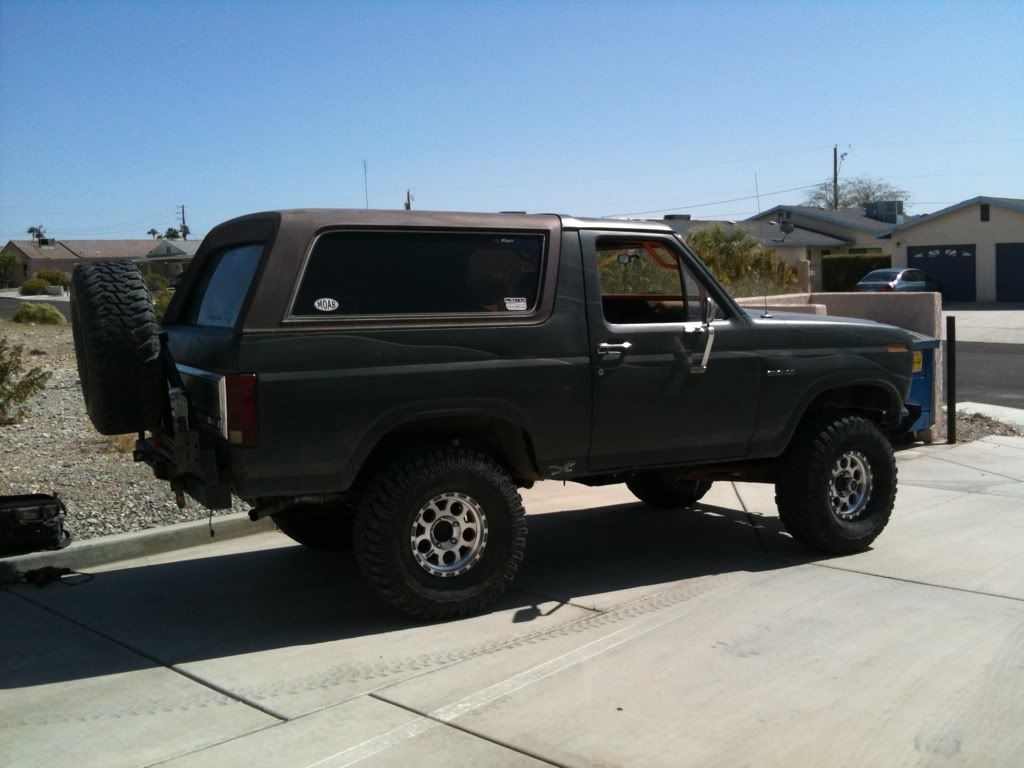

New rims look good. Make the brown top seem to look better too.
Thanks guys. Worked REALLY well out at the Mint400.
The center caps from my old rims actually fit these rims too.
