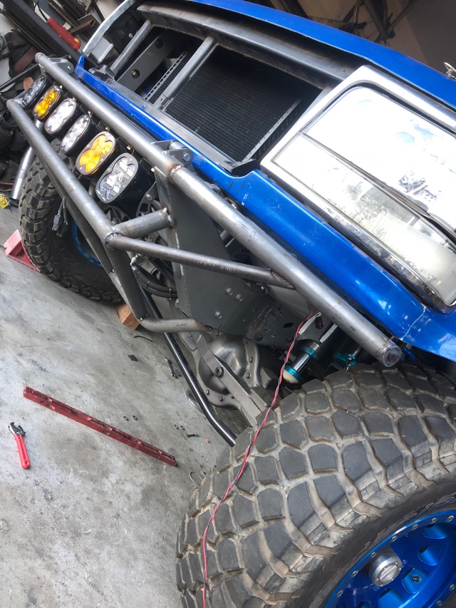

I got a sneak peak of the bumper. Valance will go from top to bottom tube and have cut out for lights.

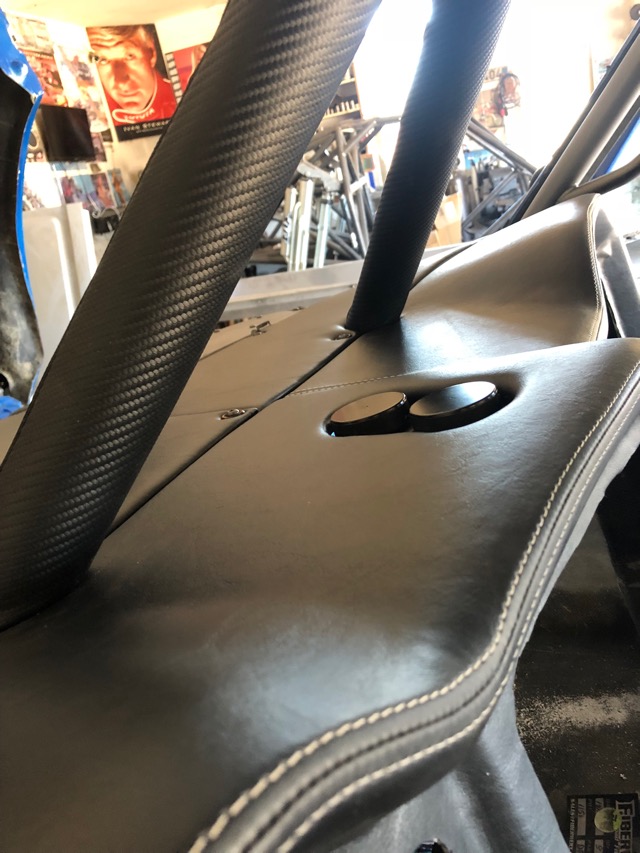

Sneak peak of the interior. Getting it all back together for final assembly.
Re: John's 91 GFB
Nice!
Bajaluv
Posts: 489
John's 91 GFB
Post by Bajaluv »
Dash looks so good with upholstery!! Can’t wait to see in person.

Thanks guys. Pretty happy with how the interior turned out. Got the new seats ready to go, carbon is pretty legit.
