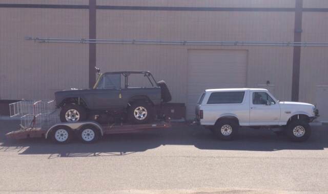

In case anyone wondered about towing and using a Go fast FSB. So this week I towed a bunch with my 96. She's got a good flexy suspension and a 4.56 gear and stock everything engine. With a steel trailer, no trailer brakes, no sway bars, and really improperly loaded with a fully put together 77 bronco. It honestly pulled pretty nicely. Change to a shorter aluminum trailer, properly loaded, with brakes and I think pulling with it would be a breeze and pretty darn pucker-free. More engine power would have been nice but I could still pull a decent hill at speed. Don't be afraid to pull with a bronco like I was!
- image.jpg (61.27 KiB) Viewed 4773 times

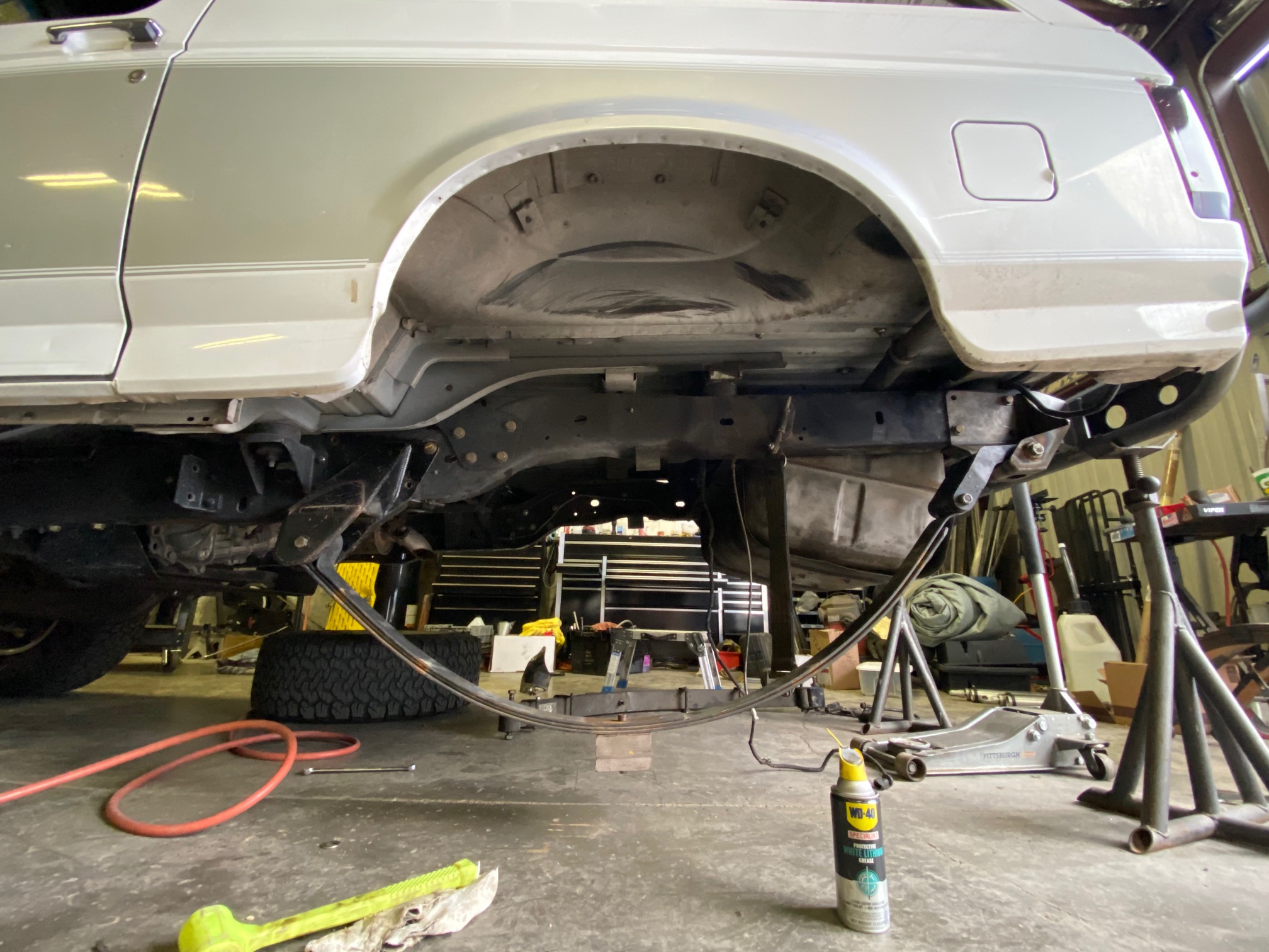

Long time from doing much to the old gal. The 9” saga begins today....

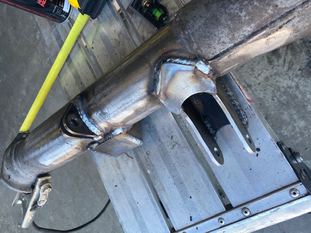

Starting to barely get stuff done on the 9”/ 64” spring swap. Just as an FYI the Richer Racing parts have fit up extremely well unlike the garbage from the other 64” kit brand. The 9” is going to be a nodular 3.250 case, 31 spline Detroit and 4.88 gears. Prob going to put my explorer rear discs on from my F150 and sexy up the rear brakes on the F1.

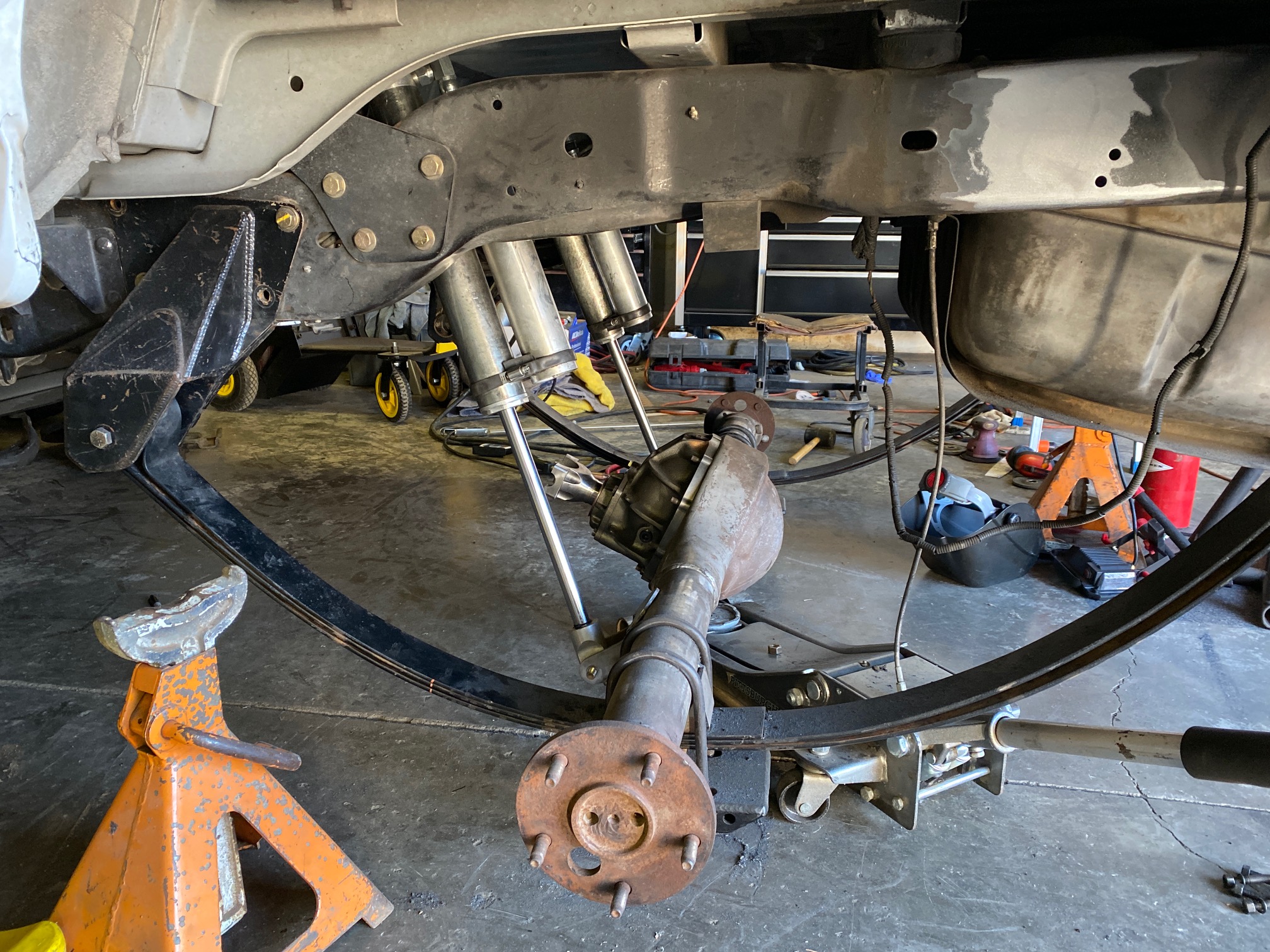

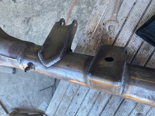

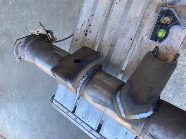

Getting closer on the 9” /64” swap!
