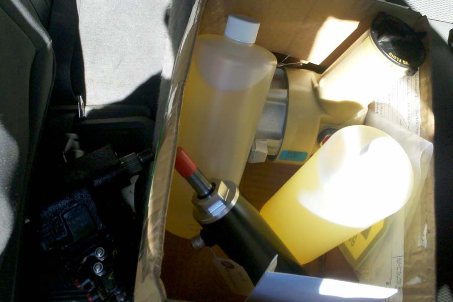

Got my parts from Lee...looking forward to slappin it all together in a couple weeks.
Sector shaft crack was pretty big. glad to have a new factory part in it now anyhow.
- 2011-10-11_12-24-39_211.jpg (108.41 KiB) Viewed 2593 times
- 2011-10-11_12-21-14_818.jpg (78.61 KiB) Viewed 2593 times
