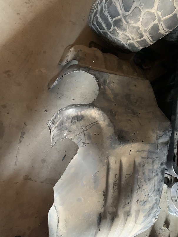

Got the inner fender cut out including the coilover spot. Radius arms are done brackets are painted and only 1 bolt left on drivers side to finish. I got the river out of the engine cross member and I’m sore. Bumpstop bracket is made for the frame, all I have now is to find the bump spot and cut plate. I’m going to open up the passenger side axle portal and reinforce it so I’ll move 1 step back. My daughter helped me get nuts on the bolts and did it without seeing them. She has now been nominated to get her hands in the frame for the two front bolts.

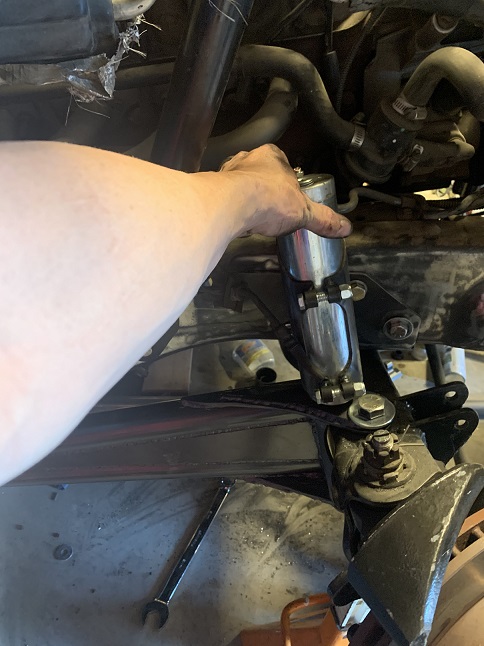

I got a wild hair and wanted to see the bump in its home. It should work pretty well I think.

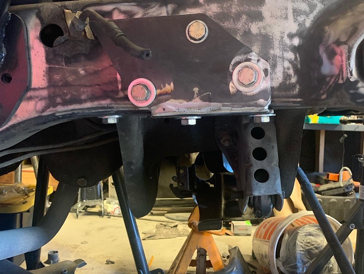

It’s amazing what paint will do to make your part look better ImageImage
Re: Carly's 96
I may reshape the backside of the plate but other than that I think I’ve got the bump can mount solved.
