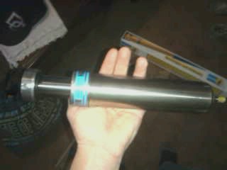

Alright, first thank you Mark for stopping by this morning and dropping off all the new parts for the Bronco! Everything looks awesome, I'll have pics tonight.

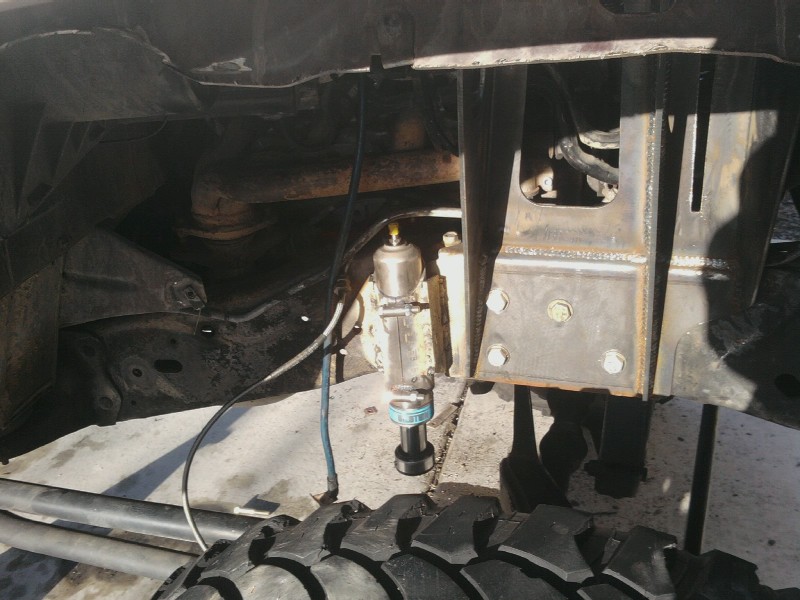

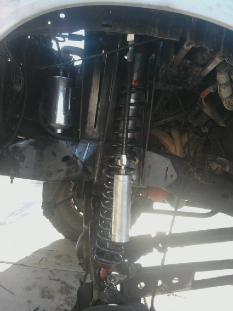

Re: HTO'S BRONCO BUILD

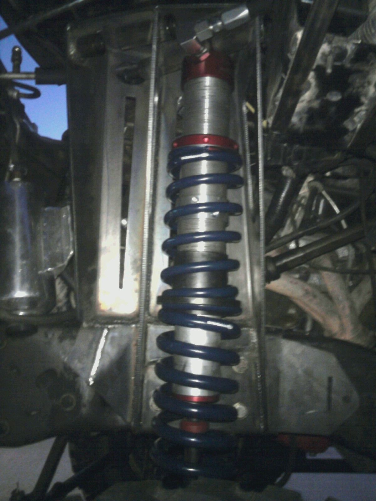

The new shock setup! Its all mocked up just need the spacers and finish the bolts on the top of the frame rail.

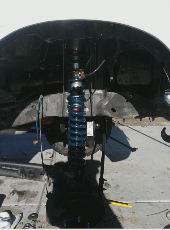

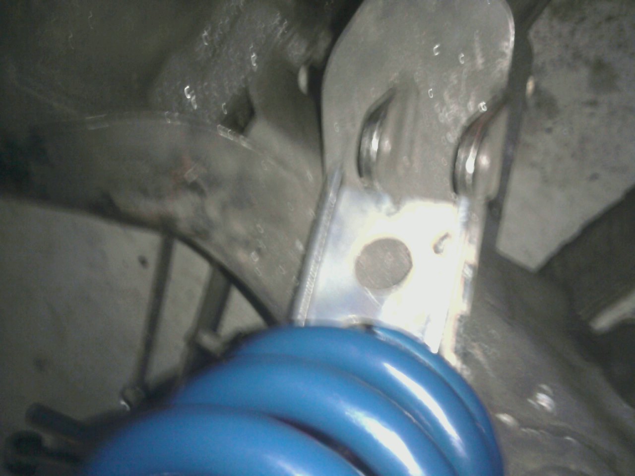

Posts: 4619
And 2 more
what size coilover are you running?
Posts: 4619
2.5 X 14". Thanks John!
What spring rates did you go with?
Posts: 4619
400/500 same as Mark.

Posts: 4619
Thanks Andy! I love it. Pretty straight forward no secrets really except that you can weld the supports for the shock mounts on the radius arm backwards and the shock will not fit.... That was fuuun fixing.

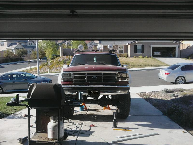

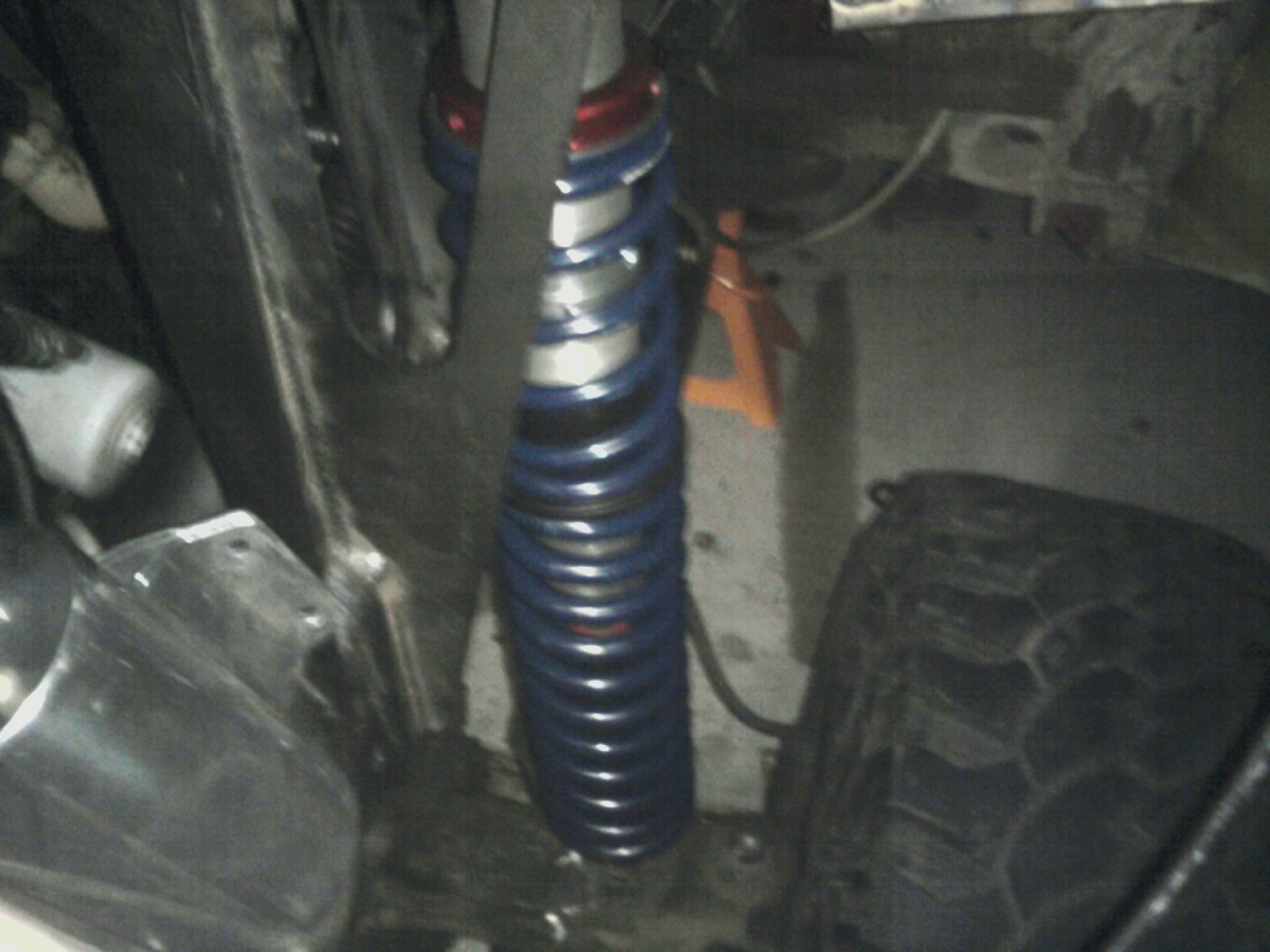

Some more small updates
So last week I got the front finished except for straps and took it out last weekend. What can I say, Mark you did an amazing job with that kit! Scared my buddy and the fioncee loves it. As for me its a given. I can't believe I didn't go c/o before! I'll post some pics later, its a bit embarrassing with the stock bumper.
