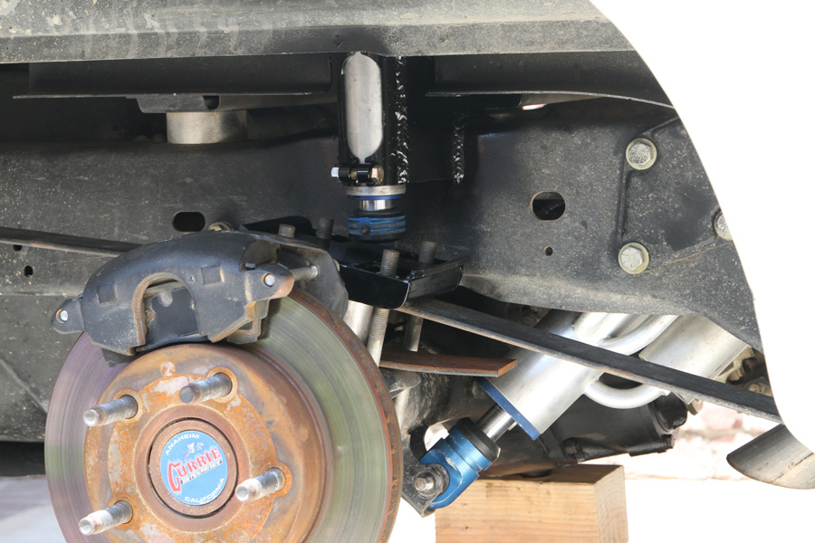

No not notching the frame, i dont want the springs to go anymore negative than they are...I would rather play it safe and not run into issues with the springs busting. Im bumping off the top of the spring plate which is why the bumpstop is mounted so high on the frame.

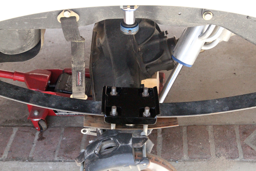

Thanks Tony! Here are some better pictures including the spring plates and at bump.

How much are your springs going into negative arch with this set up?

At full bump I'm going 2" negative which is where I was with the factory bump and a 1" spacer. I figure the factory rubber bump compresses at least half an inch...
