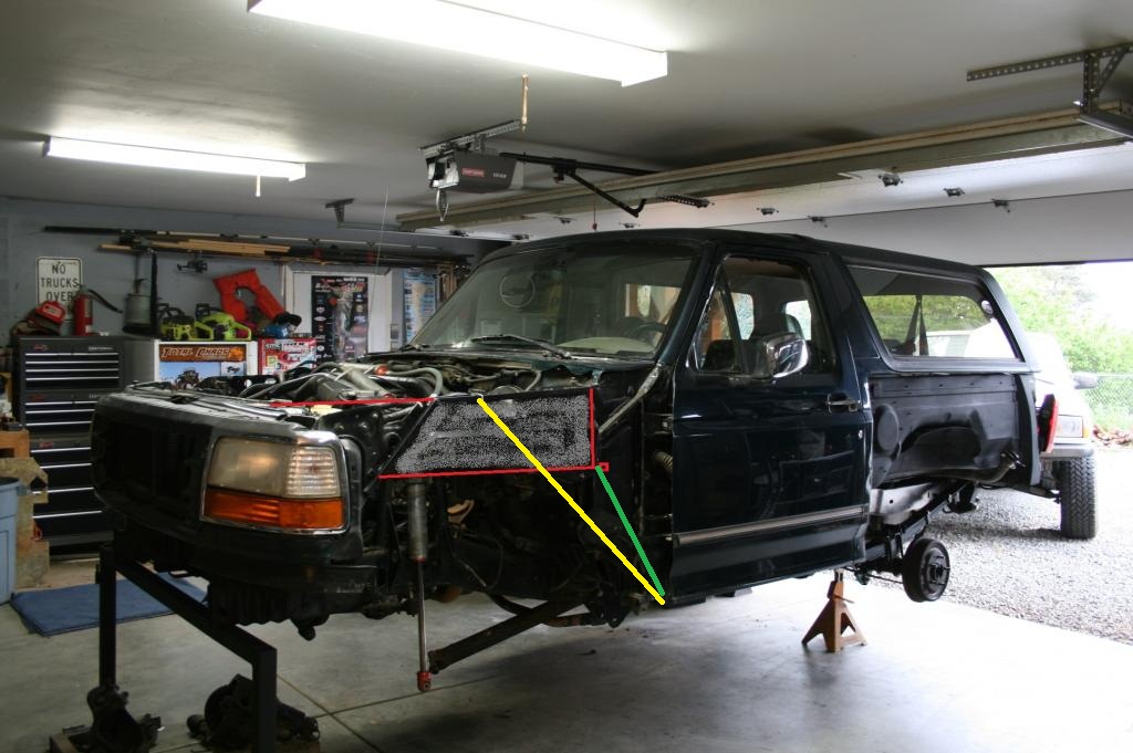

Been cleaning up the wheel wells to avoid any further issues. Pretty much waiting on parts!
Re: 95 Bronco Build!
Travis,
Looking good.... a quick suggestion; Add some tubing to the inner fender skin from that white zip tie down towards the molding on the door. I built my inner skin similar to yours and after about two years of hitting the dirt, the skin started to crack a bit.
Just asuggestion.... and since your waiting on parts, gives you something to do.
Thanks!
I was planning on doing something like this. The red would be more square tube with a lower piece that bolts to the cab, and then I was going to plate over it all. Going to run a piece over to the core support as well (kind of hard to see in my auto cad rendering!)
Yup, but I would add one more that goes all the way down, either the yellow or green added here
I dont have any of the factory inner fender in that rear area though, not sure if I'll need that.
Haha is that a single jack stand holding up the back or am I blind?
Looks like the angle of the photo cuts off the other one. I can see something that may be the base of it, but it's hard to tell.
haha A couple pics up you can see the tire is still on the pass side! I have done some sketchy stuff bu full truck try pod, I was impressed!
