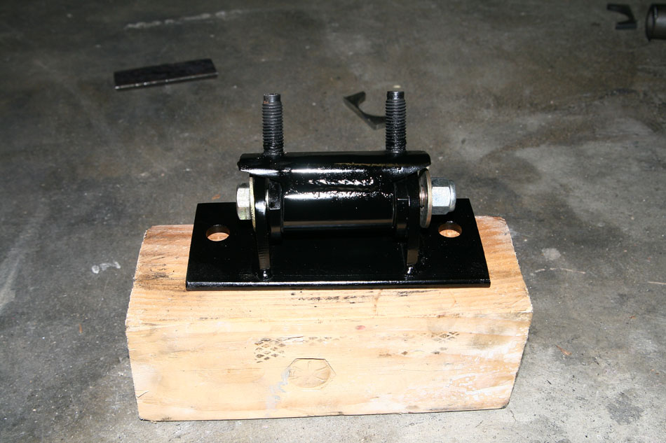

Went to shoot the shit with Bobby at solo for a bit today and he showed me their beam pivots for the broncos ...These things are bad ass and are definately on my list of must haves! I should have snap a few pics to share with you guys. I got alot accomplished after work today. I Installed the new race radio (Icom V8000) and built a trans mount and got it all installed...Feeling very productive today! Im getting ready for the SNORE PCI 300 in ridgecrest this weekend, is anyone else going?
Heres a pic of the trans mount, it just replaces the factory mount. I built some poly motor mount similar to the auto fab ones a few months back and figured i should do the same for the trans mount.

Nice! Looks really good. I bought the autofab one and the full engine mounts too... Just waiting til i do all new freeze plugs and new pan at the same time.

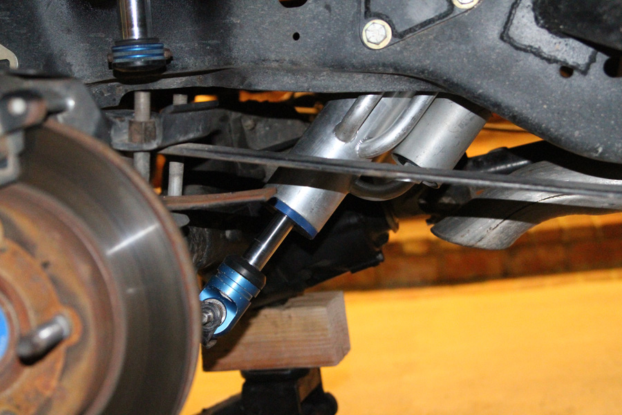

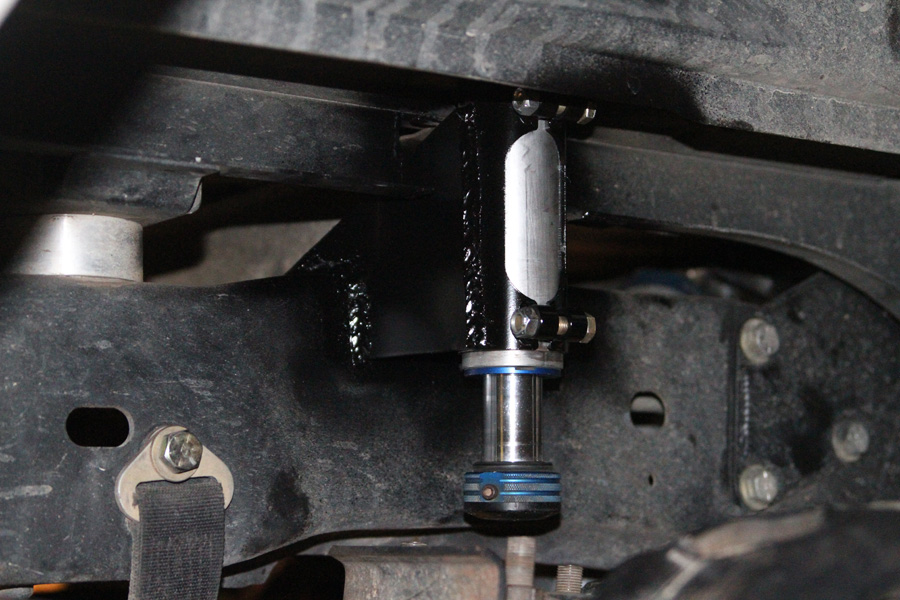

I woke up this mornign and dove right into the bronco. I got the 3.0's installed with minor tweaking (had to kick in the upper mounts about 1.5" so the bypass tubes wouldnt hit the frame during articulation). I also went down to Solo and cut out all the brackets for the bumps & spring plates "Thanks Bobby". My new favorite tool is the iron worker, i used the helll out of the nibbler and it sure made life easy! I got the passenger side bumpstop completely mounted up and painted and also reinforced/gusseted the spring plates as as the air bumps will be bumping the tops. Heres a couple pics.
