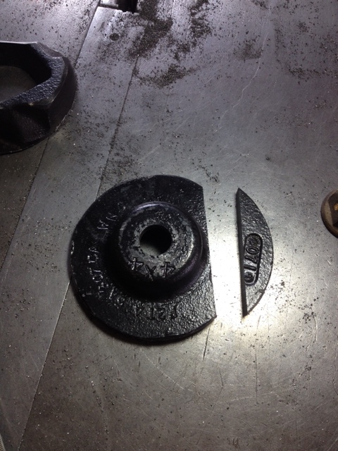

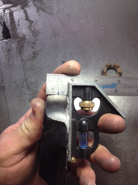

Lower spring mount-- "Bagel-Cut Mod"
Here is what I ended up doing with my lower factory spring mount. I honestly did this prior to the toe getting fixed causing the springs to not relax and sit high. With that said I have heard of at least a couple guys talking about lowering their front end an inch or so. I am gonna call this the lower spring mount "bagel-cut mod" I dont have a mill which would be the best way to accomplish this but I do have a killer bandsaw and it worked out to get the factory piece cut down. With the 7/8" cut down she is sitting dead level,

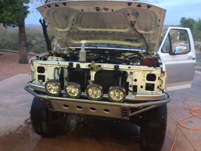

Got some cleaning up done to the front headlight support pieces. Two big boxes with my Baja XD's came in as well-- had to go hunt down the UPS guy is why they are in the back of the truck

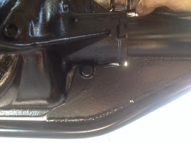

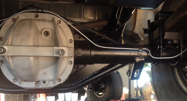

Some rear end truss pics. The webbing in the center section was tapped as close to the tube as possible, then plate pieces to the tubes, the bolts go thru the plate and welded to the plate. On the cast I put a big tack weld on the bolts to just further keep it all together. Added a couple weld washers to the lower shock mounts. I'm a fan of -3an stuff-- I call brass the "devils metal ".... Lol!!

Re: 96 Bronco - Project "Cheryl"
Nice. Looked like it handle that pretty good.
- 1Hondalover
- Posts: 819
- Joined: Mon May 14, 2012 2:30 pm
- Bronco Info: Having so much fun with friends in Baja, we're not sure if we want to race NORRA.....
- Location: Santa Clarita
Yeah.....good hit and it settled right down. Looks like you're getting it dialed.
Yea it was pretty nice -- now I know that coilovers are in the future at some point. The front shocks didn't come close to bottoming out- funny thing though my back is fu@king killing me right now! I'm not sure if that drop off did it or just getting up from the computer I tweaked something. I've got good seats now so who knows!
I'm liking the truss!!! Good work.
Thanks-- not sure if this truss actually does anything but it can't hurt-- without doing all the heating/preheating nickel rod-- this is about as good as it gets short of something really major. Its mainly because I thought it looked cool ..LOL!!

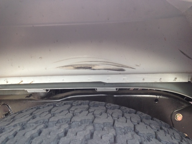

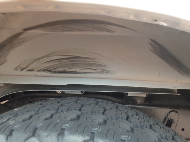

Well today I noticed something on the body of my truck-- the drivers side rear inner fender was pretty scuffed up, and the body was tweaked a tad too. The passenger side rear was scuffed too. I am guessing that is the norm on the FSB with 35" tires and stock alcoas?? I went back and looked at the video - that driver side rear hit really hard
I am still waiting on u-bolts so I can mount up the J40's. Hopefully the J40's will help control the rear axle and slow the upward speed the hits happen. Also at this point I think there needs to b "more" shock. Currently the shocks are just a little light and need to be just a bit stiffer. Went back today-- that drop off is 42" and not 30"!!! Another question-- anyone think that drop off would have fully collapsed the front coil spring on impact? I almost think the spring was fully collapsed because I doesn't appear I used all the shock up all the way to the stock bumpstop. Love to hear some thoughts from the TTB guys in the know.....
The truss looks good. It looks like it will help the axle tubs from pulling out and better support than stock to keep the housing from bending. Maybe a back truss that bolts to the diff cover would be a good idea to help horizontal pressure on axle tubes.
Rub on the inner fenders is common.
Bump stops coming soon to a bronco named Cheryl near you!!!
Pretty much par for the course bro, the j40's will allow you to push it harder and the same thing will happen. Get some air bumps and you'll be good to go. Urethane bumps set before tire rub has the same result but depends on buget.
