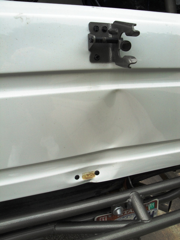

guard...Appreciate that. Yeah, that road noise, and suspension squeaks, and fumes, and dust...all gone now! Yup, stock tire carrier...at least for now. It's hanging in there, except the swing arm bushings need replacing with some new bronze ones (the originals melted during the powder coating...yes, too lazy to get them pulled apart. :oops: ) So for now, it's holding up just fine...and this after I was rear-ended by a lady in a Ford Edge back in 2011. Minimal damage to my Bronco...her Edge crumbled like it had hit a brick wall...

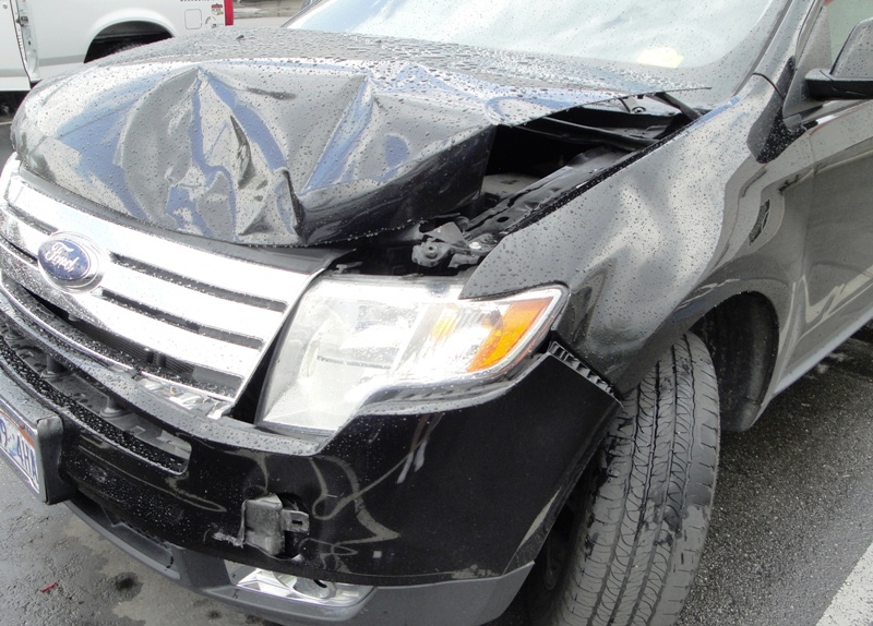

Rear End Damage 7-6-2011 (1).jpg (171.48 KiB) Viewed 3816 times
Rear End Damage 7-6-2011 (4).JPG (209.34 KiB) Viewed 3816 times
Rear End Damage 7-6-2011 (3).JPG (138.97 KiB) Viewed 3816 times
Damaged Ford Edge that Hit Me (0).jpg (217.49 KiB) Viewed 3816 times

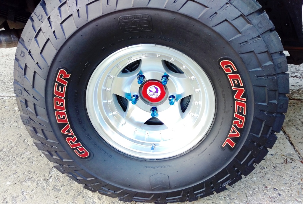

I was able to put the full size 35x12.5-15 spare on with extra long lug nuts. This allowed the wheel to barely engage the threads, and then compress the back side of the tire against the swing arm of the carrier, stabilizing it a bit, as I tightened the lugs down. I just spot check the mounting bolts every month or so and make sure everything is still holding in there. Possibly a heavy duty tire carrier some day (modifications to the rear bumper to take all the weight off the tailgate...), but for now, she's holding together.

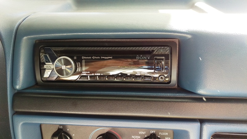

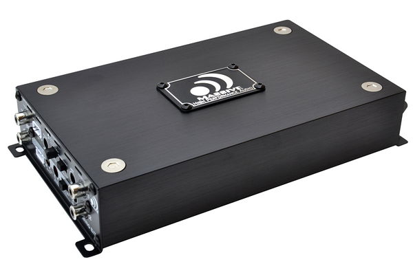

ICE (In-Car Entertainment) Install Update...this last spring, I had a car stereo local shop (Drive In Audiosound, Murray, Utah) install my new stereo in my Bronco, consisting of:
  • Head Unit: Sony #MEX-GS810BT AM/FM/CD HD BT Radio
  • Amplifier: Massive Audio #BX4 (4 x 120W) 'Nano BiT' Amp
  • F Door Speakers: Kicker #DS65 (6.75" 2-way oversized)
  • R Speakers: Kicker #DS693 (6x9 3-way...modified to fit the OEM 6x8 openings)
...and I couldn't be happier. The new "quiet" interior combined with the Massive Audio 120W/channel amplifier and those Kickers...resulted in a total transformation of the interior.
I wanted an HD radio, and when I heard about this particular model from Sony, I waited for almost a year before it was released late last Fall to the USA...and I am glad I waited. The HD radio is just great, and since I listen to a lot of FM (classic rock, jazz), and even a fair amount of talk radio, it was well worth the wait to get THAT model with just the features I wanted.
I purchased the radio from Crutchfield (got the extra Metra installation kit and wiring harness for free,) and James at Drive In Audiosound put it all together with a Scosche amp installation kit, mounted the Massive Audio amp up underneath the dash...securely...and then adjusted the audio levels to produce some amazing sound.

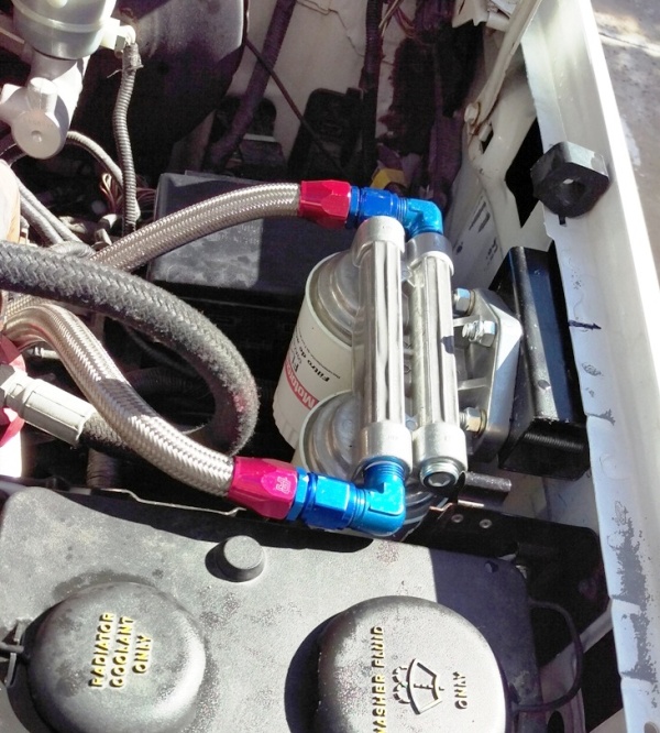

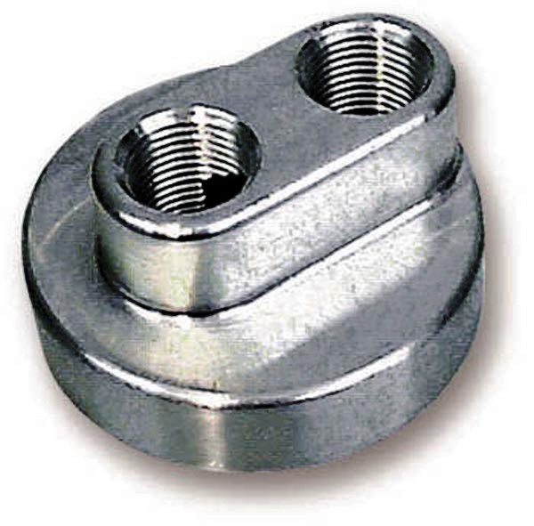

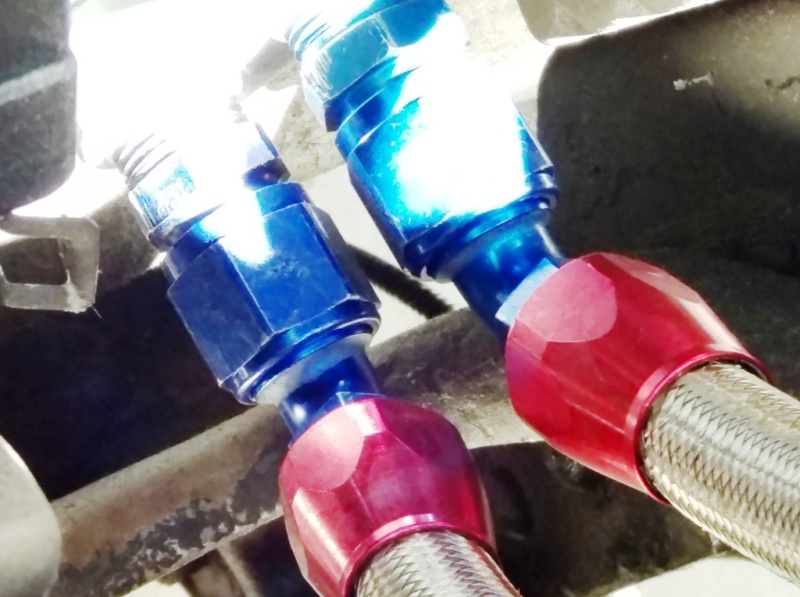

After wanting to do this for years now (and eliminate...permanently the messy oil filter changes with the stock filter location...grrrr...), I had one of my local performance shops, Addit 2 Your Toy here in Sandy, UT, do the install of a complete dual remote oil filter system a few weeks back...
The new system included:
  • Derale/TransDapt #1030 Dual Remote Filter Mount (for FL-1A sized filters)
  • Earl's #1178 Remote Filter Adapter
  • Misc. Earl's Flare Fittings & Hose Ends (-10AN)
  • Braided SS Hose (-10AN)
  • Motorcraft FL-1A Filters (2 EA) [to be replaced with a pair of the yellow Purolator #PL30001 'Pure One' filters at next oil change...]
And Joe, the owner of Addit (a Vietnam Vet with the 101st Abn Div...) did a great job (as usual.). I had him install the remote mount where the old OEM air box was located, and after fabricating a mounting pad (and re-securing the old radiator overflow/windshield washer fluid tanks), everything came together like a charm. Joe used Earl's -10AN fittings instead of the Jegs, but other than that, everything went as planned.
After a two minor leaks :roll: were fixed: 1.) Where the -10 flare fitting went into the remote mount, and 2.) A minor "oozing" leak on the top of the Derale dual remote mount (yes, oil was actually seeping through the top of the casting along where the ribs are...through some small fissures obviously due to poor casting techniques and quality control...hmmmm) by using some marine-grade JB Weld (which is the dark grey filler you see on the top of the filter pad), all is well!
Now oil changes are a snap...no fuss, no muss! That, and I've increase my oil capacity by at least a quart (the second oil filter + the added capacity within the hoses themselves), and have a nice way to route a remote oil filter, AND install an oil pressure sending unit too!
Some pictures...

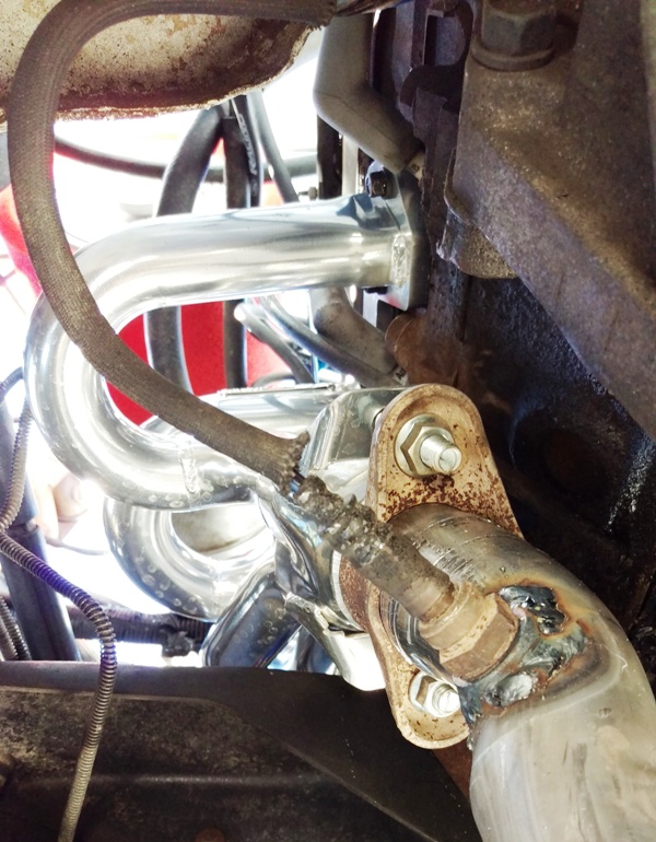

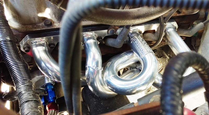

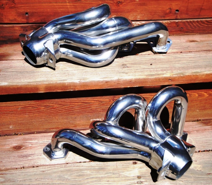

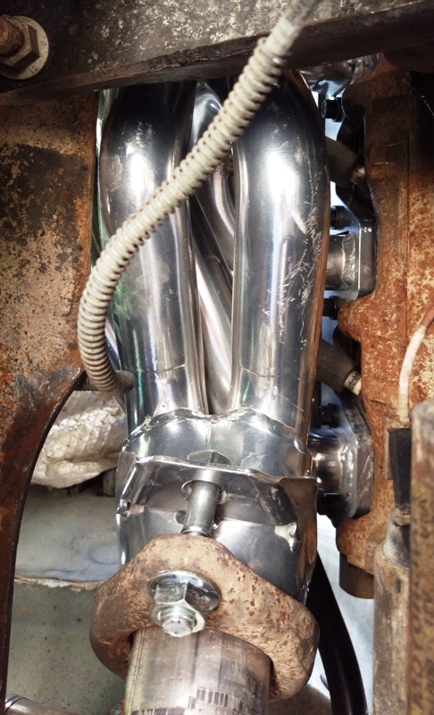

After purchasing the Bassani #50150BC headers and then hanging them in my garage for the last 3.5 years :cry: ...just "waiting for the right day..." I finally got them installed by my local Master Muffler shop, and their top technician/fabricator Don.
They went on fairly easily, but they encountered some minor challenges during the process:
  • Spring buckets/shock towers, AACS air filter/MAF tubing/mounts, and shock tower cross bar impeded progress by limiting easy and open access from the top side of the engine
  • The coupling flares on the down pipes weren't 'flared' enough to cover the end of the Bassani collectors, necessitating some new down pipes
  • ...but that actually turned out OK, as the shop knew they had to weld in new oxygen sensor bungs just below the flare (as the Bassani 501050BC headers do not have the O2 bung welded into the collector as delivered from the factory), and having new downpipes allowed for easier welding
  • The passenger side header was seriously close to the frame and the starter...almost necessitating a small frame notch near one of the primary tubes (I still may have them do that as the clearance is about 1/8th of an inch)
  • The passenger side header also came near the RF wheel brake line (as the line was relocated slightly when the Autofab suspension was installed)...so that was slightly modified to add a few more inches of clearance...and I will most likely put a heat shield wrap on the brake line and a thermal blanket wrap on the starter...just in case
  • Will need to figure out how to secure the top end of the dipstick, as the bracket it once bolted to is now gone

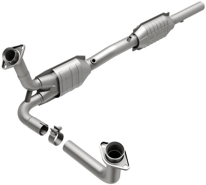

So far, the engine runs great, no CEL, and is no louder than before. However, I think I have to get through that "OBDII drive cycle" to get it to be ready for for my Utah State emissions and safety inspection next month (and once all the sensors are 'calibrated', the CEL won't come on!) :?:
Here are some pictures of the headers when I bought them in February of 2012, then installed, and the OEM cast iron exhaust manifolds that came off the Bronco.
Bassani 50150BC Headers (1) Small.JPG (212.55 KiB) Viewed 3542 times
Bassani Header Install 10-24-2015 (2).jpg (168.96 KiB) Viewed 3542 times
Bassani Header Install 10-24-2015 (3).jpg (192.5 KiB) Viewed 3542 times
Bassani Header Install 10-24-2015 (7).jpg (181.7 KiB) Viewed 3542 times
Bassani Header Install 10-24-2015 (8).jpg (165.77 KiB) Viewed 3542 times
Bassani Header Install 10-24-2015 (9).jpg (188.29 KiB) Viewed 3542 times

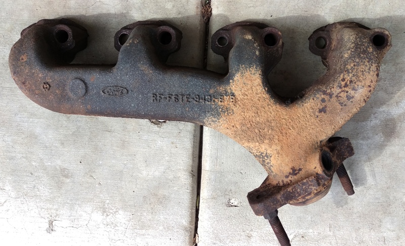

Re: Utah BroncoSpeed - OEM Cast Iron Manifolds...
Post by denhabr »

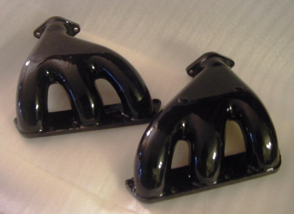

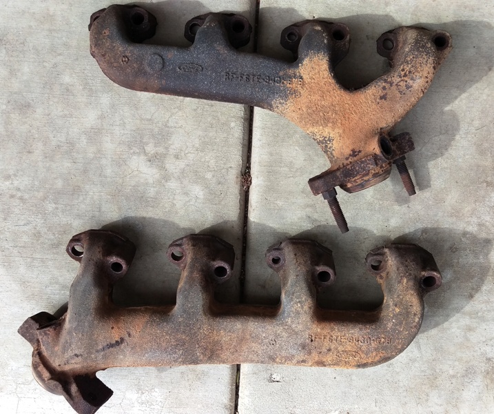

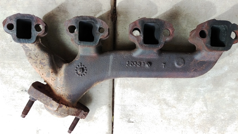

...in case anyone is interested:
Ford Bronco Exhaust Manifolds 10-25-2015 (1).jpg (210.02 KiB) Viewed 3541 times
Ford Bronco Exhaust Manifolds 10-25-2015 (2).jpg (190.23 KiB) Viewed 3541 times
Ford Bronco Exhaust Manifolds 10-25-2015 (3).jpg (196.51 KiB) Viewed 3541 times
Ford Bronco Exhaust Manifolds 10-25-2015 (4).jpg (160.61 KiB) Viewed 3541 times
Ford Bronco Exhaust Manifolds 10-25-2015 (7).jpg (139.35 KiB) Viewed 3541 times
Ford Bronco Exhaust Manifolds 10-25-2015 (8).jpg (156.14 KiB) Viewed 3541 times

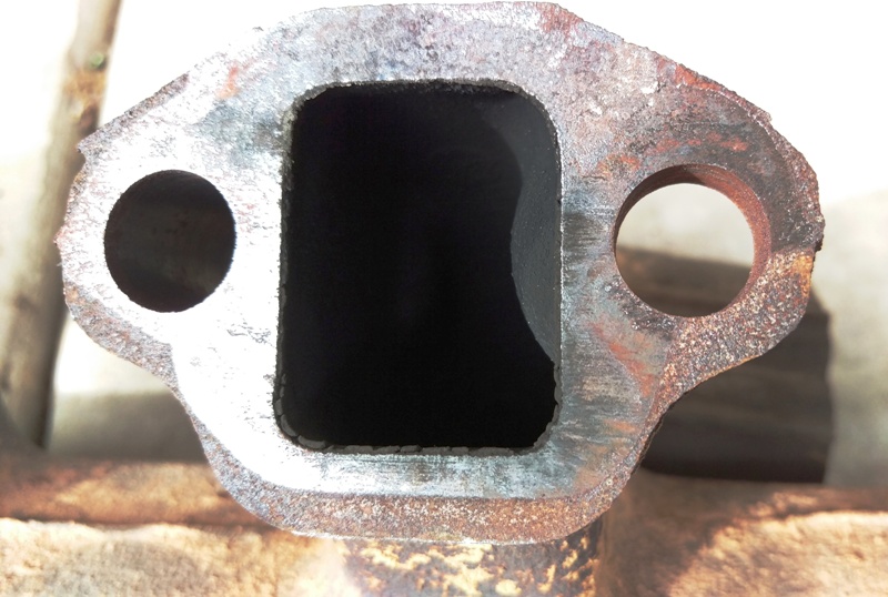

The outlet of the cast iron manifold is a whopping 1.75" diameter!
denhabr
Posts: 136
Joined: Thu Dec 10, 2009 9:56 pm
Bronco Info: '96 XL 5.0L/E4OD "Autofab" Preunnner/Chase Truck by Utah's Ojive Industries & dp custom fab
Location: Sandy, Utah, USA
Post by denhabr »
...here is a close-up of the 1.75" outlet in the stock manifold...
Ford Bronco Exhaust Manifolds 10-25-2015 (9).jpg (166.86 KiB) Viewed 3540 times
Ford Bronco Exhaust Manifolds 10-25-2015 (10).jpg (175.95 KiB) Viewed 3540 times

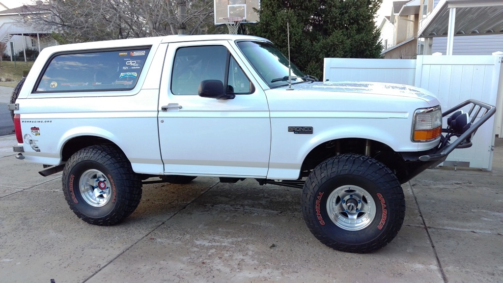

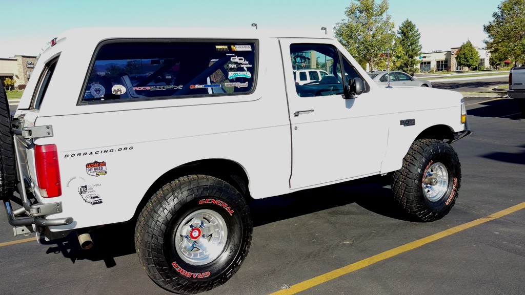

Re: Utah BroncoSpeed - Some Glamour Photos...
Post by denhabr »
Brad's Bronco October 2015 (1).jpg (155.29 KiB) Viewed 3537 times
Brad's Bronco October 2015 (2).jpg (129.27 KiB) Viewed 3537 times
Brad's Bronco October 2015 (3).jpg (166.82 KiB) Viewed 3537 times
Brad's Bronco October 2015 (4).jpg (174.5 KiB) Viewed 3537 times

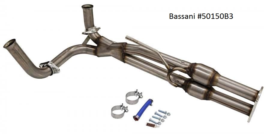

Bronco is looking great! I highly suggest jumping on the Y pipe from Bassani as well, it works fantastic!
Bassani 58150BC.JPG (81.6 KiB) Viewed 3460 times

Re: Utah BroncoSpeed - Bassani Header Feedback...
Post by denhabr »
Nick wrote:Great upgrades. The truck is looking great, Brad!
Thanks Nick!
SteveG wrote:I love it, Brad. Great upgrades! I considered 6x9's in my Explorer when I replaced the stock speakers but didn't feel like cutting up the door panel. I bet they're a huge improvement, though.
Thanks Steve! 6x9's are a huge improvement indeed (and being 3-ways helps a lot too)...especially in the clarity of the music. That and the amplifier just made a huge difference. Of course, the new quiet interior with all of the sound-proofing and carpeting was a big upgrade too! :mrgreen:
tcm glx wrote:Brad,
Hey Tony, thanks. I REALLY want an upgraded Y-pipe, but Bassani doesn't have one specific to the 5.0 engine for the '96 MY. :cry: Bassani has the #50150B5 after-cat system, but I already have a 3" system after the second converter. However, Magnaflow does have a Y-Pipe...#93342 pictured below (around $378.00 from various web suppliers)...which is still a 2-Cat (inline) set-up. Not sure if I'll gain anything, but it is all stainless steel! Thoughts?
Magnaflow #93324 (Drawing 800x600).jpg (37.91 KiB) Viewed 3444 times
Magnaflow #93324 (New Angle).jpg (12.54 KiB) Viewed 3444 times
1Hondalover wrote:
denhabr wrote:After purchasing the Bassani #50150BC headers and then hanging them in my garage for the last 3.5 years :cry: ...just "waiting for the right day..." I finally got them installed by my local Master Muffler shop, and their top technician/fabricator Don. They went on fairly easily, but they encountered some minor challenges during the process.
Looks like you have some nice upgrades going on there. I think we're going to saddle up a set of Bassani's with a Y pipe shortly, but I'm concerned about the header clearance for reasons you discuss plus the non-OE things we have going on. I like this picture.....any chance I could get you to take a shot of each side straight down from the top so I can see how they look protruding off the heads? If it's OK I may ask for a measurement or two after I see the pics. Of course if any of the other GFB crew have such info I'd be happy to see it. Appreciated.....thank you.
Thanks 1Hondalover. Be happy to take some photos...the best I can from the top down. I'm on a business trip to Ohio this week, but I'll try to get a shot this weekend when I get home. Hopefully that will help you. Note that it's tight on the passenger side (due to the protruding A/C housing), but I'll do my best.

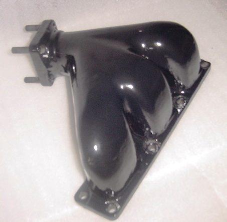

Before I bought the Bassani headers, I was actually debating taking the cast iron manifolds off, sand blasting them, perform some minor porting and clean-up, smoothing the outside cast finish, and then having them HPC coated (they're right near me here in Sandy, Utah), or painted with VHT 'Flame-Proof' 1300-2000 Degree F Silica Ceramic paint (rattle-can.)...with the intended effect of marginally better flowing manifolds, improving their overall appearance (see picture below of smoothed and coated Chevy rams-horn exhaust manifolds...), and keeping the no-maintenance nature of the OEM cast iron!
Smoothed and Coated Chevy Rams Horn Exhaust Manifolds.jpg (105.58 KiB) Viewed 3444 times
Exhaust Manifold - Porecelain Enamel Coating 2.jpg (48.38 KiB) Viewed 3444 times
Exhaust Manifold - Porecelain Enamel Coating 3.jpg (44.03 KiB) Viewed 3444 times
Regardless, good luck with your project!

About the Y pipe from Bassani. I do believe they make one specific to your 5.0 (Part #: 50150B3/150500) for '95 which just requires you to add another O2 bung (or two) along the way. I think this is the route taken by most with the same model year. Autoanything.com has for around 425 bucks. I've considered this route for myself but may look into the Magnaflow option as well. I've always like what they do.
denhabr
Posts: 136
Post by denhabr »
tcm glx wrote:So here are my two cents Brad. I noticed a decent (read minor) seat of the pants upgrade with the basani headers. Flowed better, ran nicely. I noticed a BIG improvement when I swapped over to the y pipe. 3" all the way through and she feels healthy!! A good friend of mine did the magnalfow and he also likes it a lot, so that may be the way to go.
Tony...good info and feedback, thanks. I honestly haven't felt anything "seat of the pants"-wise with the Bassanis as I probably haven't fully completed the OBDII drive cycle...where the computer has learned how to handle the headers. In due time I guess. 3" is a HUGE increase in primary Y-pipe diameter...but then again you have the 351w. I remember when I talked my Dad into putting true dual exhaust with "Turbo" mufflers on our family's '72 Buick Centurion Sedan with the 455 and 4bbl 'Quadratoilet' carb (back in '76 when "Turbo" mufflers were all the rage.) We upgraded the entire system to 2-1/4" pipe the entire way and that was probably more that enough. Oh, and it sounded awesome! I do like that Magnaflow #93324 as it mimics the stock configuration (inline cats), but unfortunately retains the 2" primaries going from the headers to the first catalytic converter. 96UAV below has an idea too...decisions decisions! :roll:
96UAV wrote:Great build Brad! At least I'm not the only one who has seemingly waited years to start their bronco build. Im just getting around to mine as well. Better late than never I guess. About the Y pipe from Bassani. I do believe they make one specific to your 5.0 (Part #: 50150B3/150500) for '95 which just requires you to add another O2 bung (or two) along the way. I think this is the route taken by most with the same model year. Autoanything.com has for around 425 bucks. I've considered this route for myself but may look into the Magnaflow option as well. I've always like what they do.
Thanks 96UAV. That #50150B3 is quite the departure from the stock configuration! Agreed...I'd have to install bungs in the downpipes, and another O2 bung after each of the two individual parallel cats. Not sure how that would work since I only have a single O2 sensor after my second inline cat. Do folks "Y" the two outlets back into one and then feed that to a single muffler? Hmmmm. :?
Bassani 50150B3 Y-Pipe '95 Bronco.jpg (52.08 KiB) Viewed 3338 times
I found that latemodelperformance.com is selling the #50150B3 (http://www.lmperformance.com/25522?gcli ... Atwt8P8HAQ)for $379 and free shipping too! But the shop that does my emissions inspections (usually they never open the hood to perform a visual since it's OBDII, so they just hook up their computer to my OBD port) may say something about this type of change over...not sure. But hey, it still, "has two catalytic converters," right? It's just that they're parallel and not serial. 8-) Again, decisions decisions!

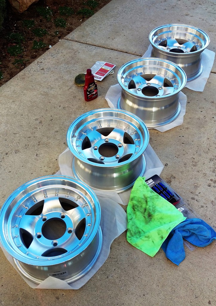

Just spent some buckaroos on new wheels and tires for the Utah Broncospeed!
  • American Racing AR-23 wheels (4), #AR235885, 15" X 8", 5 ON 5.5, from Jack's Discount Wheels (and Free Lugs!) on Amazon.com for $91.50/wheel...and free shipping...and free standard chrome lug nuts (which I did not use)
  • General Grabber Red Letters...35x12.50-15, $189/ea plus all the other 'fees'
  • Wheelmate #33004U Monster Open End Lug Nut (Set of 20) 1/2-20 Thread BLUE
Pics attached! Can't wait to get these off road and try them out!
Ohhh...and I'm going to the Off Road Expo in Pomona this weekend too! Woo-Hoo! Flying down to Burbank in the AM with the better half, hitting Universal studios on Friday, and the ORE on Saturday!
Next update will be on my ham radio installation that I did back in August!
73's...
KF6PSL
The AR-23's, all waxed up and ready for mounting!
Just before the change...
New socks & shoes!
New socks & shoes!
New socks & shoes!
New socks & shoes!
Close-up of the AR-23s with the Monster Lug lug nuts in blue...

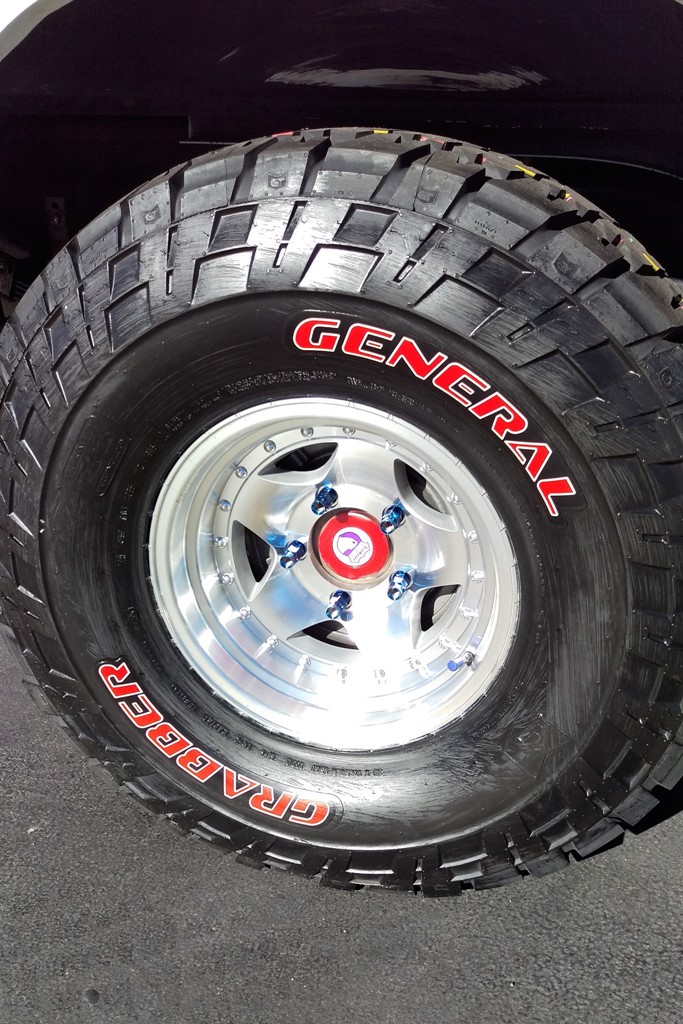

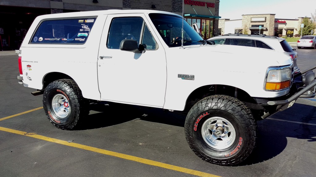

Just washed and photos taken of my new'ish AR23 wheels and General Red Letters, 35x12.50R15...
96 Broncospeed New Generals & AR23s (4) Smaller.jpg (241.38 KiB) Viewed 2878 times
96 Broncospeed New Generals & AR23s (2) (smaller).jpg (298.32 KiB) Viewed 2878 times
Now I need to go get it dirty!
