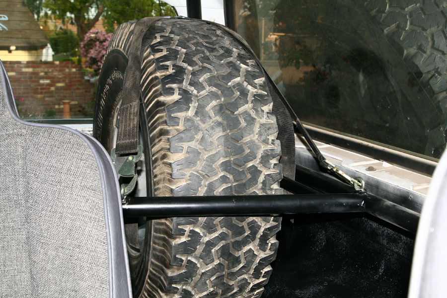

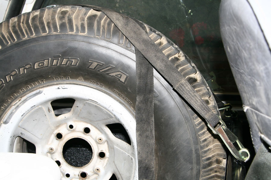

tcm glx wrote:Randy, looking great man!!! Super nice. Any pics of the rear cargo area setup, looks like you built a spot for everything. Curious to see what you did for the tire to stay in place, etc etc
Tony heres a few shots of how i mounted up the spare tire. This was solo bobbys idea and im glad we went this route, its super sturdy and doesnt take up much cargo space!
Re: Randy's 93
Awesome, thanks Randy.
Did Bobby do the cage? How did he come through the dash?
Re: Randy's 93
Do you think there is enough room to mount it
To the left of the cooler underneath the tire hook?

tcm glx wrote:Awesome, thanks Randy.
No we did it over at my other buddies shop RT Factory with Jason Rivera and Loco. We did all the major cage work over there because i dont have a bender then i brought it home and welded everything up and did all the straight bar work. We notched the dash on both sides of the A pillar and went down and tied in to the frame. We built a custom steering column mount and removed the gigantic original mount. The crossbar behind the dash was radius bent just like the eyebrow to keep it tight. Ill see if i can find some pictures with the dash off. I had to notch some of the ducting for clearance and sealed the notch with beer cans, rivets and duct tape LOL sounds funny but it worked out great!

D1cker1 wrote:Do you think there is enough room to mount it
It would be a tight fit but it just might work. I dont know if it would clear with a 35" spare though. I hoping to switch to 35's this year.
