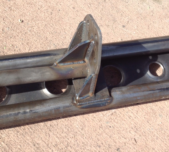

Rear Bumper....
Here is my rear bumper all finished up. Kinda robbed ideas from a bunch of you guys do thanks :-) They say no one has an original thought -- that may or may not be true Anyway thanks- Yikes, Kelfab and Threat and some of my own inspiration -- LOL!!! I was going for tubular, something that protect the corners in a parking lot and if I did have to tow something the chains/wiring plug actually have something to hook to. The plug mount is just the stock piece butchered up an welded on to the back support bar.
