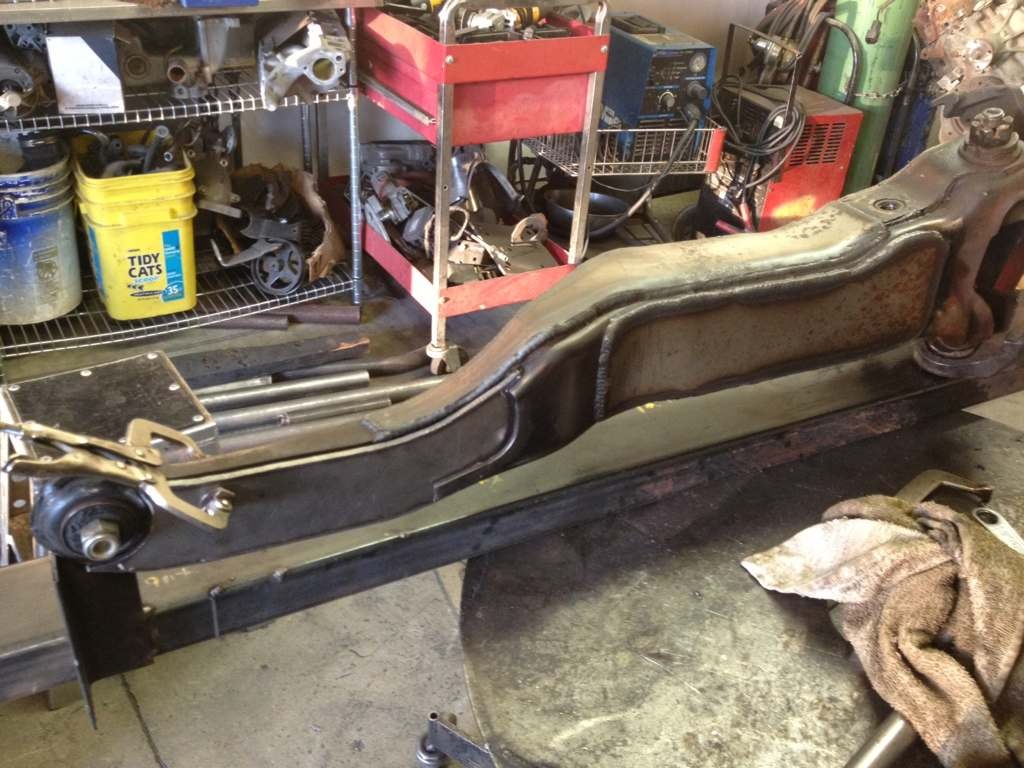

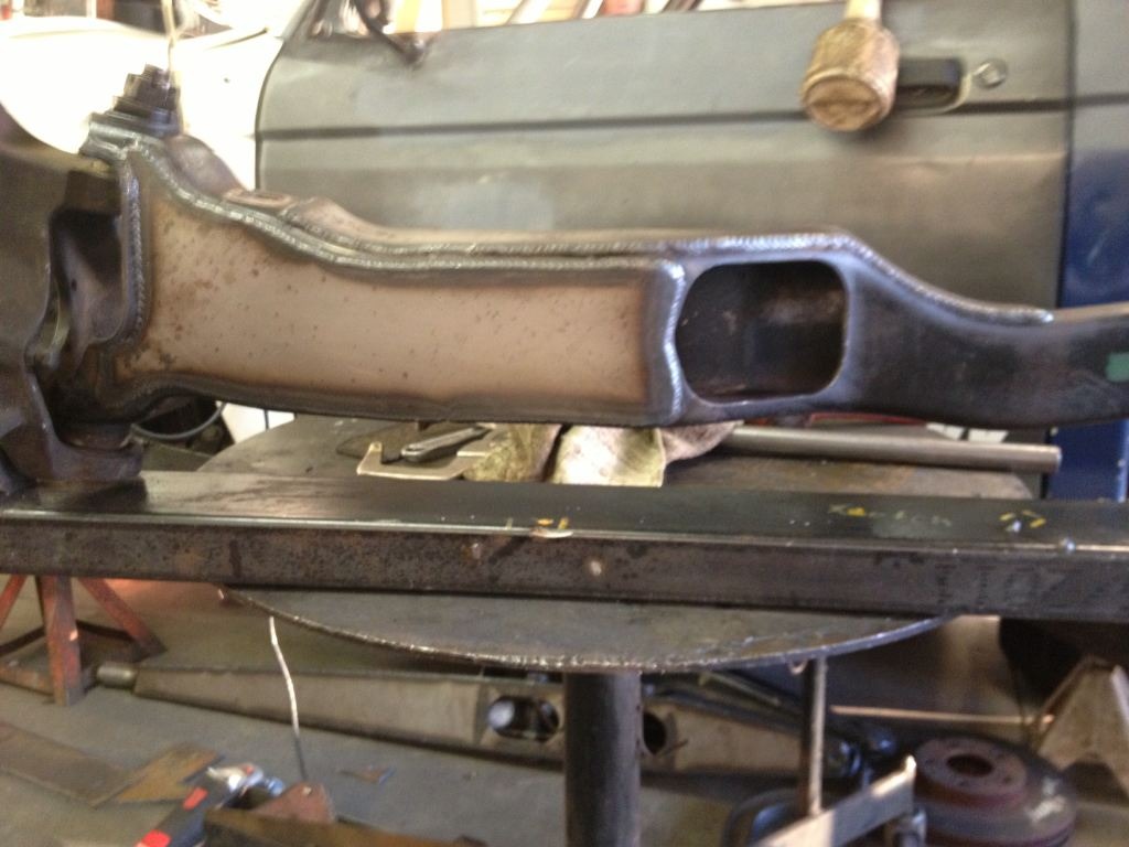

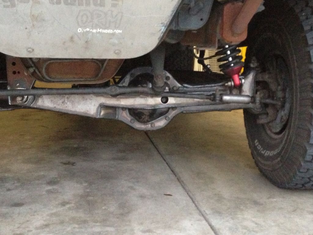

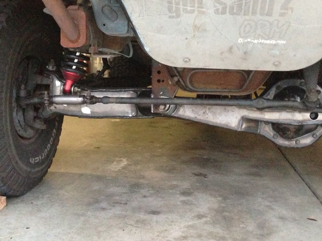

Ok so here's my little update. Got my beams done finally. I'm really happy with how well they turned out.
I have to thank Dustyn for coming through. He's an awesome fabricator and I could never afford these if I had to purchase from a bigger shop.
Next upgrade is steering.
Ok pics.....
Hope the pics aren't huge. Every time I pick "best" with tapatalk it seems like it gives me a different size every time.

Re: Jose's 94
are they just plated?..

@ Andy they are 4 over.
