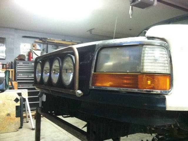

Re: 95 Bronco Build!
Beams are off, planning a bumper/ light rack.
Sumfin ain't right
Damn! Looks like some uniballs are in order Travis.

Travisfab wrote:Sumfin ain't right
Extra droop!
