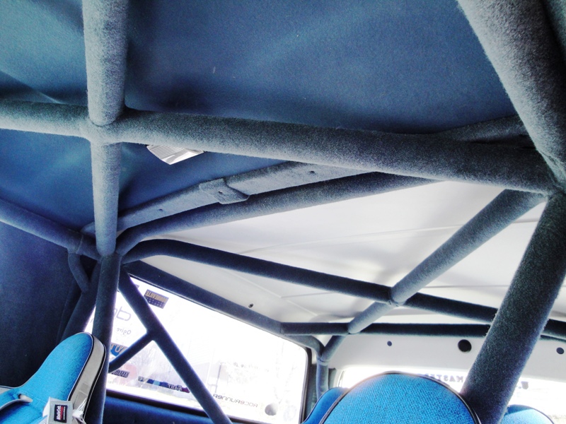

I thought I'd provide an update on my latest enhancement...a brand new interior! Something I've been wanting to do since I got the Bronco out of the fab shop back in February of 2010....and now it's done. Gone are: the 6 open holes/gaps in the floor where the safety cage tubing passes through...the bare floor covered with the OEM rubber mat...the heat and dust that floated up through the holes...and the NOISE! Ugh...the noise! It drove my family and I nuts driving out west to Nevada to watch the BOR Wendover 300!
So, here is what I spec'd for the interior re-do:
  • Remove all OEM rubber matting
  • Thoroughly clean the bare metal floor
  • Apply rust preventative to all floor surfaces and underside of floor deck
  • Seal/close all open holes in floor (especially where the safety cage passes through) using flexible foam sealant/rubber grommets
  • Apply spray on bed-liner to treated metal floor surfaces
  • Apply thermal/noise barrier to top of bed-liner surface
  • Top with heavy duty automotive carpeting, front to rear
  • Clean, treat, and wrap all interior safety cage tubing
  • Cover the rear interior quarter panels with the covering similar to the safety cage wrap

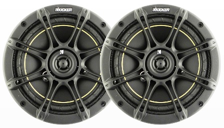

  • Remove and replace the factory OEM speakers with new Kicker DS65 2-way 6.75" (F) and DS693 3-way 6x9 (R) speakers
I did a lot or research and selected a local Salt Lake City interior shop by the name of The Seat Cover Factory. They did exactly that for $2,200 plus tax (and more...a new headliner, carpeting of the tailgate access cover at no extra cost...) Sure, it took a month a half, but well worth the wait!
I can now carry on a normal conversation, and even talk on my cell without issue...and it's almost too quiet now! But it was all very much worth it! No noise, no heat/cold, and no more dust...and it's all sealed up now with the appropriate preventative coatings so I no longer need to worry about corrosion. Phew!
Enjoy the pictures...

Rear Seat Floor and Quarter Panel Detail
Bronco New Interior - March 2014 (2).JPG (185.42 KiB) Viewed 2627 times
Main Safety Cage Padding Detail
Bronco New Interior - March 2014 (3).JPG (213.67 KiB) Viewed 2627 times
F Headliner & Safety Cage Detail
Bronco New Interior - March 2014 (4).JPG (193.6 KiB) Viewed 2627 times
Interior Rear Floor Detail
Bronco New Interior - March 2014 (5).JPG (220 KiB) Viewed 2627 times
Interior Roof from Tailgate - Safety Cage Detail
Bronco New Interior - March 2014 (6).JPG (197.59 KiB) Viewed 2627 times
R Rear Interior Quarter Panel
Bronco New Interior - March 2014 (7).JPG (218.8 KiB) Viewed 2627 times

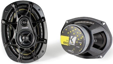

Actually the rear Kicker 6x9's sound like crap with the factory radio...so they're be augmented soon with a nice Kicker amp (4x50w? 4x75w?), and a nice new head unit to replace the OEM AM/FM head unit...
Kicker DS693 6x9" 3-ways for the Rear Quarter Panels (Stock Location)
Kicker DS693 6x9 3-way 3 (small 2).jpg (28.68 KiB) Viewed 2625 times
Kicker DS65 6.5" 2-ways for the F Doors
Kicker DS650 6.5 2-way (small).jpg (52.36 KiB) Viewed 2625 times

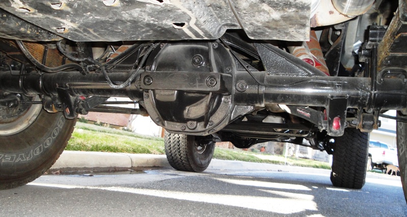

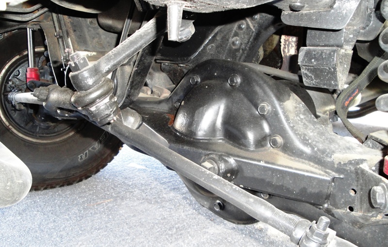

A few years ago, I got tired at looking at an orange (read: rust) undercarriage, and took my Bronco to a local big rig detailing shop, Air Vision, here in Salt Lake City. Air Vision's specialty is cleaning, washing, and detailing big rig trucks, and one of the their feature treatments is painting the undercarriage. They were also the folks that hand polished up my Ford 10-Hole 15x7.5 "riveted" (Hollander 1701) aluminum wheels that are currently on the truck!
I had this done to my Bronco back in November of 2012...and the results were pretty nice. They pressure washed the entire underside, and then masked off a lot of the parts I DIDN'T want painted. They then applied their gloss black high build (read: thick) paint treatment...which turned out pretty good. My only complaint is that they painted the nice aluminum Ford Motorsport 8.8" rear diff cover BLACK! Grrrr...even after I told them NOT to. Sheesh. :roll:
But at least everything is protected from future snow and salt (except the Race-Runner shocks, which look all corroded and fugly on the outside now...Hmmmm?)
So, now I'm all caught up on project work...and as I mentioned before, a dual remote oil filter system is next for the 5.0 next month or July...
Ford Trussed 8.8 (and painted FMS Diff Cover...) (1)
Bronco Undercarriage Paint - 2012 (1).JPG (179.77 KiB) Viewed 2623 times
Ford Trussed 8.8 (and painted FMS Diff Cover...) (2)
Bronco Undercarriage Paint - 2012 (2).JPG (175.88 KiB) Viewed 2623 times

D44 TTB
D44 TTB
Bronco Undercarriage Paint - 2012 (4).JPG (202.82 KiB) Viewed 2623 times
