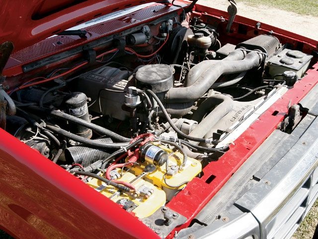

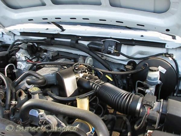

I should start this post with I don't know what I am looking at. A friend looked at my Bronco and said it is MAF. This truck is showing late 94 production. it is OBD1 and does not have the c02 sensors after the cats. Were there any 95 Broncos (5.8l) that were MAF. If I post an engine pic would that help?
Posts: 6026
Re: 95 XL hunting truck
Maf
Posts: 6026
Speed density

My truck is MAF. Thanks for posting the pics.
Posts: 6026
What's your question? There was obd1 and obd2 maf engines.
