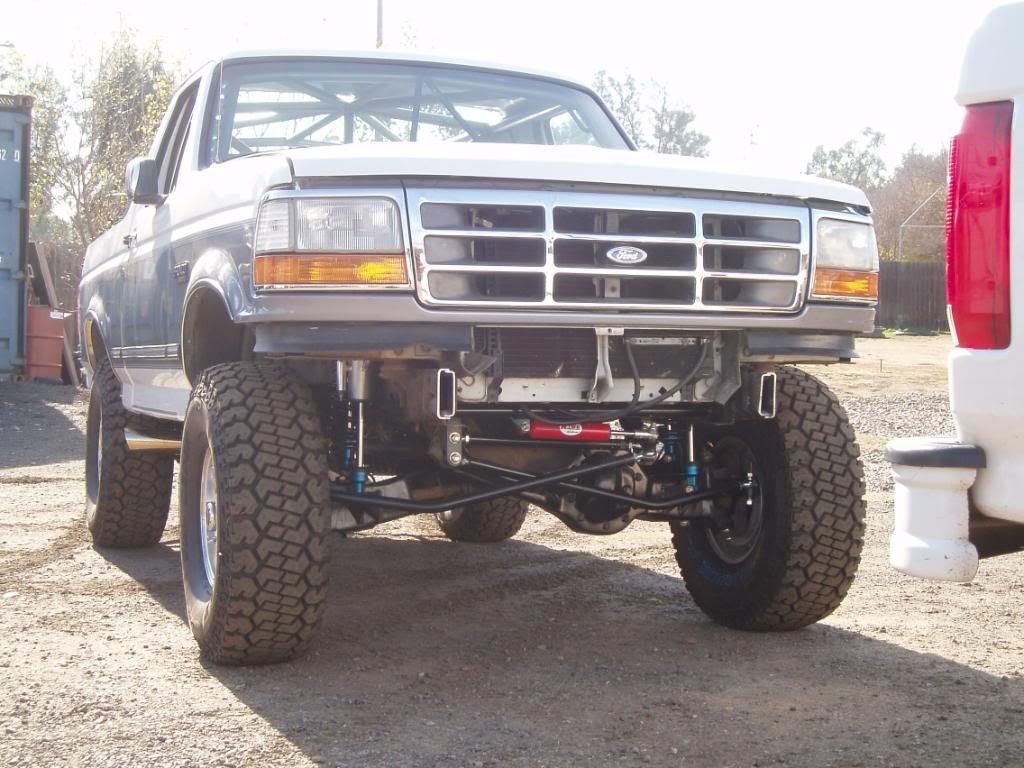

guys help me out here... who did a howe ram assist on their rig??? I cant remember whos bronco that was..
- Posts: 6026
Re: 1986 351w Go Fast Beater Bronco
I've seen the Howe ram on this build, whoever did it. I thought it was the handy work of southwest but I have no idea who's it is or who did the steering set up.
- image.jpg (222.75 KiB) Viewed 1440 times
- image.jpg (249.96 KiB) Viewed 1440 times
- Posts: 6026
Is that what you were looking for?
- Posts: 4610
Mark built it all. I saw it in person. Nice setup.

Yes exactly! thank you! I havent been able to find any info regarding anyone else that has done this... with 37's I want to reduce wear on the balljoints and the stock ford box. although the box is new... that damn set screw worries me and ive destroyed them before... pro-active thinking.
I already have a leftover servo and quickener from an old project... this is totally farfetched ...and in lieu of being unequal length... it would be awesome to run a mildly ported oem pwr steer pump plumbed to a servo and a fully hydraulic rack.... comparatively, with as much as tommy lee costs... or an investment in a nice psc or howe saginaw box.... it doesnt seem too terribly expensive to go the route mentioned above.... but the whole unequal pivot thing... the rack would have to be mounted off center with a big drop mount, pillow block and extra linkage junctions from the steering shaft etc... just day dreaming here....

what did he do to the box to accept the ram assist?
- Posts: 4610
However did the box and pump. Iirc the box is tapped but I could be wrong. How's has done quite a few box and pumps with ram assist for broncos and f159s.
