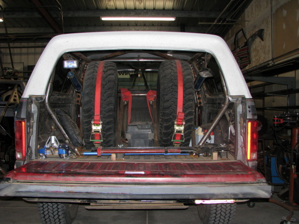

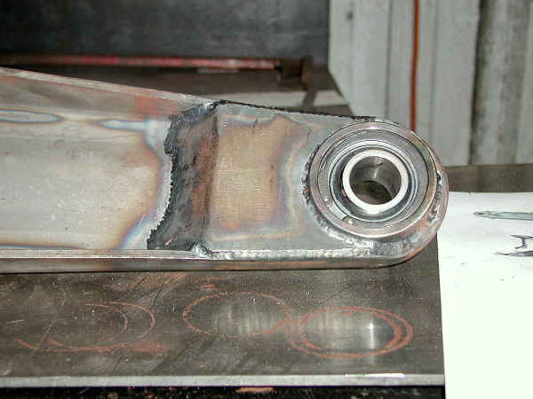

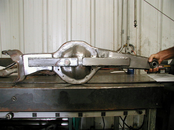

More build pics; dash
Picture 026.jpg (161.86 KiB) Viewed 6104 times
Picture 027.jpg (135.72 KiB) Viewed 6104 times
Picture 034.jpg (170.4 KiB) Viewed 6104 times
gunit
Posts: 340
Re: Dave's 1980 prerunner
Post by gunit »
Picture 041.jpg (175.6 KiB) Viewed 6103 times
Picture 040.jpg (195.32 KiB) Viewed 6103 times
Picture 013.jpg (188.57 KiB) Viewed 6103 times
gunit
Posts: 340
Post by gunit »
Picture 001.jpg (212.54 KiB) Viewed 6102 times
gunit
Posts: 340
Post by gunit »
Picture 032.jpg (156.99 KiB) Viewed 6101 times
Picture 037.jpg (160.49 KiB) Viewed 6101 times
gunit
Posts: 340
Post by gunit »
There have been many changes and improvements since many of these pics were taken.
I consider my build successful as my goal was to create a reliable Baja prerunner and I have put more than 6000 Baja prerun miles on it in the last three years.
