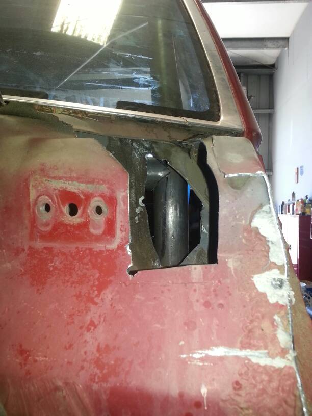

got some quality time in at shop last night, got B-Pillar Tacked to body for now, and bot A-pillars notched and tacked in!
A pillars tacked in.

Re: Project Double Trouble/Drew's Bronco
Right on!! A pillar tube looks nice and tight!! Are you planning to run a pontoon setup to the frame?

tcm glx wrote:Right on!! A pillar tube looks nice and tight!! Are you planning to run a pontoon setup to the frame?
yeah pontoon/rocksliders, plan on doing some wheeling with this thing too. the B-pillar land directly above the front spring hanger.

with the A-pillar going right there, will it take away that AC ducting behind the vent? only reason i ask is i have the exact same bronco as you and plan on caging it pretty soon, but wasnt sure if i wanted to go on the side of the dash or go behind it since i dont wanna mess with the AC ducting.

89bronco.jake wrote:with the A-pillar going right there, will it take away that AC ducting behind the vent? only reason i ask is i have the exact same bronco as you and plan on caging it pretty soon, but wasnt sure if i wanted to go on the side of the dash or go behind it since i dont wanna mess with the AC ducting.
So far just loosing defrost/mirror vents until I fab a new vent for it, the defrost tubes unbolts and you can snake the dash bar back there too, may have to heat up vents on passenger side, but shouldnt be too bad! Who needs defrost and mirror vents anyways

And if you get it tight enough to the body you don't have to move e brake at all, as it it right now e brake is staying in stock location

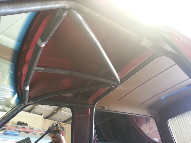

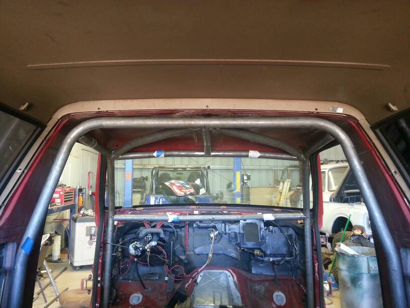

Got a good day in today at the shop, got a lot more done on cage going to fit a few more tubes then I will be moving onto front suspension.

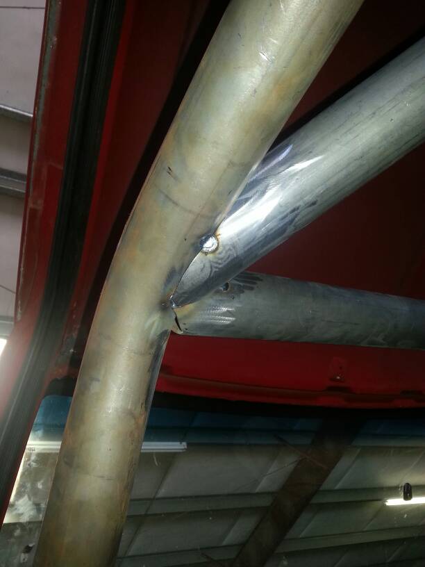

Fitted a few more tubes today, Also cut holes in firewall for engine cage to cab cage tie ins

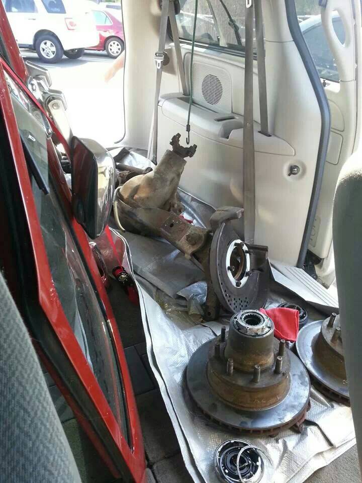

Picked up some good parts today, made a loop around northern ca to pick up stuffs!
Pit stop 1!
Pit stop 2

i will be using the dana 44 beams and extending with the outers of dana 50's, then plating and a truss, using dana 50 third memeber and extended axles

Pallet O ttb, sock picked up another complete set of Dana 50 ttbs, gotta get another truck out of the shop before I can get bronco up on stands and start on the beams/engine cage

So I have been getting cage work finished up! Starting front suspension soon! Picked up this guy today as a second car! DD family wagon. Super clean and low miles! Super stoked! Gonna be shreding this thing to Pismo for huckfest! If y'all see me stop by and say howdy!

What are you going to do for your E Brake and Steering Column support?
drewbee88
Posts: 502
Location: Modesto, CA
Post by drewbee88 »
Tube slides in between cab and e-brake, so ebrake bolts up just as it did before no modification needed
