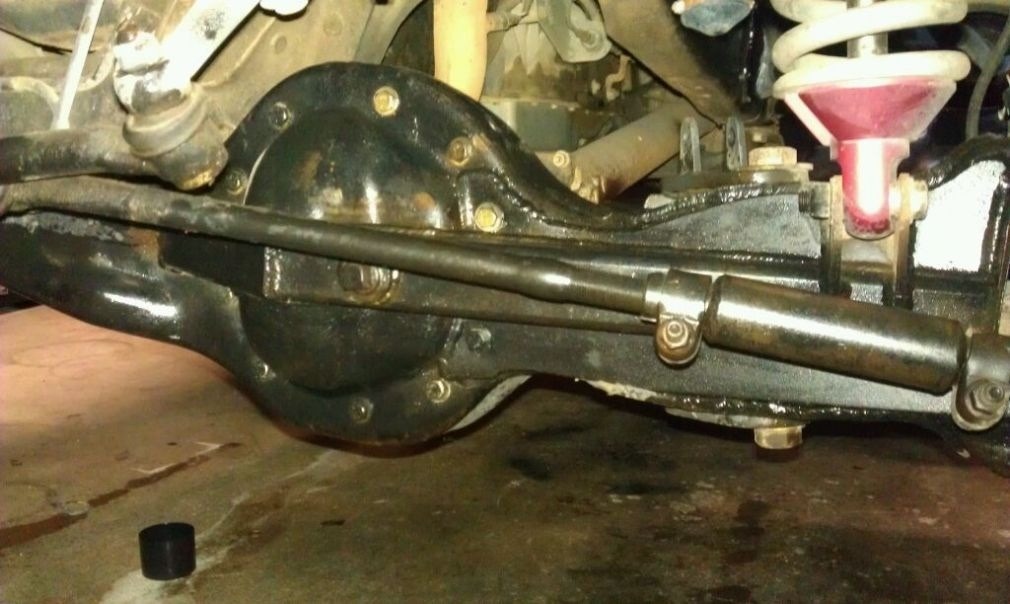

Ehhh cool to see you think outside the box? I do understand where Andy is coming from though.... Not a very thought out truss design but I'm sure it will work....greaslife wrote: Got my beams all plated and trussed up. Now time too get her back on the ground. More updates later

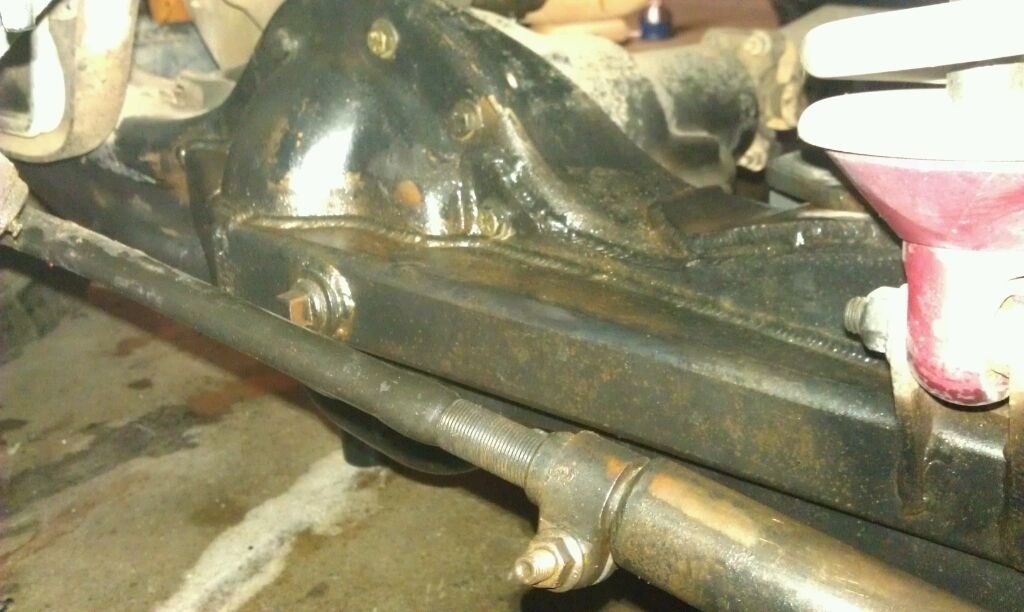

Be honest, If this is going to be measured with the standards of a "GoFast" trussed beam, its not a total loss but there are issues. Nobody wants drama, I get it, but besides the dudes jumping on Andy's lack of fab jpg.s, there's not much reason to defend the truss method.
And the drain plug access mentioned... on another fab note entirely, it's risky to cut it off after the full burn welding.
the purpose of a truss is to increase rigidity and distribute or disperse the load paths of force on the beam. this "truss" is not really adequate in length, shape or construction to add much benefit at all. That plate's rigidity is severely diminished because of how wide it is and how much of it is only one sided, just over lapping. The actual three sided portions are short and the face is pretty wide for how long it is. I bend plate like that by hand with NO tools or gloves in my soft jaw vice
Depending upon the material length and thickness, the truss needs to extend a certain distance (being 3 sided) to offer the intended benefit.
