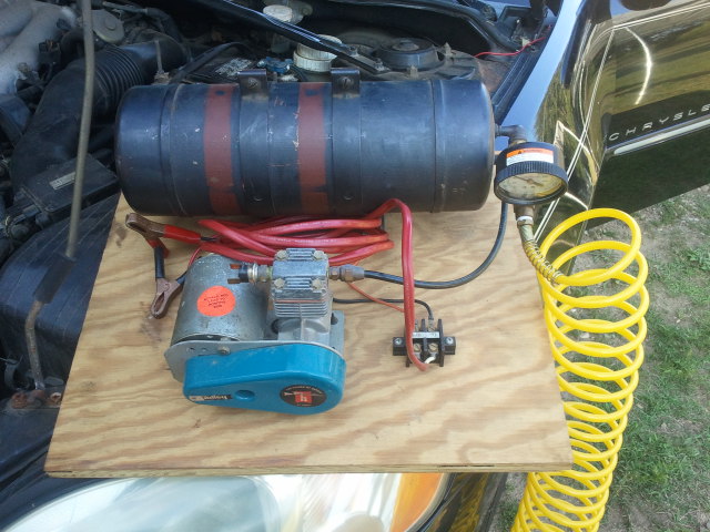

On board air? Have my quick fix. Going to run air horns as well since this system is really only meant for it but for now it works to air up tires as well.
Compressor and tank
Compressor and tank
2012-07-22 19.12.43.jpg (100.73 KiB) Viewed 2688 times
"Stroke it, blow it, and spray it. It will be a short ride, but it sure would be a blast."
