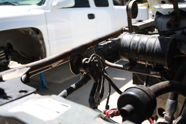

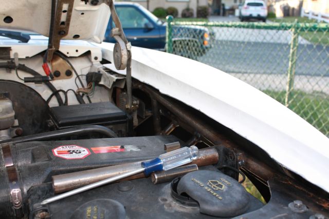

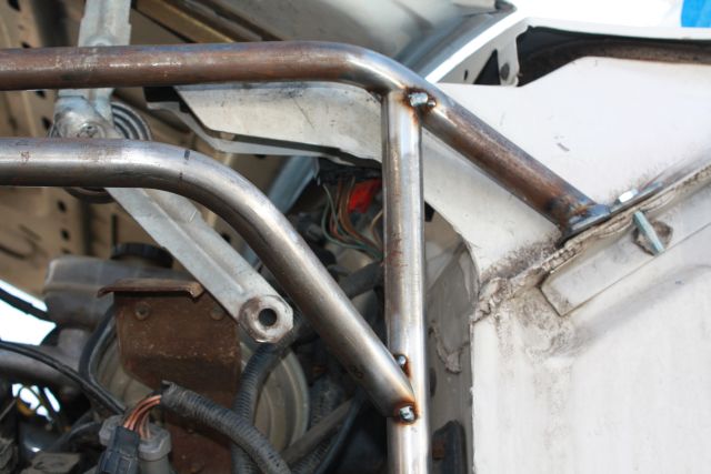

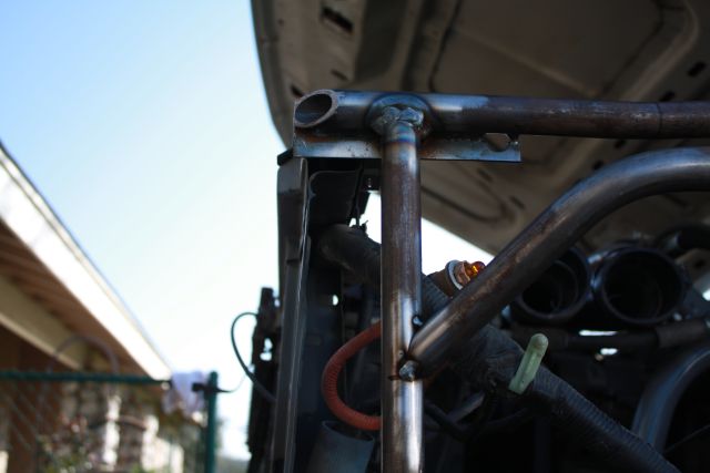

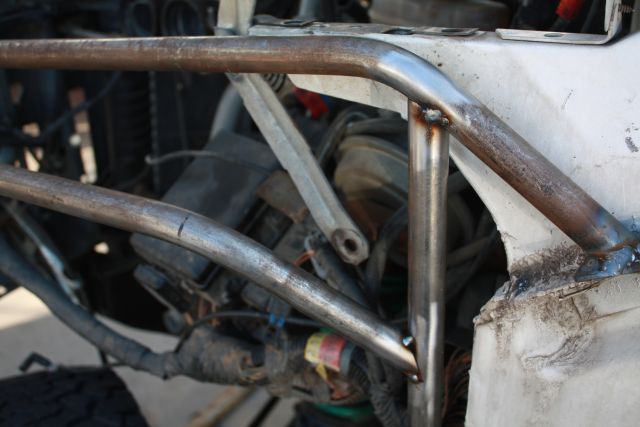

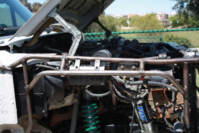

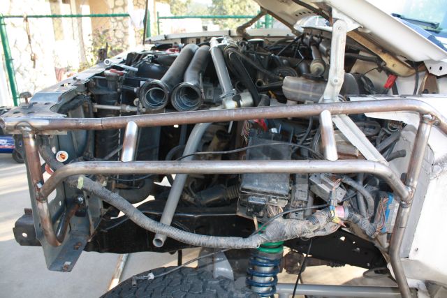

I have an up date. Got my front fenders mounted finally. It took me a while to think it through, but what i needed to do was just start. So that is what I did. I started with a inner core support to mount everything to and strengthin the front clip.

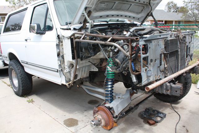

Next is the rear panels and i picked up a new hood to install as well. I have to break it all down one more time to paint. I will probably fab up some sort of inner fender liner to try and keep out some of the trail from coming in. I took it out on Sunday behind my house and she did really well. Finally got to see how the front performs. I diffidently need to do the rear.

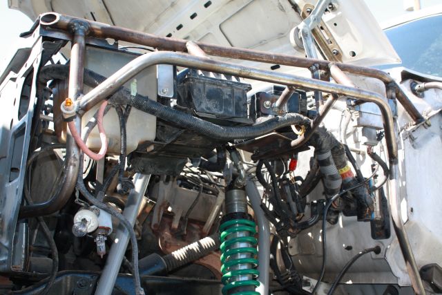

That looks really nice! I like the way you're using the core support/fender supports to mount your accessories under the hood. It really cleans things up and makes it nice to get stuff up and out of the way!

BajaF250 wrote:Hey Brian,
Thanks, BajaF250. I liked the way John (Autofab) made his, so I used his idea and made my own. And I was able to get some of the things up a little higher to, for that added clearance. I have to take it apart one more time to paint it all.
