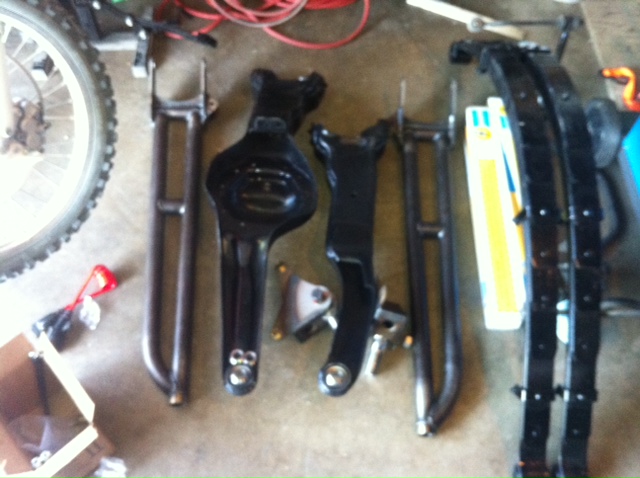

Ok so here it goes. This is my first Bronco, it is a father son project and these are the plans
Front:
Threat Motorsports billet cut and turned beams
Threat Motorsports tubular radius arms and pivot boxes
4' inch pro comp coils
King 2.5 coilover or bypasses not sure yet maybe some suggestions from you guys
will run the Bilstein 5100 in the front until I decide what to do.
Rear
Deaver F53 pack
home built rear upper shock mount
king 2.5 x 12 2 tube bypasses
General Grabbers
Just have to buy some odds and ends and I can start the build hopefully by next weekend.
Front:
Rear
Deaver F53 pack
General Grabbers

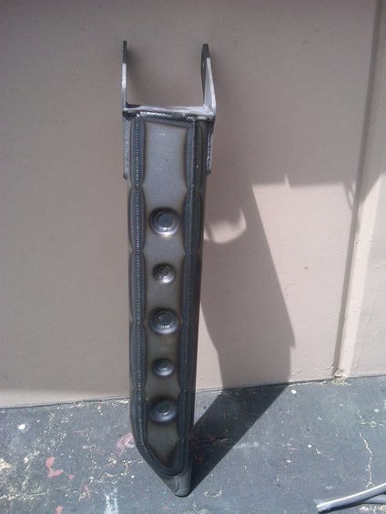

Why are those tube style radius arms so popular?
I know Dave makes some other style radius arms..
Solo makes some and I'm considering reinforcing the hole
So the radius arm looks a little more solid.

Tony,D1cker1 wrote:Why are those tube style radius arms so popular?

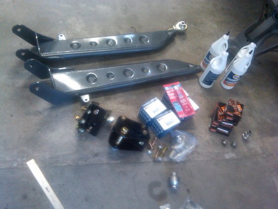

Solo plated mine. Here is a pic. They did a nice job on them:
But a couple of years ago I also had another set of Solo arms and I had my buddy John Evans plate them up. Here are some pics:

I personally like the tube style better. They look too bulky plated but my BTF's are going to replace my tube arms. I have BEAT my radius arms and they work fine......I think plating is not 100% required but what do I really know about fab. hahaha

I agree with you Andy. From my talks with Bobby at Solo, John Evans and the guys at Camburg, you don't need to plate the arms, they are plently strong as is. It's just a nice touch to the arms if that's the style you like.Silverslk wrote:I personally like the tube style better. They look too bulky plated but my BTF's are going to replace my tube arms. I have BEAT my radius arms and they work fine......I think plating is not 100% required but what do I really know about fab. hahaha
Chris
Re: David's 94 Bronco Build
It depends on how hard you really beat stuff. Tom's arms were tube & he bent them so he plated them. He drives a HEAVY truck like a beast though!
Personally I dig the new style arms Dave is doing.
The plating stops bending in a direction that was never an issue. The biggest issue is the arm rotating on the bolt it's attaches to the beam with.
That being said if the first radius arms I did had not of bent when I t boned that car in Vegas it would have sheared the radius mount or pushed the rail back. More work to fix.

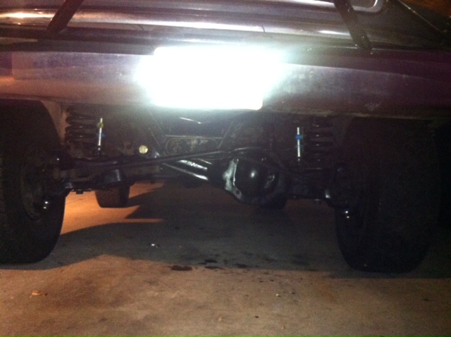

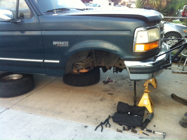

well guys I was gonna wait till next weekend to install my front kit..... but patience is a virtue I do not possess.
here are some pics of the bronco during it's transformation. and a couple all done. I only had a few problems, one I banged on the top ball joint castle nut to much and could not screw it off , so I had to cut it off.
Then I had to massage the beam pivot mounts to fit the uniballs. Also it seems the previous owner had 3 degree camber cams(way to much positive camber)so I need to get some 0 degree ones. Where's the best place you guys recommend getting these?
other than that it went pretty smooth.
next weekend the rear will get some attention.
