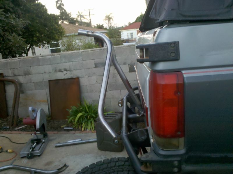

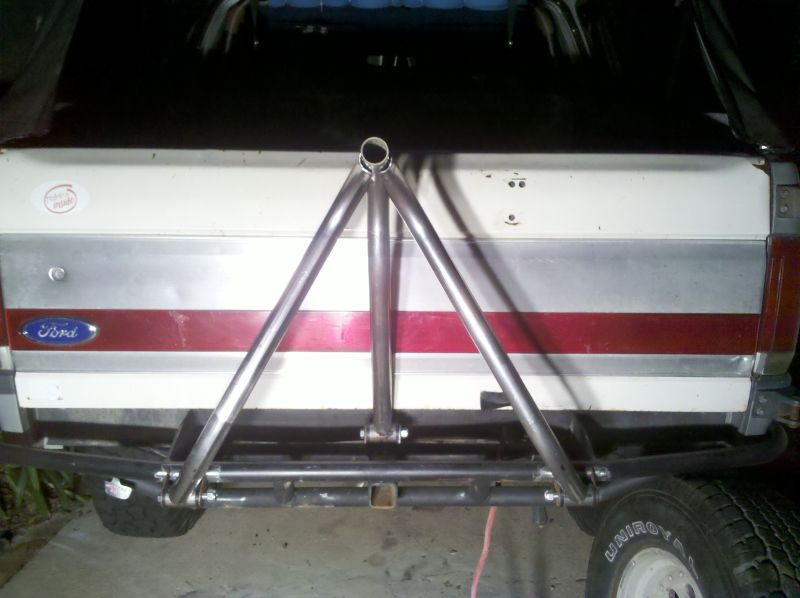

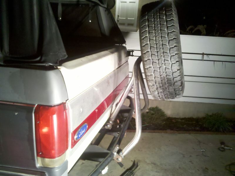

since than, i've built up a spare tire holder. this pivots down instead of to the ground. it needs some modifications as it's a bit too high and when it's dropped the tail gate hits the froward brace. i might just bend new tube, or find a way to make the forward link telescoping and allow clearence for the tail gate. a month or two i'll know what i want to do.
material is 1 3/4" .120 wall tubing (they were out of .095) strong as an ox! i went and tested it at ocotillo with no problems. in fact i think it's the only part of teh truck that doesn't move when hauling ass in the washes!

Rmc wrote:Just pull the center leg bolt I mean? Is that the plan?
yeah it drops right on down and pivots off the outer two legs. i had to put a knuckle in the middle of the center leg to help clear the tailgate. just pull the bolts and she's easy to drop. however, it's heavy to lift.
i don't have any photos at the moment of it down, but i'll throw some on tonight.
Re: two years and counting
Cool. Hey check McMaster Carr, they have all different sizes of pulling gas shocks sold in 50lb increments. If you find the right one lifting should be as easy as a 1 finger operation. They look like screen door cylinders on a house security door. It may make life easy. Looking good man.
