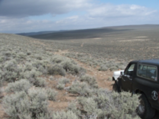

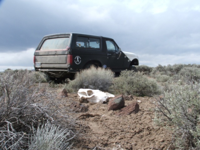

got back from a great trip to eastern oregon. got my rear shocks mounted thanks to Mike for sending my shafts and being so cool about me slacking on sending his parts back...
some of the roughest terrain that i have taken this bronco through. the only issue i hadwas the upper front shock mount had wobbled out a bit(single shear)
and added to musical melodey of all the bypass tubes and rear hiem noise.
160 dirt miles and 661 total miles. after all that i took the kids to school and went grocery shopping in it monday...
im waiting on my buddy's write up on our trip and i'll post it up in the event section....

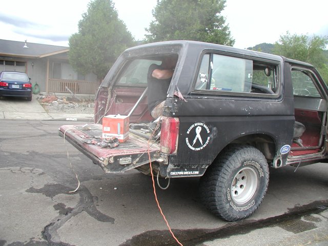

its been a while since i posted updates so i figured i would...did some more cage work,and some serious abuse this past weekend,
went to Paisley to work on the race course planning and while doing that, i drove this bronco like i was racing it a few times.in the dust full throttle using the gears in the c-6 and pounding the suspension. it rattled it self loose in alot places and i wobbled out one of my front shock mounts(yes single shear) BUT i drove home in it. i have a renewed love for this crappy looking cobbled together bronco.while out with Jaime's bronco and TL racings work of art linked bronco, it was fun.
i am no longer "ashamed" of some of the not upto net-fabbed dime stacked welds i have layed on my "hurry up and get it ready" parts i have made.
i no longer care what it looks like or what people think,i know what it can do and the scary fast capabilities of the work i have done.
it is time for me to give this thing a rest and give it some spa time and a vacation from abuse. next couple of weeks i am tearing the rear end out and re doing the whole rear suspension and finishing out the tube work.then saving up for new rear axles for the wider rearend and building a whole new front end.
i will have a few more pics of the stuff once i get unloaded and take a leaf blower to get the inch of silt out of the thing

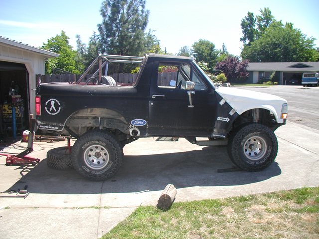

got my leafs installed, was not fun like it should be.....
grinder to the knuckle bone........
puncture to my tricept on my left arm,bled like was a stuck pig looked like someone got murdered in my garage.....
but after all that it is done,lol
i am going to be re doing my shock ounts and using a lever type arm and it is liimited to 17" right now due to my current shock mount. ride is a little stiff and i thought i would have a lot more body roll with the 2.5 springs but i dont so no 3 wheelies...
going to take it out and run the crap out of it weds.....
leafs are 61" 13leaf nationals, i had to move the front hanger and extend the shackles to get back to my disired ride hieght i will get more pics this week...

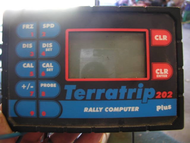

new toy for bronco, this should make course notes a breeze.
and good training for the one day i make it into rally
