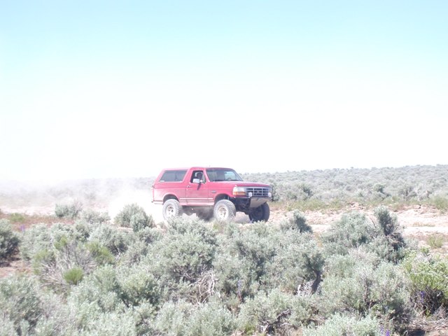

Re: Jaime's '95
i like this pic so i posted it.... had a great time your bronco is so nicely done.
- P1010280.JPG (69.31 KiB) Viewed 2496 times
