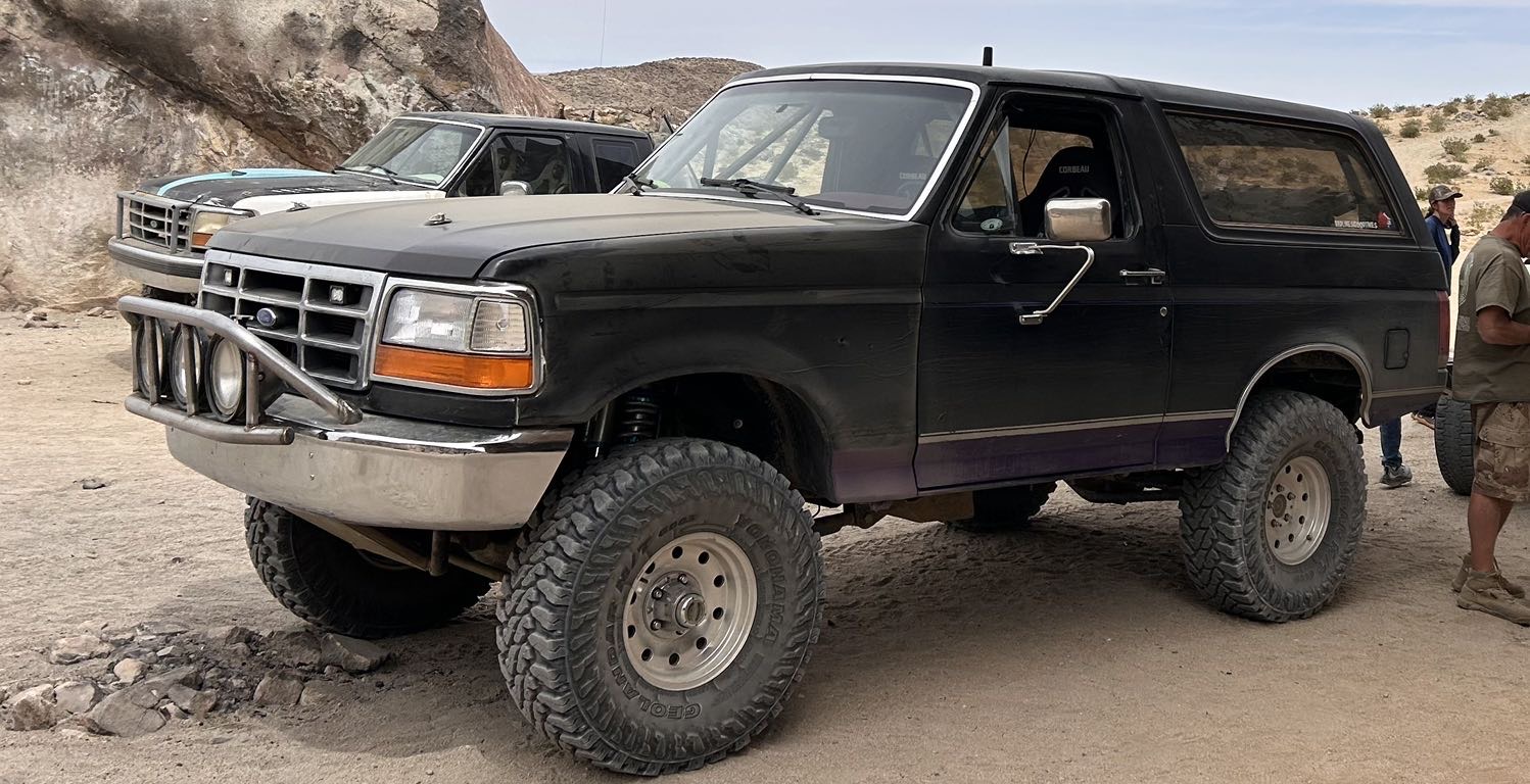

Lots and lots of progress on the bronco. I’ve actually got a few hundred dirt miles on it so far!
