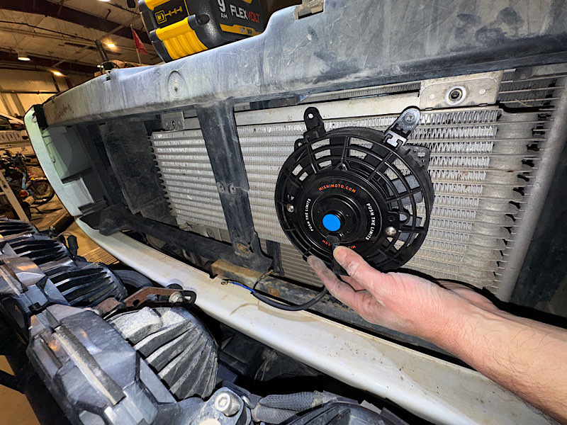

  • Install transmission cooler fans (I pulled Paul's fan years ago when we replaced the cooler)

I hear you on the electric fan. I'd love to get rid of it but I like the reliability of the mechanical. The only downside these days is that the properly functioning OEM clutches are becoming quite rare. And Motorcraft has gone to shite.

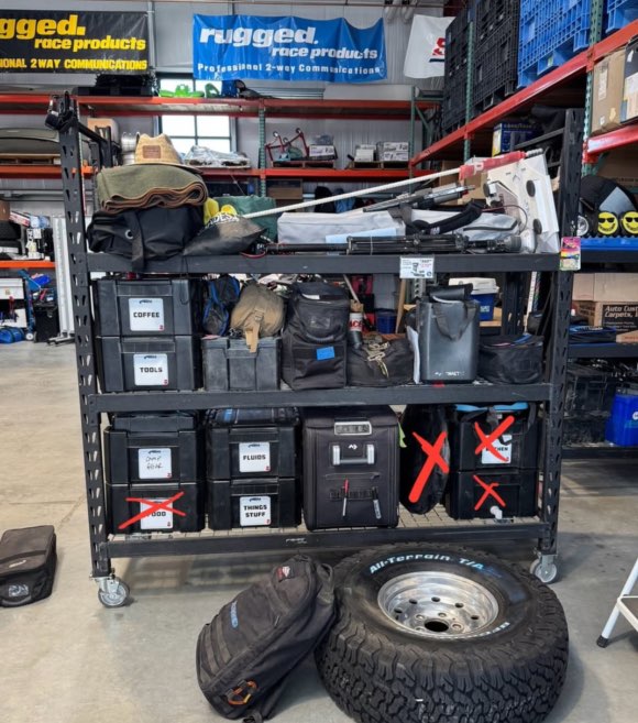

I have no problem adding weight for my comfort! Have you seen my load in? :lol: :lol: :lol:

Since you have more room it's likely worse than mine and I've been thinking to ditch the Q80's and go to a spring with better load carrying ability.
Re: Rugged Radios Stretched Bronco - Factory Race Support, Tacos, and Coffee!
KOH load out... minus the red X's

I noticed on my neighbor's Volvo OTR that it's cooling fan is mechanically driven, but has what looks like a seriously over-kill A/C compressor electric clutch coupling the fan to the pulley. Has anyone looked into clutches like that?

So happy to see this thread revived! Love the updates/changes you're doing to Wilson. Man that's a ton of stuff you carry!

Ha! Yes lots of stuff! This trip included camp gear which doesn’t usually stay in the car while on dirt but, still, A LOT of stuff. As you can see, I like to travel prepared… for trail fixes and to help others, which is almost always why gear comes out (knock on wood).

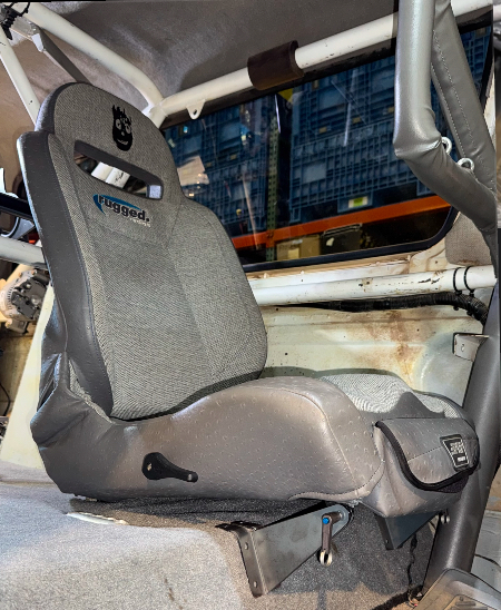

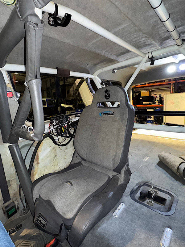

Rear buckets going in soon. The brackets are bigger than I'd like, but this makes for more comfortable sitting angle... much better than the bench as it's several inches lower and the back is reclined more. Leg space is a little tight but there's some wiggle room for sub 6-footers. The good news is that I'm not a 6-footer, and I've only ever sat in the back once. And I don't intend to make that a habit!
The rear bracket is going to be kind of a hook that the back of the seat slides into, then align the front and pin in place.
Both front and rear brackets will have body-mounted nut plates so that seats and brackets can be removed if desired... which will be rare. The only time I would do that is if we're camping out of the car, carrying a tent, bedding, camp kitchen, etc.
Next up is lining these dudes up and putting holes in the car... uuuuugh. I'm a big fan of eyeballing things, but there's a left and a right here, so I should probably spend the extra time to make sure everything is square and matches! :lol:

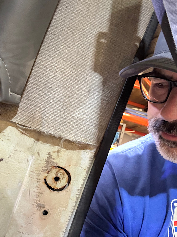

Paul, just curious what this almost hole was intended for. 😛😛😛
