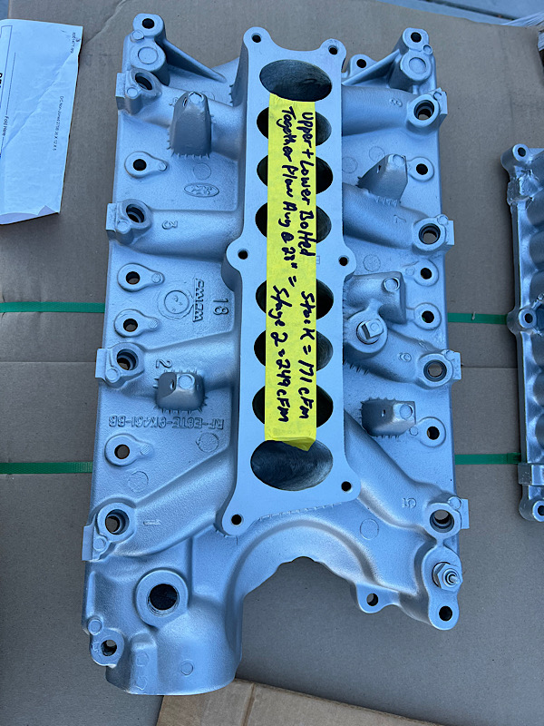

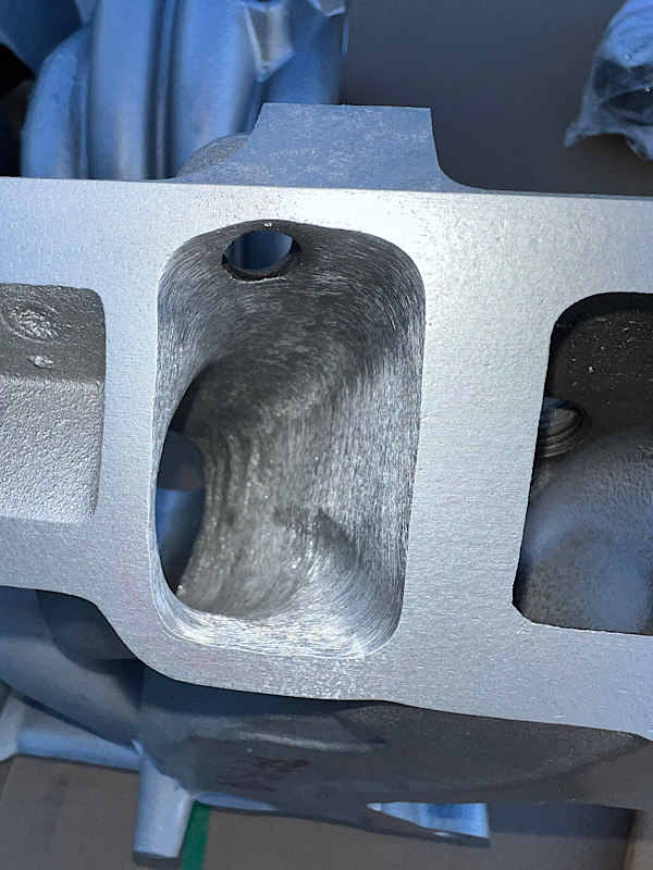

Next up… just received my ported intake manifold. Still waiting on the throttle body.

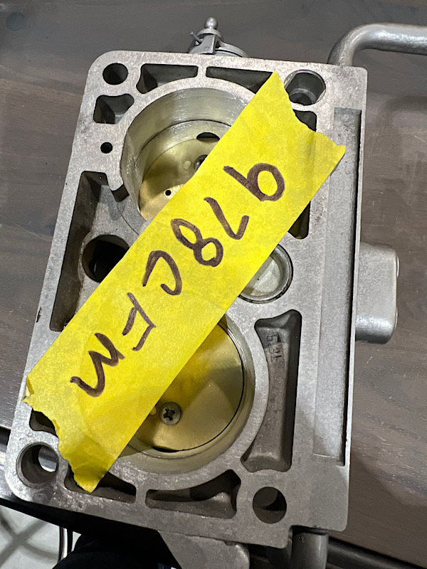

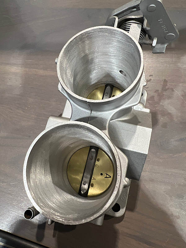

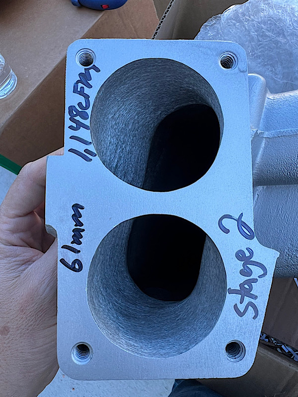

Throttle body came in today… parts are starting to accumulate for the engine rebuild!

Who did the massaging of the TB? Why not a BBK TB?

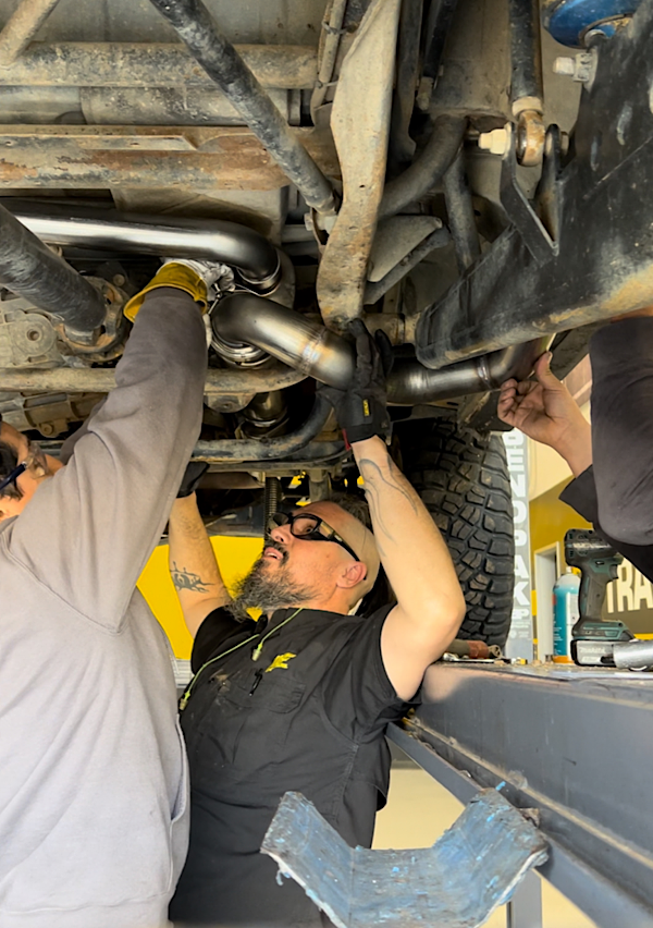

FWIW I put the correct 49 state (mine is originally a FL truck) Magnaflow cat system on the truck and I could not be happier. Granted I was working with a severely constipated exhaust system, but just changing to the Magnaflow feels like I gained 100 HP. This from an all stock engine with 231k on the odo. It is now 3.0" from the Y to the exit and all mandrel bends. I do have one little leak that I have yet to be able to track down. Only happens under load and lacking a chassis dyno I'm having a tough time simulating that in the driveway.

The guys that did the intake manifold porting also do throttle body so I figured it would be good to have it all matched. I’ve also not heard good things about aftermarket throttle bodies… I like stock, so it seemed like a win to me.
Regarding Magnaflow exhaust on Broncos… well, I just got back from a visit to them last night. They did a complete new system with two new cats and two new mufflers, one with their No Drone Technology. To say I’m impressed is a complete understatement. The exhaust was obnoxiously loud before and had a drone that you could feel in your eardrums.. not pleasant! The new system is quieter, looks WAY better, makes more power, engine runs smoother… so, so good!
We also got a tour of the facility and a history lesson. It turns out Magnaflow is a family owned business with tons of long-term employees… incredible facility with even better people. Between that, and seeing everything (raw materials, fitment, assembly) they put into their product, it makes me a huge fan. It’s dark out, but I’ll shoot some photos of the new exhaust and post later. Here’s a teaser ;)

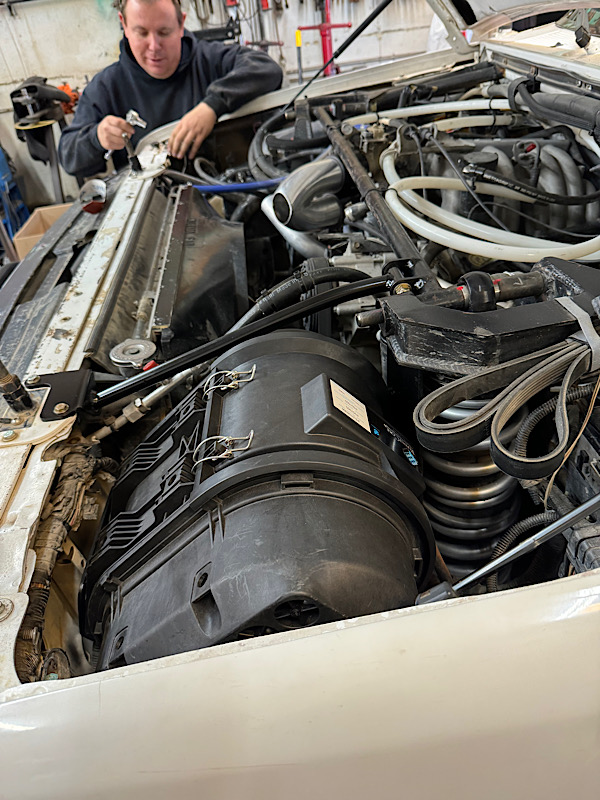

It started with a giant air cleaner....
And escalated to manual brakes!
Re: Rugged Radios Stretched Bronco - Factory Race Support, Tacos, and Coffee!
Did the porting ever get done on the intake Steve, or did that ever happen? The exhaust looks great. Why manual brakes?

At first I thought maybe it got in the way of the intake plumbing, but looking at the engine cage it's more in the way than the booster could ever be. FWIW Bill Wood once commented to me that those brake bias adjusters are the singular largest headache his tech people have and he'd discontinue them if he though he could.

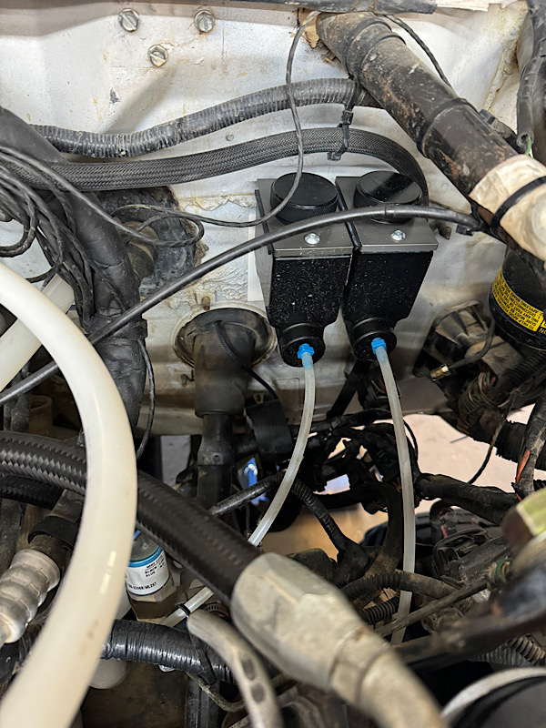

Must admit to being curious what the solenoid looking device on the frame rail is. The unit with the mostly obscured blue ano'd housing.

No worries! Yes. Porting is done and waiting for the new engine. Although, I'm tempted to install it on the current engine just to feel the difference.
The current system was a hotrod braking system that used an electric hydraulic pump for brake assist (power brakes). It's worked well for a long time, but the master cylinder has been bypassing occasionally for some time now. I was talking to Mark Newhan about the brakes on it some time ago and he suggested putting a giant brake pedal in it and going full manual. I'm a fan of the brake feel in manual brakes and he said with the additional leverage (from something like 6:1 to 16:1), there would be plenty of braking power. Plus, it frees up a lot of space under the hood... looking forward to that!
Good to know. I hadn't planned this brake change now, especially considering I a have a trip into Nevada next weekend, but it's started and I'm looking forward to putting it to bed! Fortunately, the shop doing the work says they're familiar with tuning these bias adjusters and said he'd set it "very close". Fingers crossed!
It's part of the hydraulic assist brake system that's being removed. Lincoln Continental part if I'm not mistaken.

When I was working for Bill my mentor there came up with a simple formula for manual brakes. The overall leverage ratio target is 95:1 when considering the front calipers only. It can drop as low as 93:1 before the pedal feel becomes too stiff for almost everyone, but it can range up to about 100:1 before nearly everyone will complain about the pedal feeling 'mushy.' The overall ratio is the hydraulic ratio times the mechanical (pedal) ratio. Based on that I'm assuming that the m/c bore size being used is rather large so that the m/c piston "take-up" stroke is short (lots of fluid volume for very little movement) and the really large pedal ratio keeps the pedal travel from being excessive. I'd have expected those two factors to zero each other out, but I'm gonna go off and play with an Excel file to see.......
Well, sir. You clearly have way more experience and insight on this topic... since I'm, fortunately, not doing the work, I'll either get it it and love it, or learn it. Either way, I'm excited to have this project started. It's been in the works for a long time.

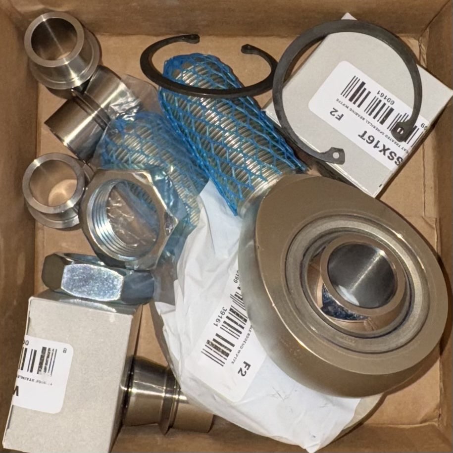

Parts gathering for the front end swap has begun....

What are you swapping in?

Finally, putting a arms on it!
