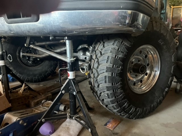

Setup my tie rods. I found out afterward i have 1.25 tube to sleeve since the 1.5 is .120 wall so ill remake the two long ones. Its close. Next will be the drivers bump then figuring out the guts ive flopped around in the engine bay. I picked up a cardone 20-7272 power steering pump. I figured 225k miles and 3 turns on 35s and it wouldve shit the bed. Also picked up a power steering cooler. All grade 8 hardware in the steering. 3/4” bolts all except the knuckles. 5/8” bolts with bronze oilite bushings just in case the knuckle ears take a beating. Its easier to replace a bushing than find an abs knuckle. Oh and ill be keeping the abs and putting it on a switch. All in all i only lost 1/8-1/4” of turn radius. Not bad. It cycles 12-13” travel but its clean and no stress to parts.

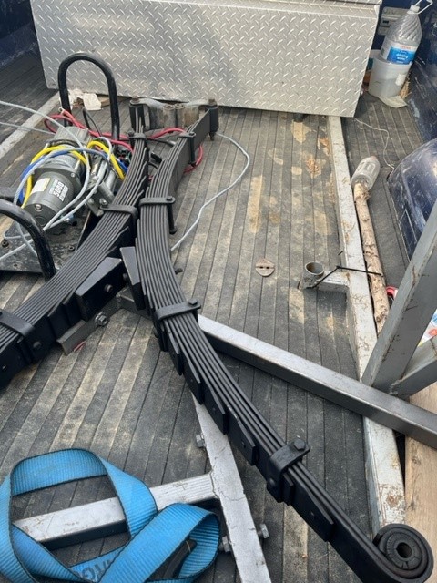

Again the girls' racing has taken time, but I have been quietly, slowly moving forward. I found a set of what was classified as Q80 springs, but I believe they are altered J40 springs. Either way for 600.00 I wasn't angry. Also, I finally got 2 tires and wheels mounted. I still enjoy the alcoas. I'm going to rough align it to verify tie rod length, then continue to reassemble the front. I have one bump can mount to finish, and random brackets for stuff like the intake tube, and the fuse box. Hoping to get started on that soon too. We are close to a two month break, so I am hoping to have the front end squared before the season restarts.

Woohoo! Got another day. Made the mount to hold the intake, finished the bump can for the drivers side and rough aligned it. I think im going to make another set of tie rods and sleeve them since its .120 wall tubing.

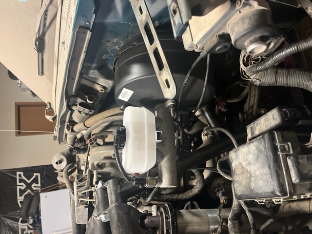

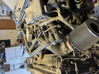

Okay finished a few more things. Upgraded power steering pump, new lines, cooler (not the stock one), and switched to the 1 ton booster and master. Im hoping to see good results and also help with a brake upgrade later. Also ran new brake lines on the driver side so they will run down the radius arm. I wore a hole in a nose once with extended lines.

Has anyone had experience with the t-bird calipers up front? I've heard decent results. I figure with the 1 ton rear cylinders and the t bird front calipers and the 1 ton mc / booster, I should have a decent amount of braking power.

I used them on my 96 build. Worked good except for weak parking brake.

Okay so those are the varga rear calipers you were talking about. That makes sense. I was referencing having to go to a pre 85 front spindle to run the larger 78 thunderbird calipers. Supposedly the piston is bigger. At that point wouldn't I need to go to the early 2000's master cylinder since it was disc / disc?

The T-Bird calipers won't fit on the TTB front knuckles afaik. The T-Bird caliper swap is for the 79-earlier trucks.
Yes, the piston is bigger than the ones on the pickups/Broncos.
They will with mods. You have to clearance the ear on the beam on some. You also have to run pre 85 knuckles which I am not going to do. I want to keep the abs in the truck and run it on a switch.
