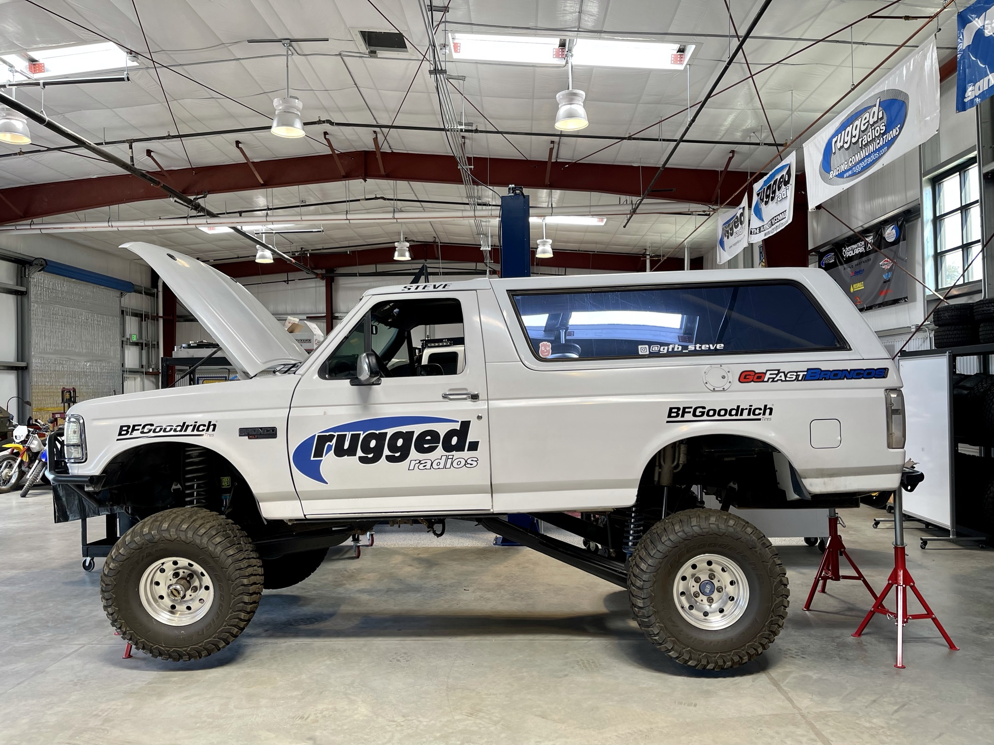

So I'm working on doing a better job of documenting things and stuff... people often ask about wheel travel numbers, droop versus bump travel.... Well, the truth is, these days, life is busy... family, work, and everything in between, means I don't usually think about that kind of stuff, but Broncos are a passion I love to share, so I'm working on it! Here's a full droop photo. I know I took measurements at the time of this photo but I couldn't locate them during a quick search. I'll either find them or measure again soon.
- 64495401950__A01F7C6A-5B13-48BE-B8C5-0B2E3C869816 (1).jpeg (961.05 KiB) Viewed 32552 times

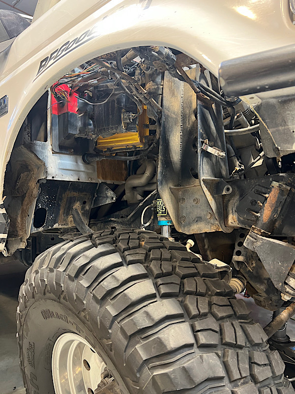

Pre-R2R shock rebuild (and video above)…
Shocks out… I like using the stock (but extended) inner fender-liners. They provide plenty of protection and remove in about 5 minutes… makes it way easier to get to things!
