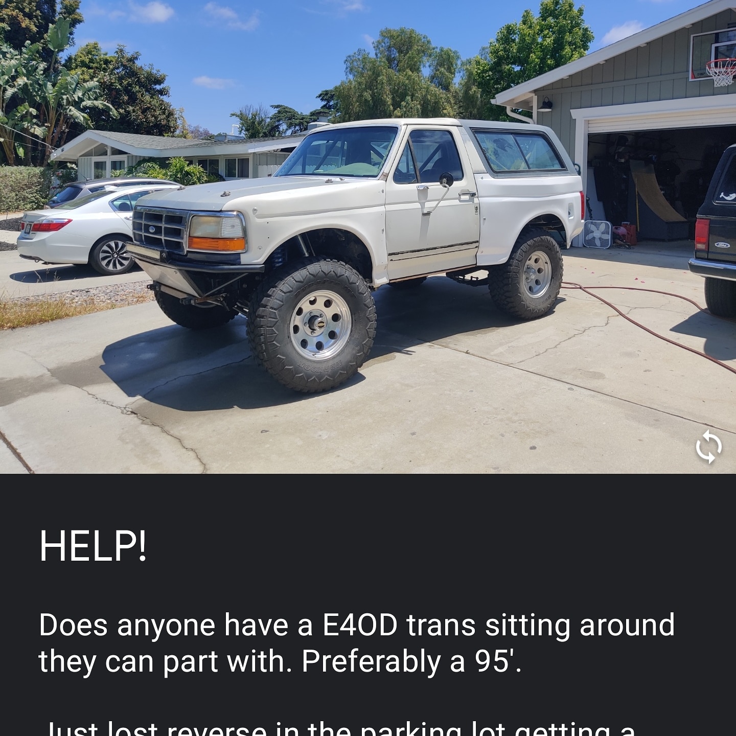

It's been far to long since I've been on here. Alot has happened. I moved a few times just deployed for 8 miserable (covid ruins everything) months but now I'm back.
So in typical fashion I geared up to get the bronco painted. Took it off non-op, got to the smog shop, passed woot woot, then destiny rears its ugly head...... Transmission grenaded on the way home. All forward gears toast.
Everytime I get close to painting this thing it finds a way to break so I can't pay to paint it.
Anyway I am seriously considering the 5 speed swap. Anyone who has done it please chime in on the pros and cons. Also, anyone looking for a Artcarr shifter, punisher valve body and a PWR cooler with all the lines and adapters for a e4od let me know.

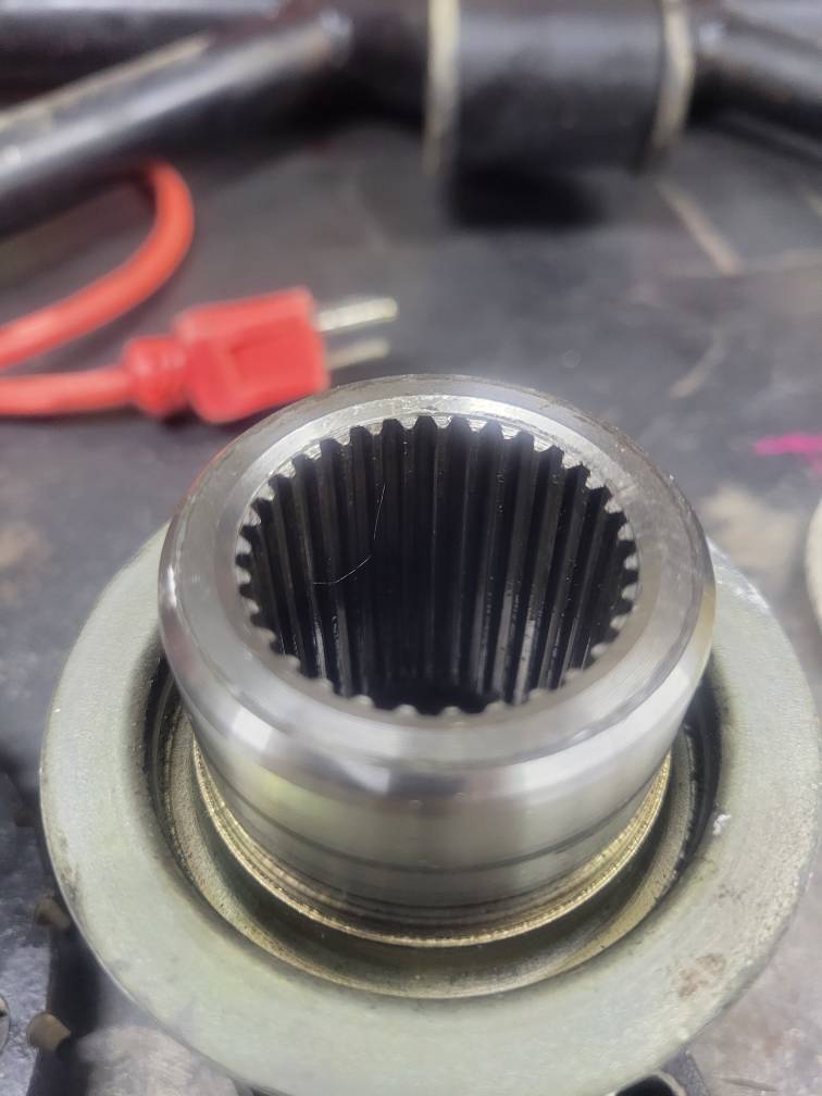

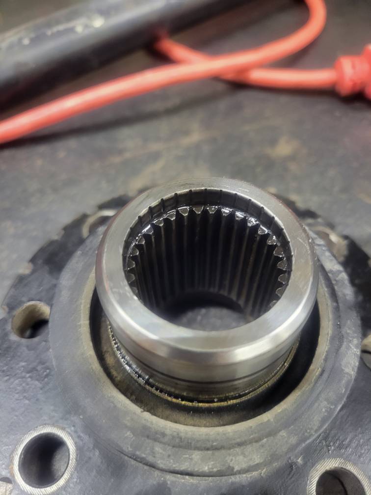

So I went to swap the VSS flange from my original Tcase onto the new manual shift one. Unfortunately they are slightly different sooooo... now I'll be taking apart both tcases to swap the output shift. FML
