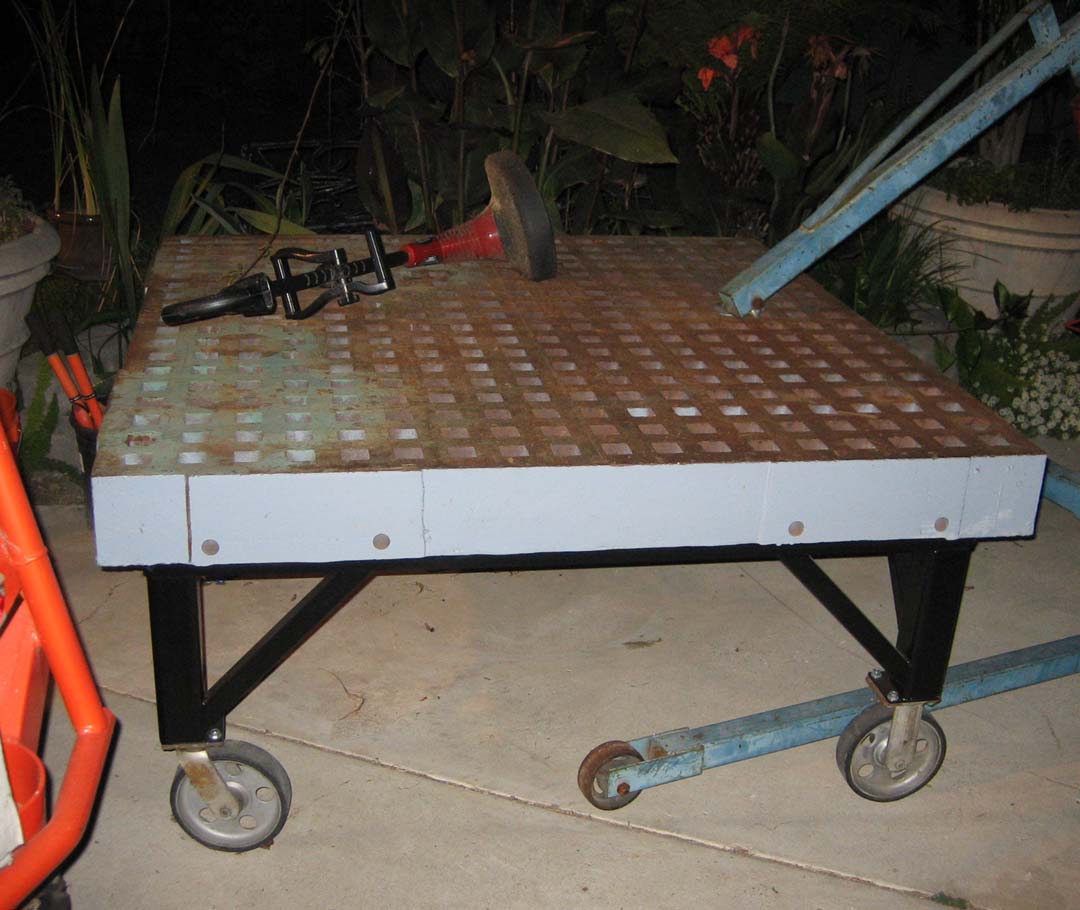

Yeah, no. But it needs done. Next is fitting the Mark Williams bearing caps. Hopefully that goes faster.
"Acorn Table"?
"Acorn Table"?
Re: "Blanc-Oh!", my distraction
Fixture table. Acorn is a brand name. Looked like one of these to me. This is my old one.
Ah, it is and it isn't. It is a fixture table, but it is a solid deck and was built by a master fabricator abut 35 years ago. The top surface is a 4'x12' sheet of 10ga. lightly tacked at the corners. Plan was we would lift a sports-racer or whatever on the hoist and blow off it's suspension. Roll the table under it and make fixturing that was tacked to the table and bolted to the chassis' suspension tabs. Then we could alter the chassis as needed without it moving. The idea was that when the top skin got too scared up from all of the stuff tacked to it and then ground loose that we'd buy a new sheet and turn the old one into tabs, brackets, etc. It only ever got used that way once, to build the world's most over-the-top wannaB street legal Class 5 car. I've only seen pics of it, no idea what became of the car. We had one like yours at CSU, Chico. That table was lusty....
I thought maybe you were seeing things in the pic that I couldn't. It is outside under a ginourmous & messy CA oak tree......

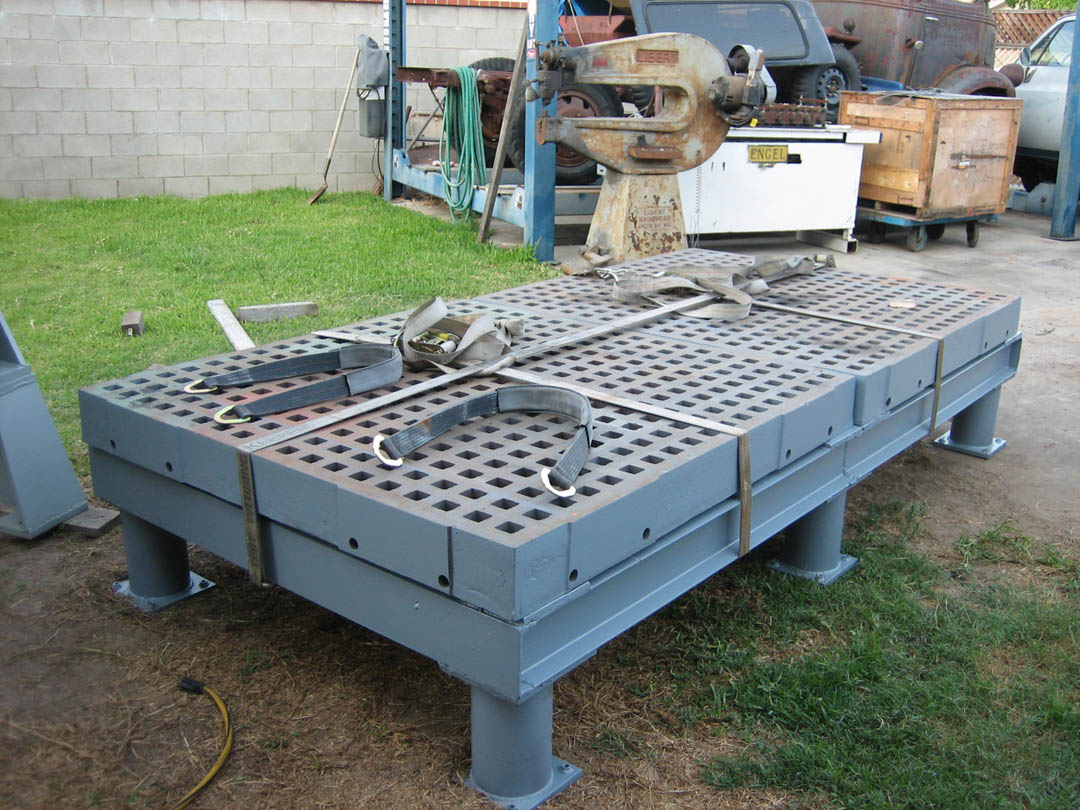

Yeah, not actual acorns. I saw where your mind went.
And I only had one of these tables and honestly I like the newer tables with holes or threaded holes better. The platens only work if you have the tooling for them. They were ok to clamp to but the new style stuff is way better.
My buddy has 6 of them though and can configure them into different shapes or layouts for big projects. He does everything from cars to 2" thick structural stuff that is HUGE.
I like the removable top idea. I lust over steel tables with a blanchard ground aluminum top. They get beat up but they dissipate heat so well.

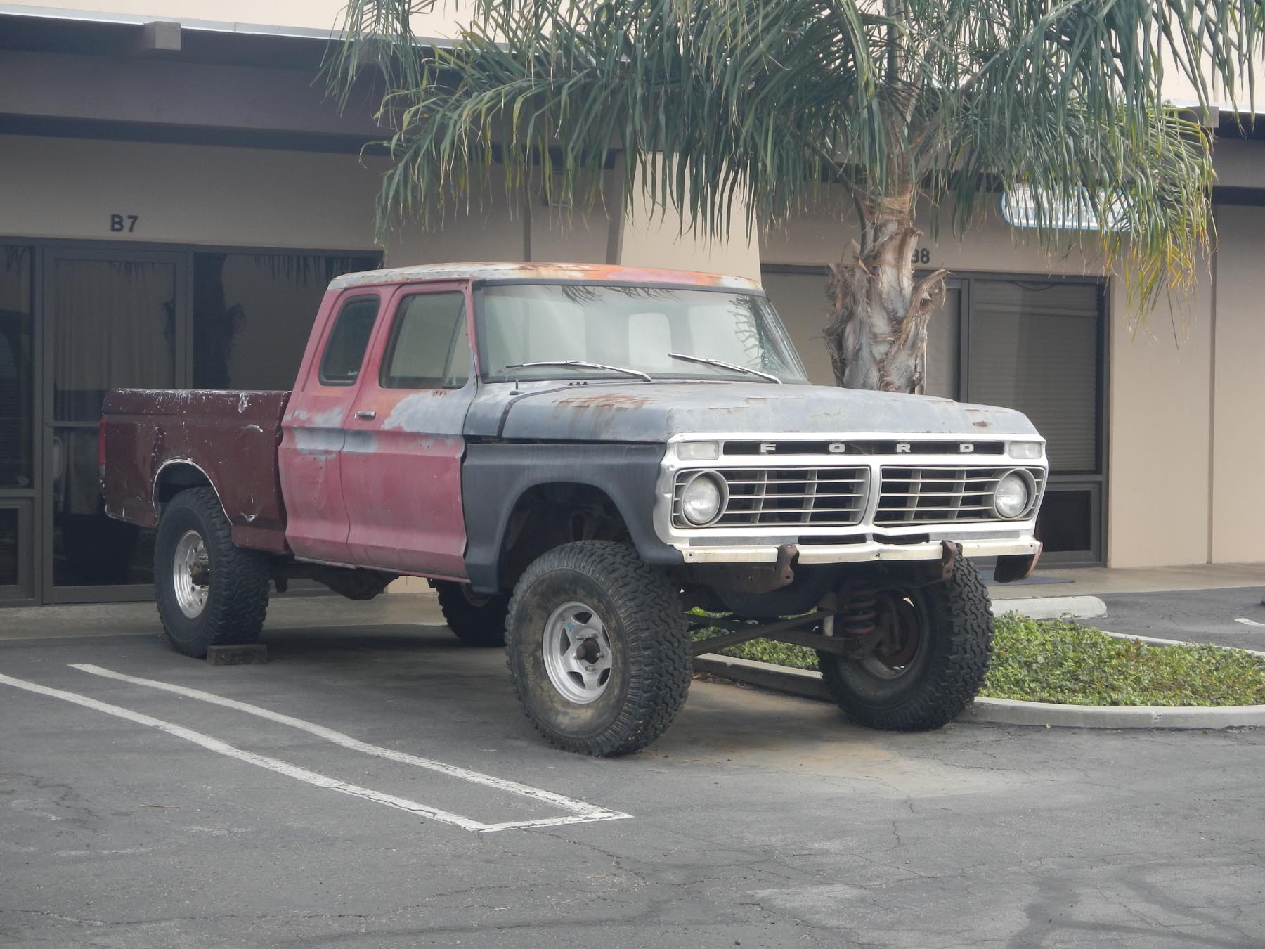

These are a set of 5, 15x7's I had for a while. They seem super rare. I still have a 16x7 in 5x5.5 of these up in the rafters. I LOVE the look of these but finally sold my 5 I'd been hoarding when I decided to take all trucks to 8 lug. Now I wish I had um back.
This 5 star pattern also came in an 8 lug but I think those were recalled.
