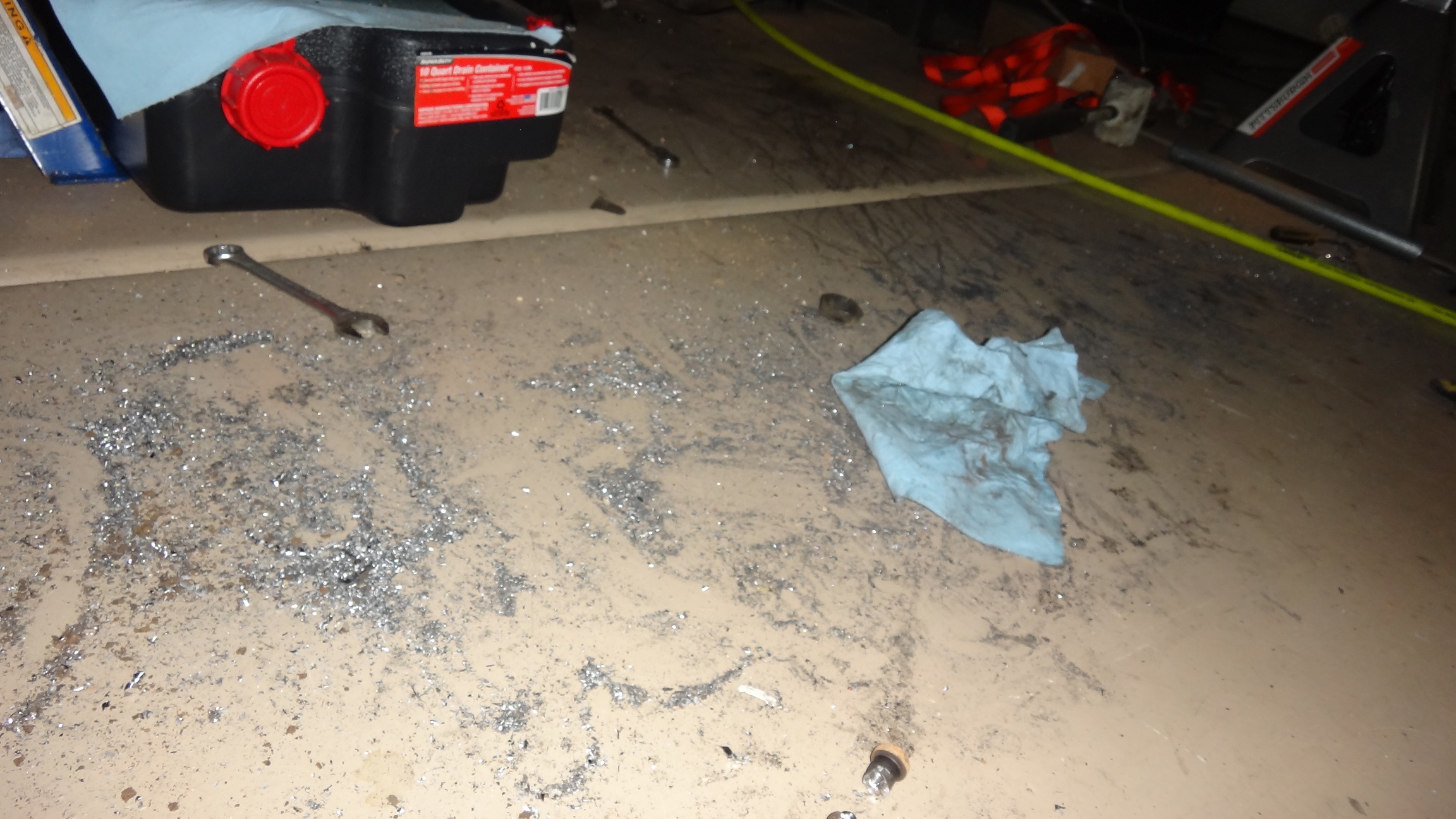

Re: Carly's 96
Yep rivets were a nightmare. This is just from the 8 rivets I had to knock out in the rear :\
Did you fab up your own hoops?

Re: Carly's 96
I also hate rivets. I've done more than I ever care to admit, and as much as I hate them I truly hope I will be doing more in the future. I hope I am because that means I'd be getting to work on trucks again!!
I have a jar in the garage with the heads of all the rivets I've taken off after I decided it would be fun to keep tabs on such a random piece of info. I'd probably done 50 or more rivets before I started keeping them & I've got a broncos worth in the jar...
I've drilled them, ground them, air chiseled them, etc. Any way you go at it it sucks! And it's LOUD!
You've got them out of the way now (aside from 1??) so that is good. That means you can get back to fun stuff!
It';s hard to see your markup on the ABS bracket as the pic is a bit small here, but I think I get the idea and that should work from my point of view.

Ugh. I've tried them all different ways. I cut the heads about 4 times with a cut off wheel then out comes the cold chisel and my trusty old bfh. I am in the process of making them. It's my first attempt so yeah you can tell.entity-unknown wrote:Yep rivets were a nightmare. This is just from the 8 rivets I had to knock out in the rear :\

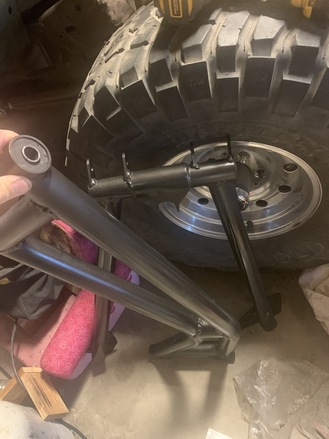

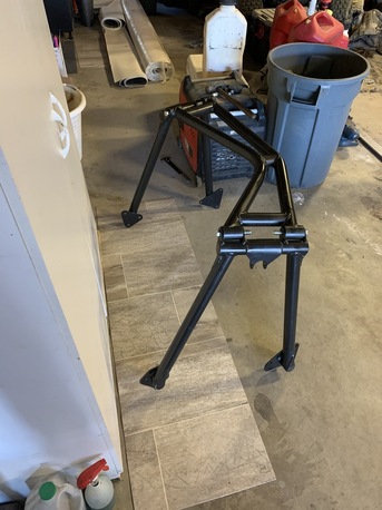

Been a minute, but the engine cage is done. Hopefully I'll be able to get the front bump mounts boogered up so reassembly can happen.

- Posts: 4680
Re: Carly's 96
Yeah some house projects came up and then we were considering buying a new bronco and sell this one, then the girls racing, put this on the back burner for 6-8 months unfortunately. It worked out for the best because I made some changes having time to think it over so all in all it’s coming along. Bump stop mounts for the front are next.
